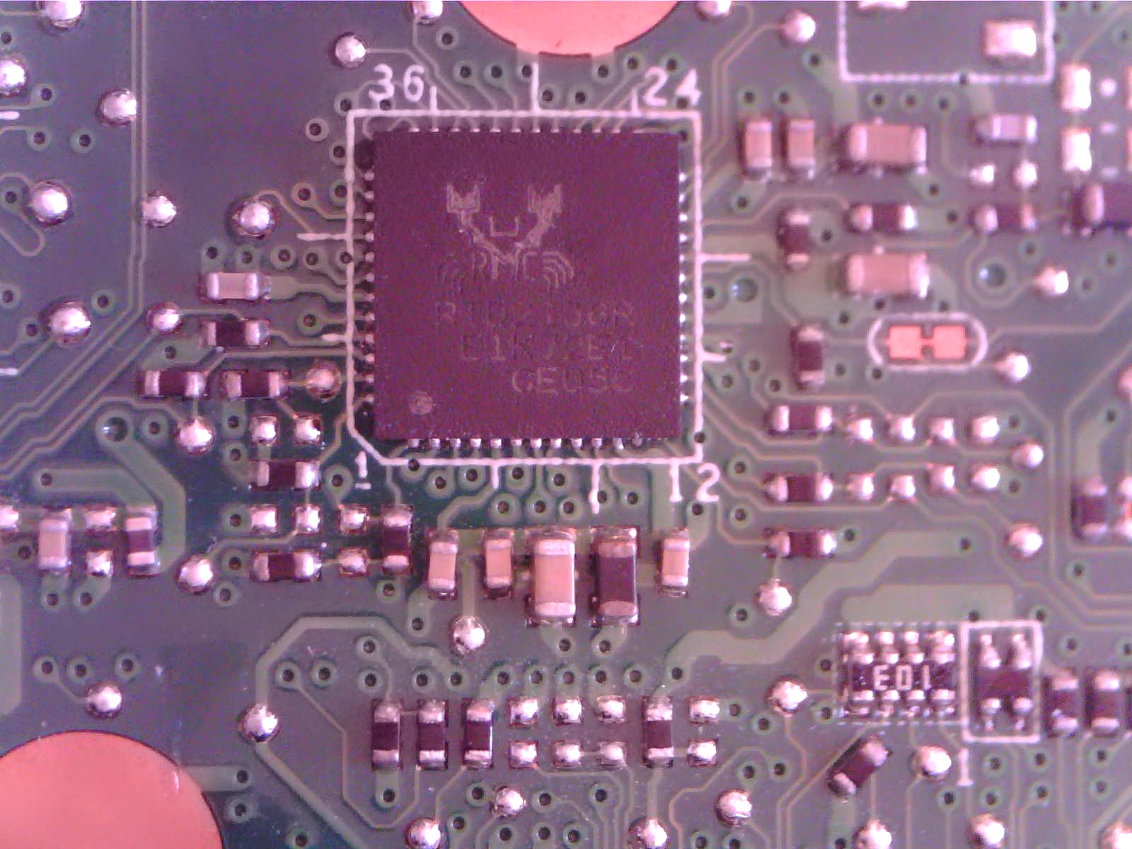

    Like the title says:
    I have a asus r751l
    motherboard : X750LN REV.2
    First pc wasn't booting, after flashing the bios with dump found on the web, it's now booting, everything works, except the internal display and the hdmi,with vga all works 100%.
    Please help guys

              Re: Asus R751L HDMI and Internal lcd Black, VGA out OK
              could be LVDS translator issue, did you see Realtek RTD213x series QFN32 or QFN48?
              • passete
                Living=Sharing
                • Jun 2015
                • 487
                • France
                You mean this chip ?
                I can't read the reference.
                  Yes!
                  maybe that IC was bad.
                  https://cdn.badcaps-static.com/pdfs/...cbc54b8c8e.pdf
                  see P.25

                    Can you please tell me which pin do i need to measure ?
                    Thanks buddy
                    • meritosari
                      • Oct 2010
                      • 774
                      • Indonesia
                      check pin 22,18,5,17,15,43,11.
                      then check pin 20 should be 3v
                        0,80then check pin 20 should be 3v
                        Ok, i will check this !
                        Is this chip good in case of replacement :
                        http://www.ebay.fr/itm/281741074136?...%3AMEBIDX%3AIT
                        EDIT: on
                        Pin 20 i have 0,89 Volts
                        Pin 11 - 0,55V
                        PIN 5 - 3,35 V
                        Pin 22 - 3,34V
                        Pin 43 - 0,54 V
                        The others i can't measure without creating a short.
                          Do need to replace this chip or there is nothing wrong it ?
                          @meritosari
