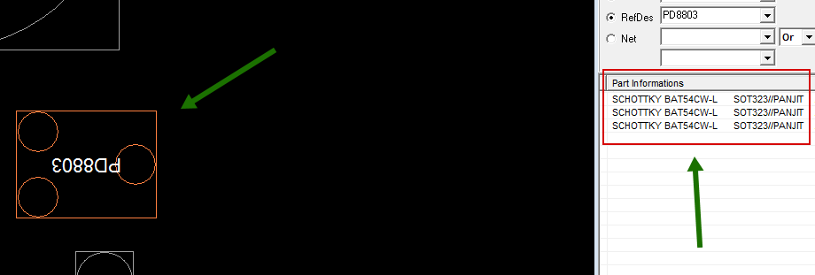

    I made a mistake when dismantling the laptop in question.
    I have removed and lost a component (a transistor think) :S.
    Anyone know, how can I do to get back to the part number?
    I tried to open the boardview with tsict, but without success
    This is the component selected from TSIC
    Thank you!
    Re: Asus K53SD - TSIC wich component it is?
    schottky bat54cw-l
      Thanks so much!
      I was going crazy to be able to find it.
      I had never had to replace a component and I did not know where I could find it.
      So, I think TSIC not gain this type of information, right?
        yes - provided that no BOM file
