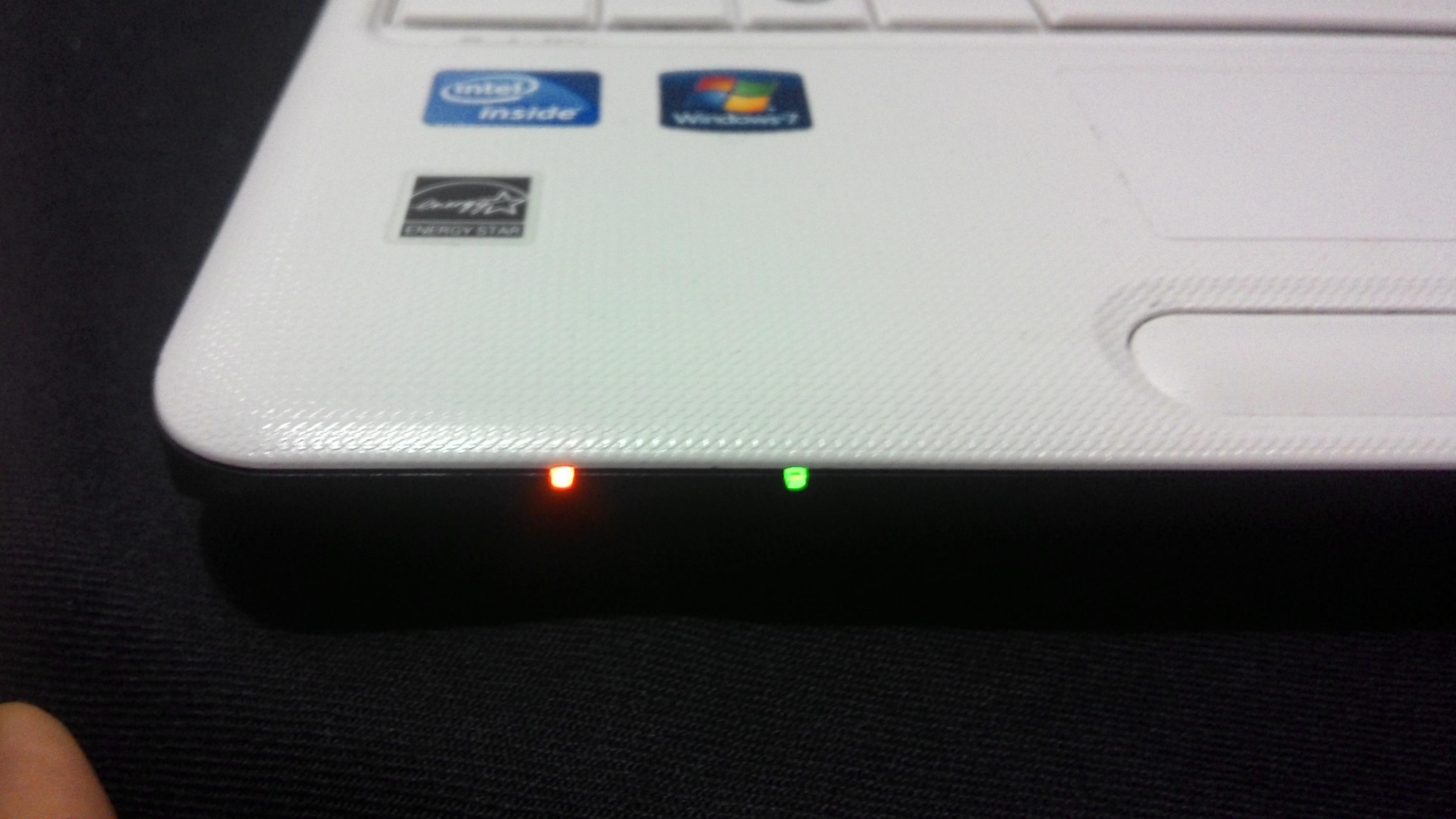

      Yes when I plug in AC Power on my laptop I can see green lamp. When I insert battery that lamp becomes red.
      Now I can press power button and second green lamp will be light as shown on first picture. In same time CPU Fan start rotate. After 3-4 second CPU fan stop rotate but second green lamp stay ON. CPU and graphic chip work because after 1-2 min metal on these chips becomes warm.

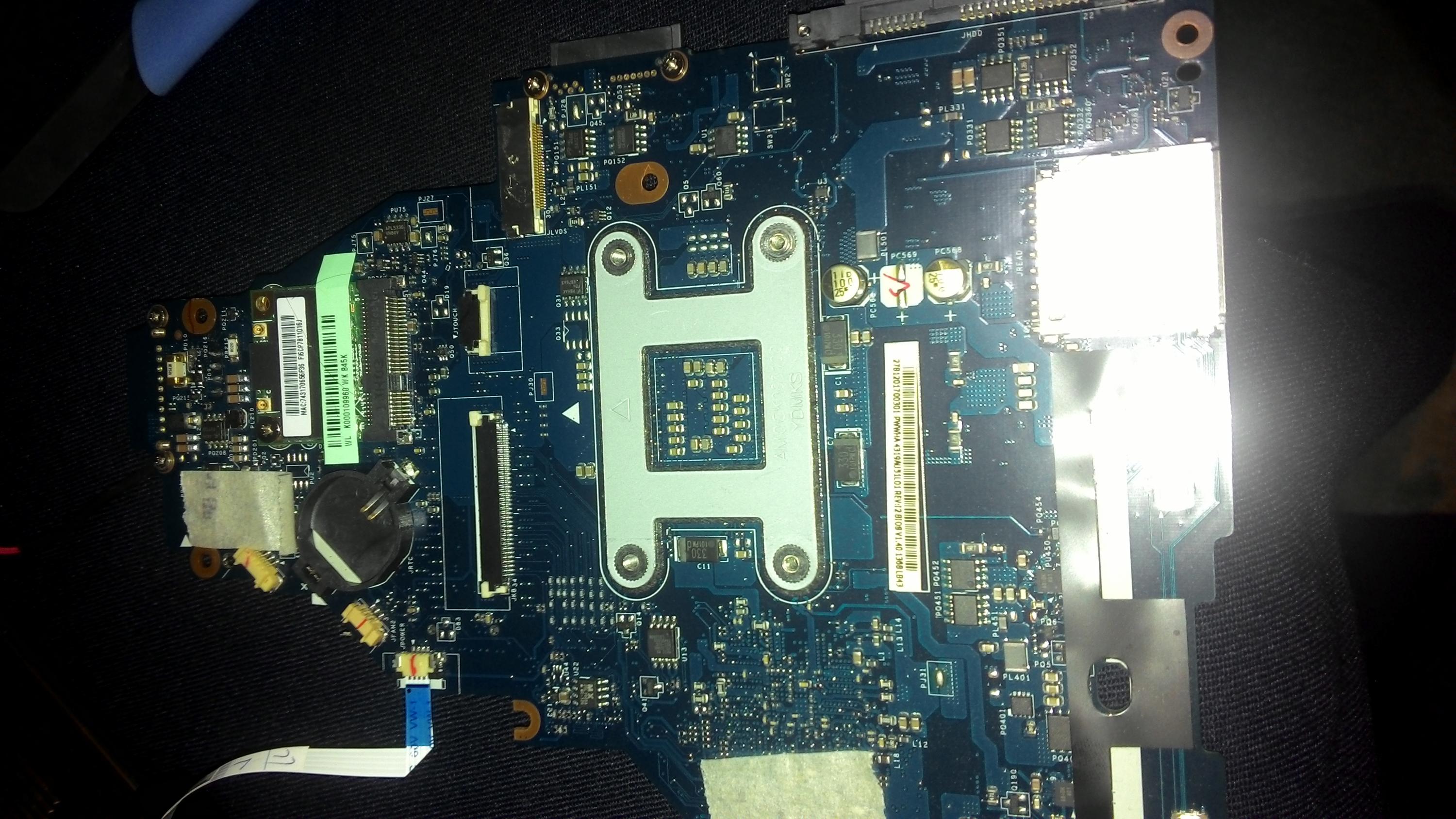

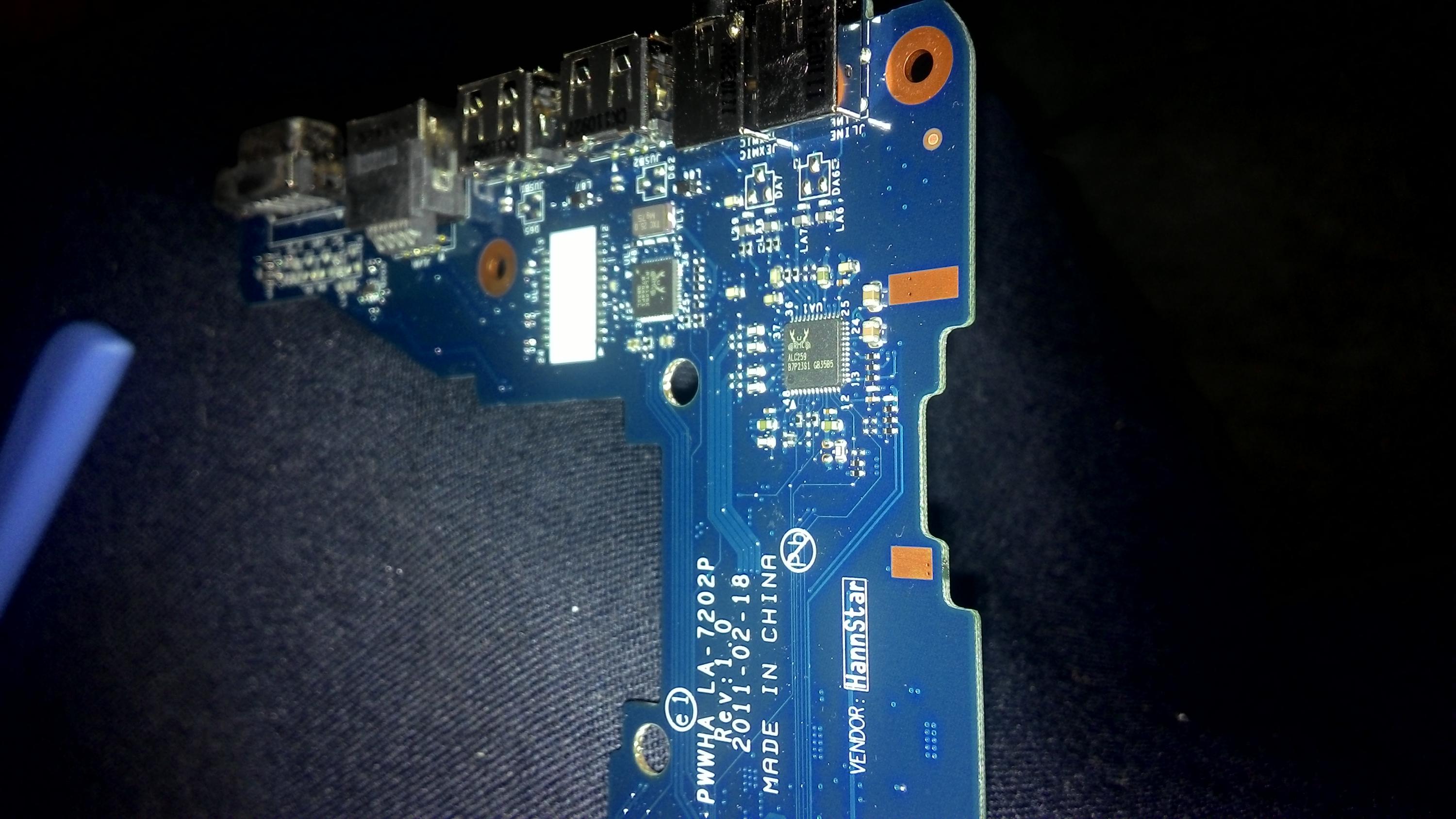

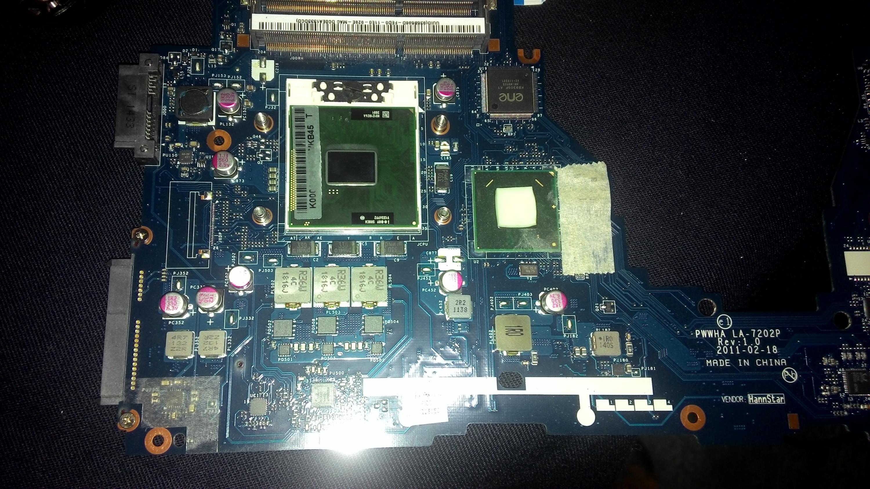

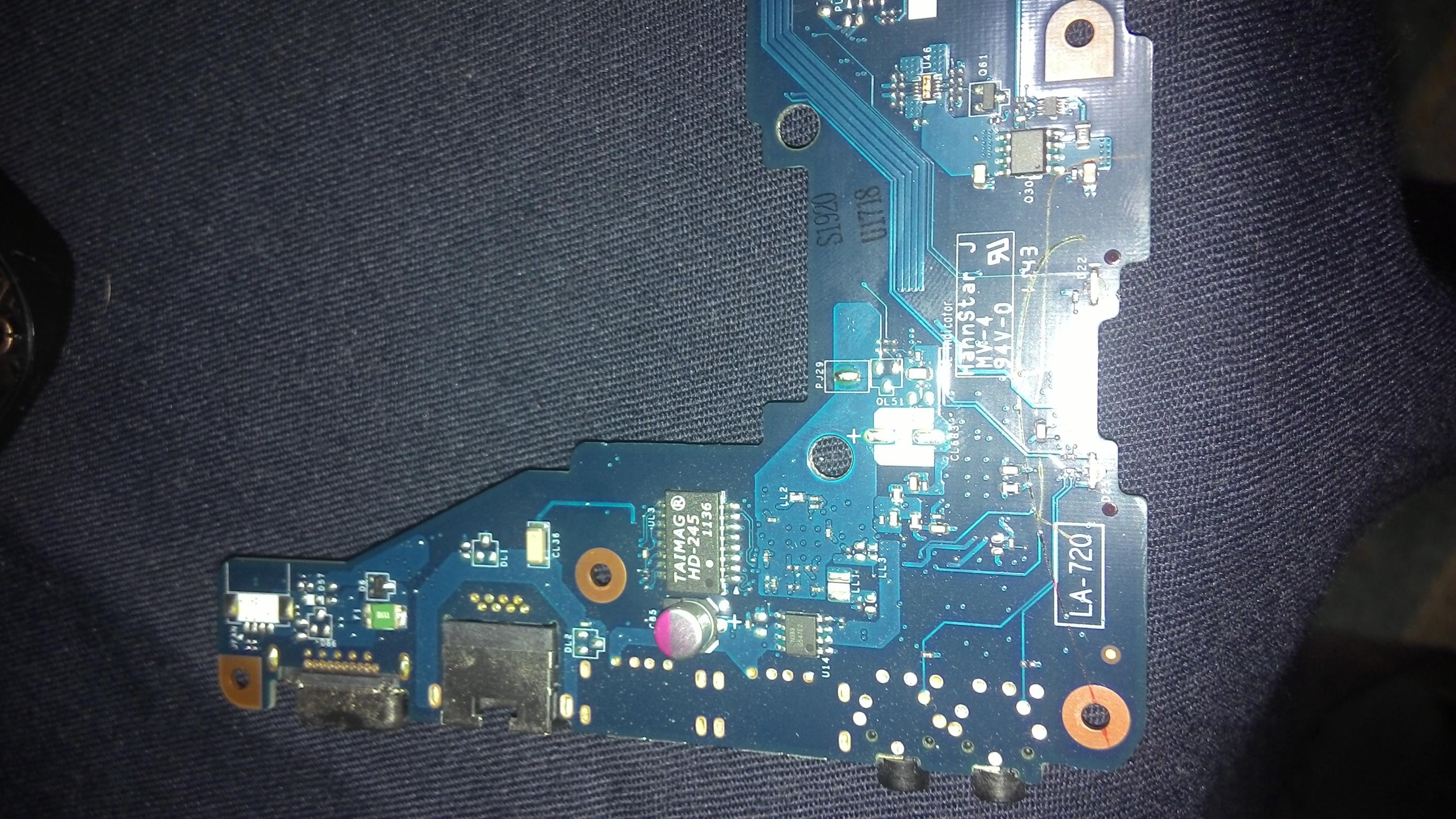

      I open laptop and make several image. This board is very clean and I can't see any damage. I clean thermal paste from CPU and put new Arctic Cooling MX-4.
      After I press the power button and hold then find the RTC battery and take it out. I try this several time but not without success.
      I post image of board and if you have suggestion tell me.
      Friend I have only multi-meter but not Oscilloscope. Do you have schematics for this board? And where I can find?
      I will measure Voltage on all elements what you say.

          And now when I clean and made one unit, when I press power button CPU Fan start rotation and second green lamp will be light as shown on first picture. Now after 3-4 seconds CPU fan stop rotate and second green lamp turn OFF.

                First LED is indicator for battery, Second LED is light when Laptop is turn on. Sir I don't have User Manual for this Laptop. I buy him from my friend.
                Now after 3-4s Fan and Second LED lamp turn OFF.

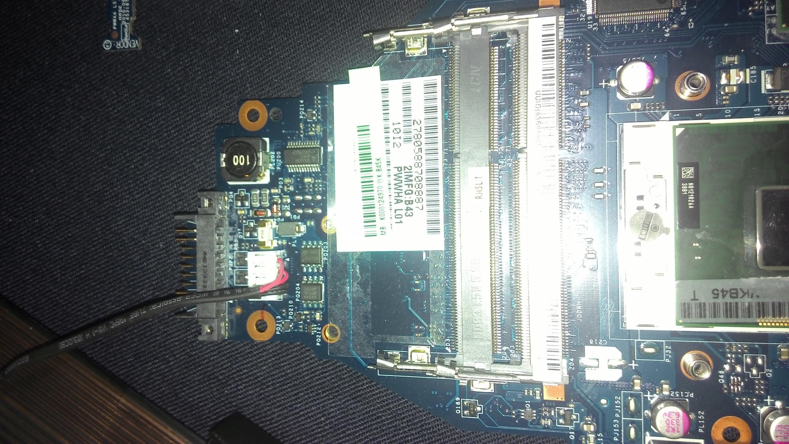

                          Now I again open this laptop and only stay Motherboard with RAM, CPU, CPU FAN and power button. All other components I remove from board.
                          on that motherboard I put in AC adapter and again after 3-4 sec same problem. I measure Voltage on board when I press power button.
                          In first 4sec I have Voltage on some pins where flat cable insert. After 4 sec I lost Voltages on board...
                          I'm sure I'm well connected all components.

                            Is the schematic you posted in post #3 the correct schematic for this computer?
                            One other thing when you tried changing the display from internal to external you said that you pressed F5. I had made a mistake in post 2 and corrected it in post 6. There are two key that need to be pressed together they are the Fn plus the F5 keys.
                            If the schematic is correct then go to page 4 there is a power rail truth table. You can look for those conditions. Also, TPS51125ARGER chip look for power good pin 23. Page three has the power tree on it which will give you a good way of tracking down which voltage you are getting and to which places.
                            You will need to look around to see what voltages you are getting and where you are getting them. Some condition is turning off your laptop. We just need to find out where.
                            Also check that the modifications are in place. page 42

                              Can you help me about searching real schematic. On my board I have LA-7202P REV 1.0 Image 3 in post #3. I search on google "LA-7202P REV 1.0" and got this results:
                              I had no success in searching TPS51125ARGER
