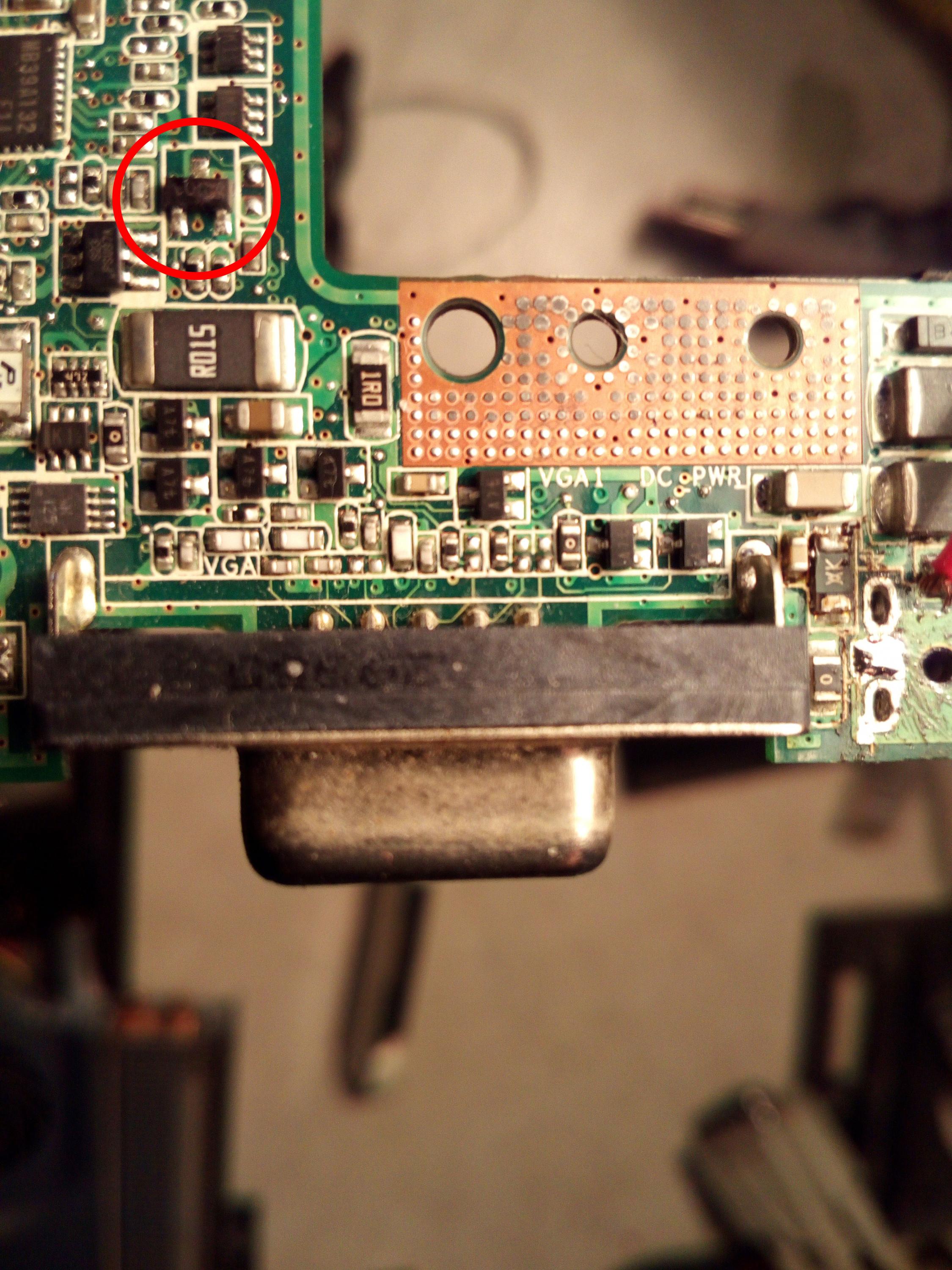

    Hello all,
    I have a 1005HA netbook which doesnt power on at all.
    I found this blown component but I couldnt identify it.
    If someone could tell me what this is or if I can bypass it .
    I found schemtics for version 1.1 mine is 1.3

    As far as my memory goes,that's a SMD transistor,which can't be bypassed.

      Can you identify the component from schematics because I can't read it from the top of the transistor.
        Can't read either,the picture is blurry in that zone.

          There is no way to read it from the picture. The component is badly damaged. I show it with microscope and I couldnt read it.
          The only way is from the schematics.
          I think the transistor is 2n7002

            Re: Asus EeePC 1005HA blown component
            It is PQ50 on the board view ref 1.3
            and it seem to be a the same for 1.1 motherboard
            Ref is PMBS3906 PNP transistor
