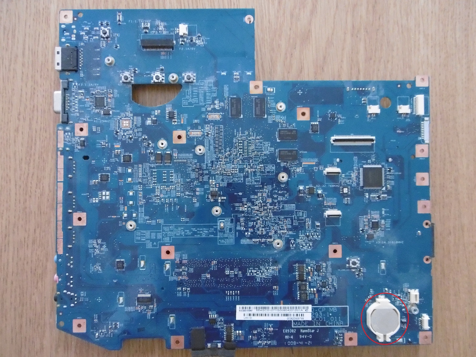

    My laptop shuted down while restarting Windows. Since, it is impossible to start it.
    Curiously, when I plug the adapter, the is no LED ligths (Photo 2).
    My adapter is OK. I tried to press POWER 1 min before plugging the adapter and press POWER but nothing happened.
    I also reseted the bios removing the CMOS battery (Photo 1). Always nothing.
    So, I think the problem is deeper in the motherboard.So I found the schematic (joined to this message).

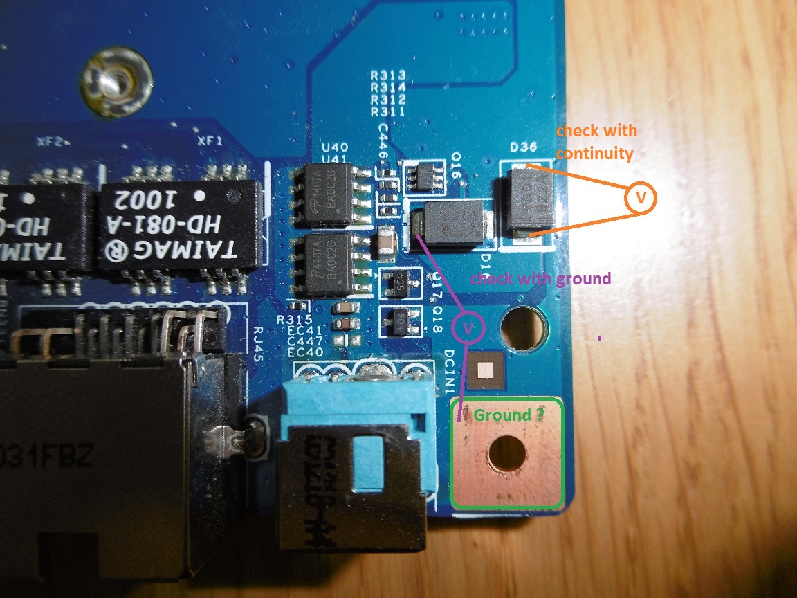

    check d36 and d16.
    check with continuity with ground and see if they beep.
    if one beeps take it out and you`re good to go

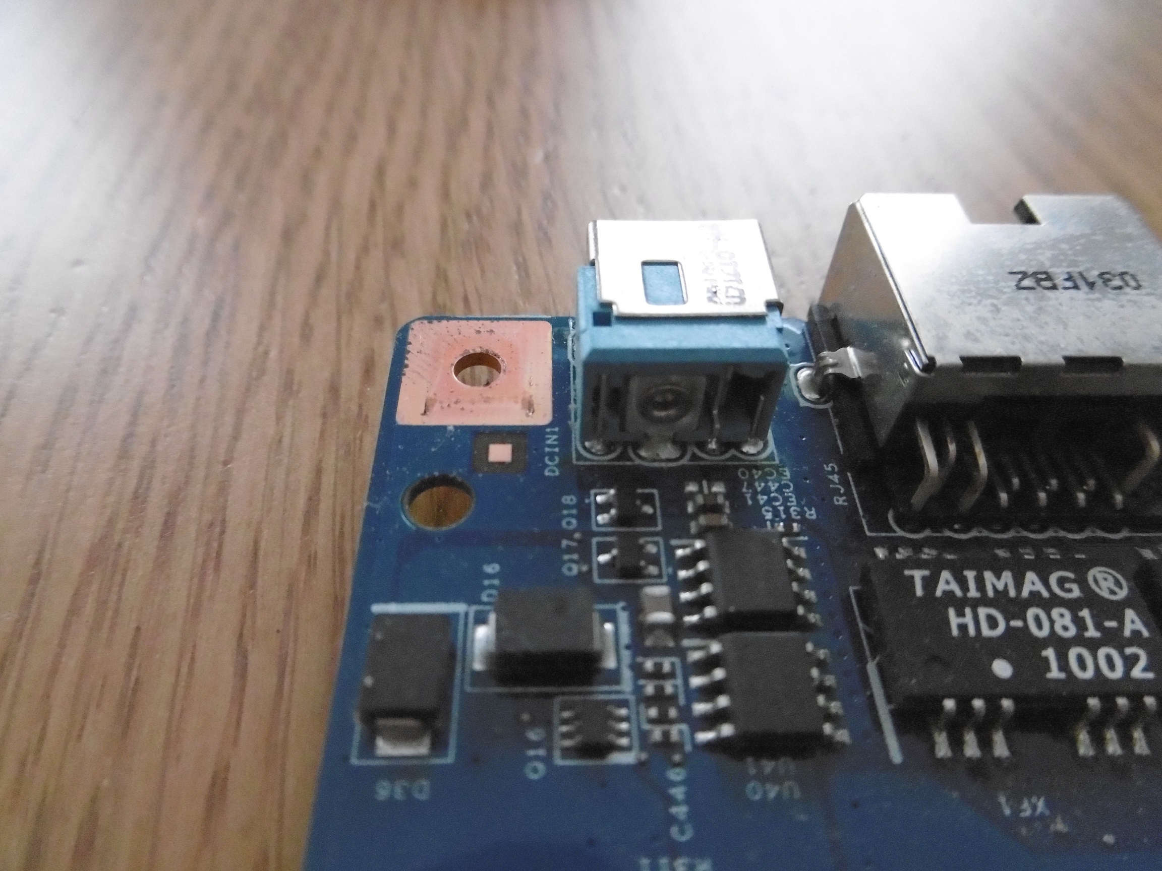

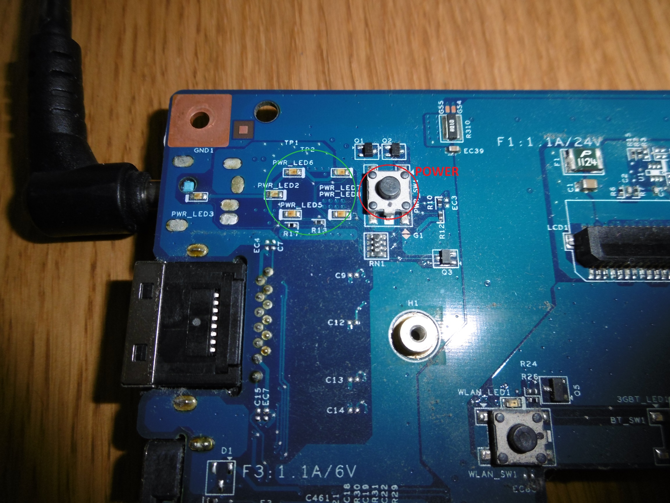

        Ok, it was easy to find them. Look at photo 4. Did I understand you?
        One other question, what do you mean when you say "if they beep"? The multimeter will beep?

            Re: Acer Aspire 7740G dead (no power - no lights)
            you place the black probe on ground and red one on each side of the diodes.
            if one one of them beeps on both sides the its shorted to ground.
            it creates a continuity to ground and force the whole voltage to go to the ground.
            does the adapter blinks or goes out?

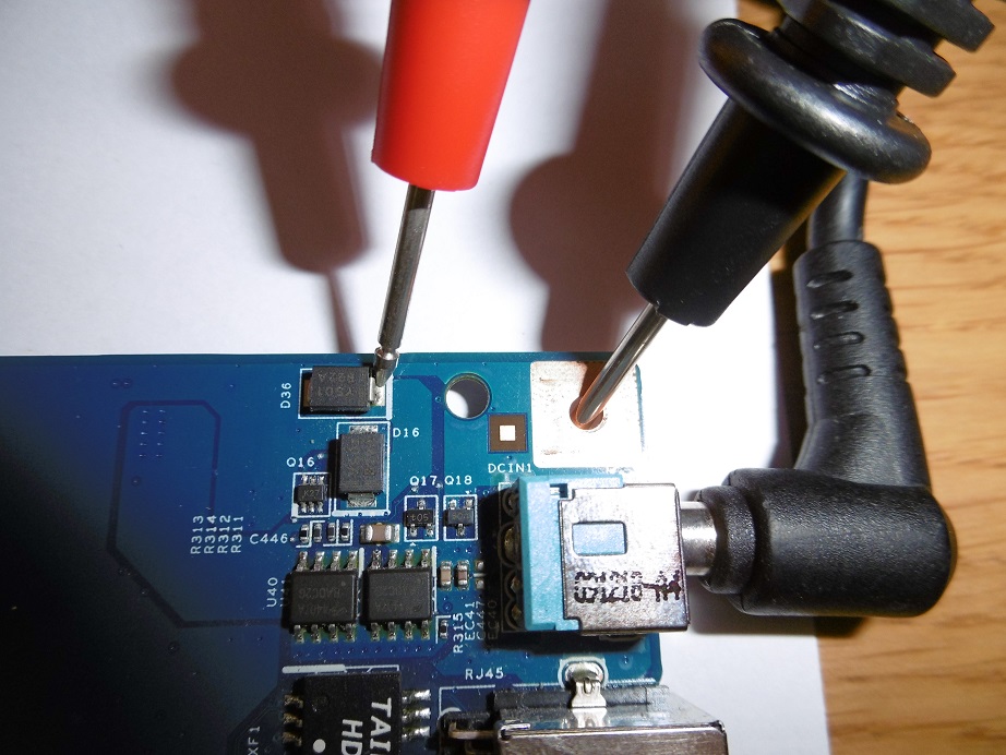

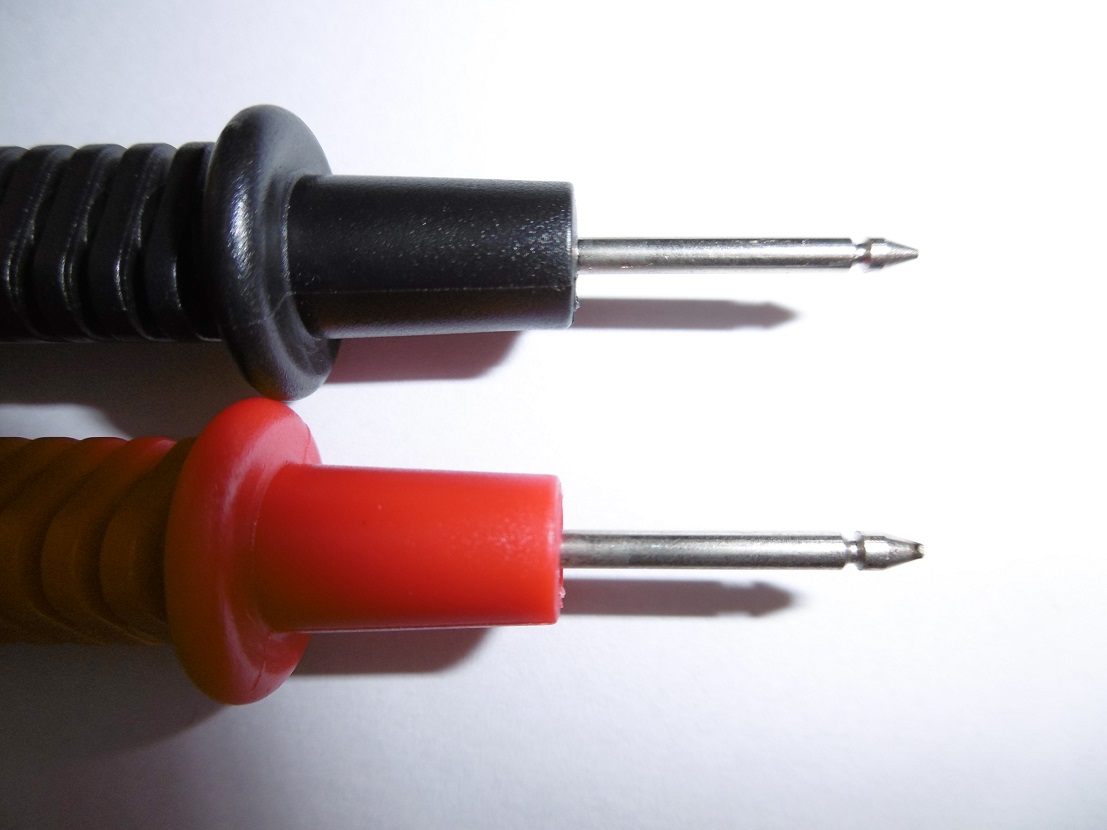

              I am a bit scared. I followed your insturctions. When I placed the red probe on one side of d36 (Photo 5), i heard a small popping sound. Since, ma red probe is grilled (Photo 6).
              ... I was supposed to do that without power?
              And now, what to do?
