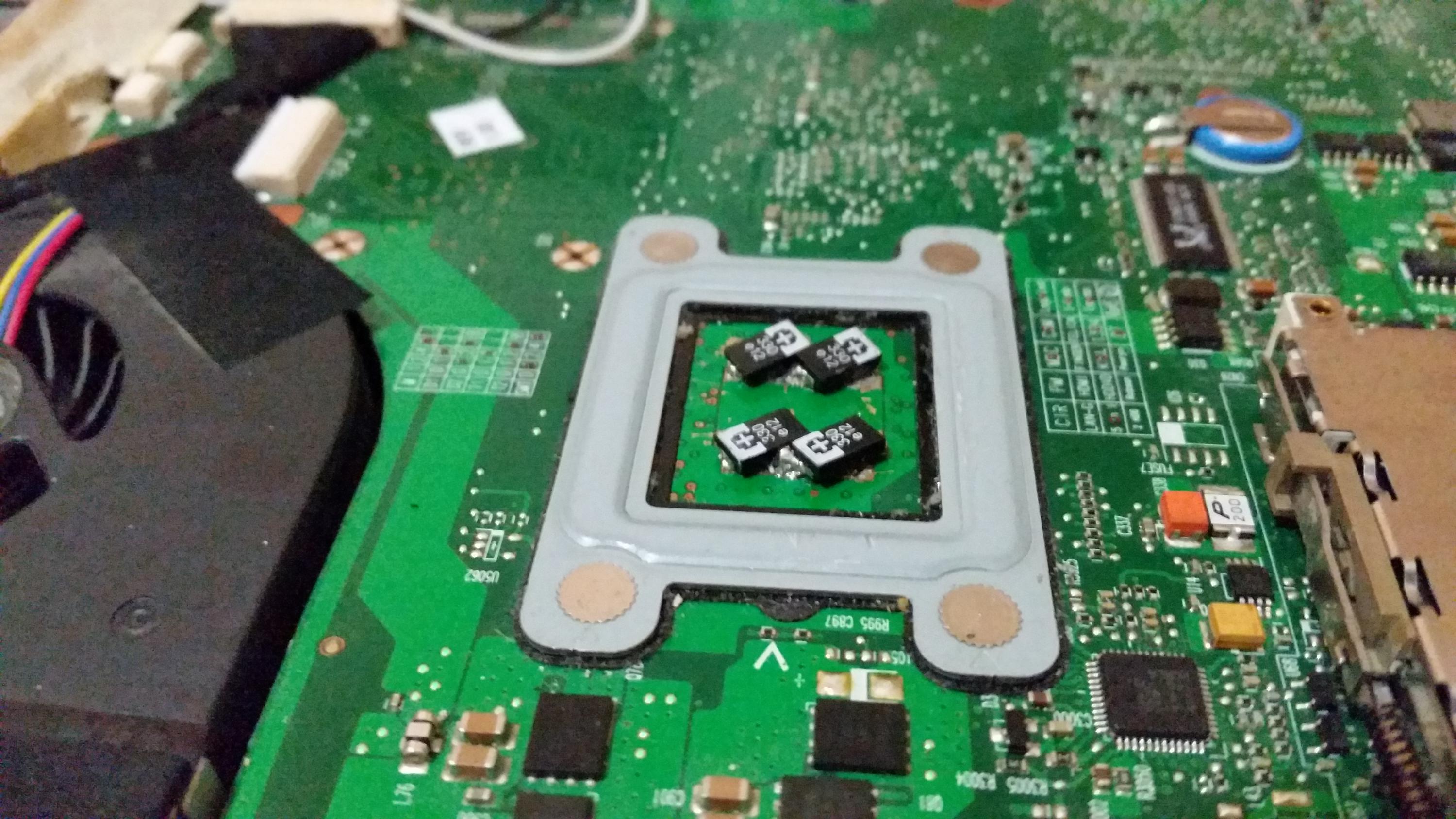

                        Today i got time to replace my toshiba A300 nec\tokin cap with 4 330uF 2.5V.
                        I solder the + of the cap to the outer line and the - to the inner line and i putted back every thing and...... BOOOOOM NOTHING HAPPENED.
                        At first it did power up but without display and after a min i powered off the laptop and now it wont power on and with no LEDS
                        WHAT DID I DO WRONG!!!!!!!

                          post pictures of your work...

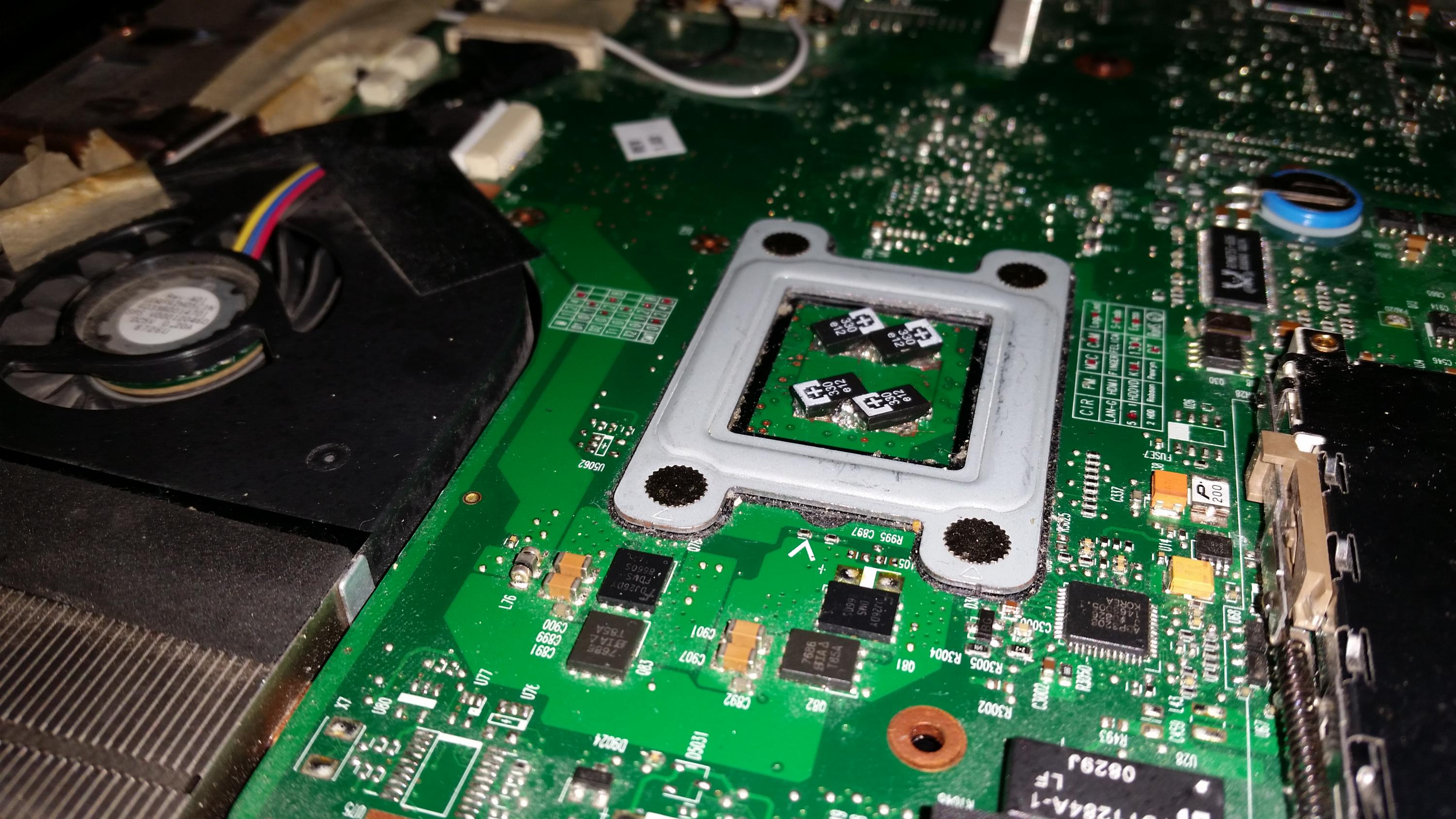

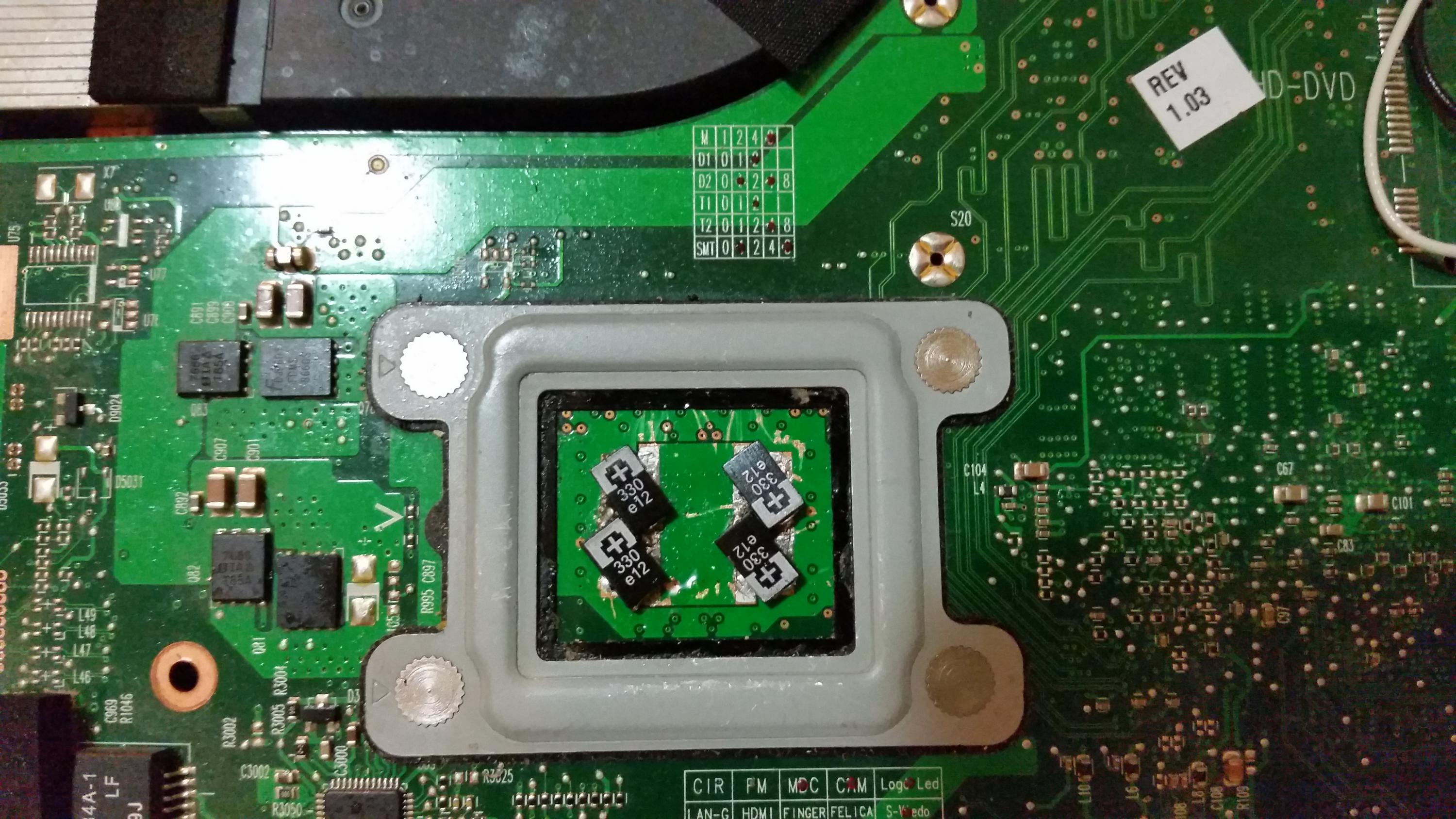

                              Re: Toshiba A300 sudden shotdown/restart
                              Here some pics
                              And i saw that i shorten the second down left cap😢 and i got it out and checked it ohm and diod mode and nothing is showing, checked ohm on MB and the inner line shows 0.4ohm and outer 6.8ohm. So there is hope for me?

                                Predator can be a bad cap ?
                                Try to change the caps again...

                                  but i probably shorten the caps. so still i need to try another caps?
                                    If it was me I tried with other caps.
