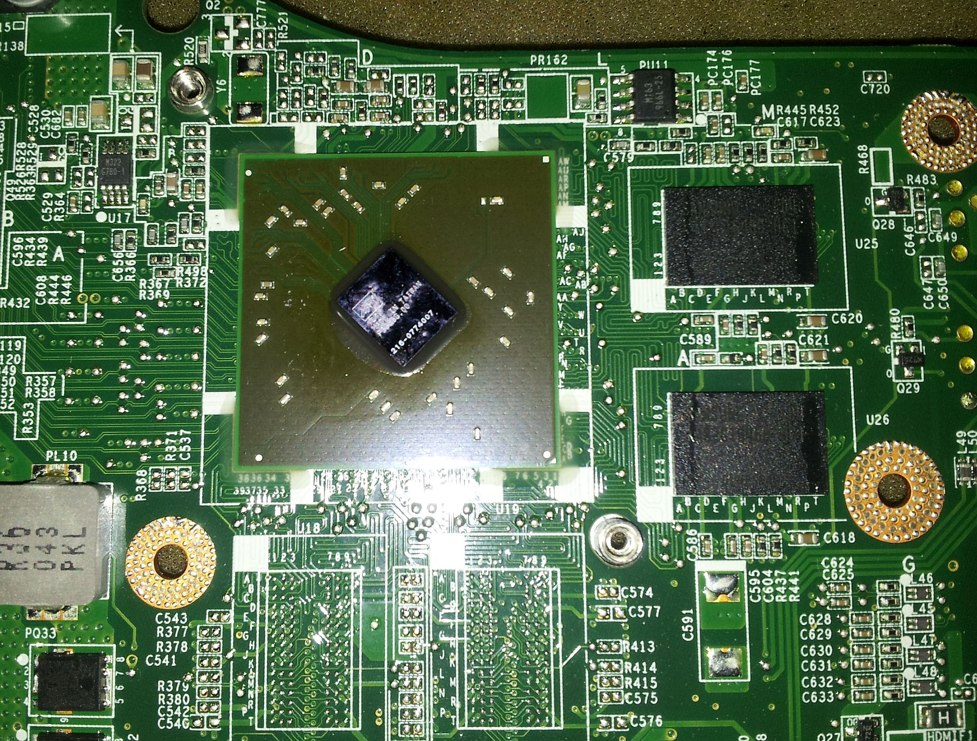

    If someone can help me with a good photo of the components around video chip,they got blown away on working station.I dont seem to find a clear photo .Thanks mates. The mobo is http://www.aliexpress.com/item-img/F...67249936.html#.
    P.S. The link is only for the photo info,i hope is ok to post it but im on a hurry.

    I have one in the shop that i should work on tomorrow. I'll take a picture of it.

      I would highly appreciate that mate,thank you a lot.

        Let me know if this helps.

          Tomorrow i will have acces to the mobo but i can tell you by now that your awesome,im sure this is it, i needed just one more piece of the puzzle and you helped me a lot.Thank you again,i hope i can return the favor.

            No problem. If you need any part values let me know as this board will be sitting here a while longer. It came in for no video but also had both audio jacks broken and wanted them fixed as well.
            I have reballed the GPU and replaced the jacks but the switch for the microphone jack works in reverse - it sees it as plugged in when it is not and vice versa, so i'll have to find another one that has the correct switch.

              Thanks again mate,works perfect,reball gpu.
