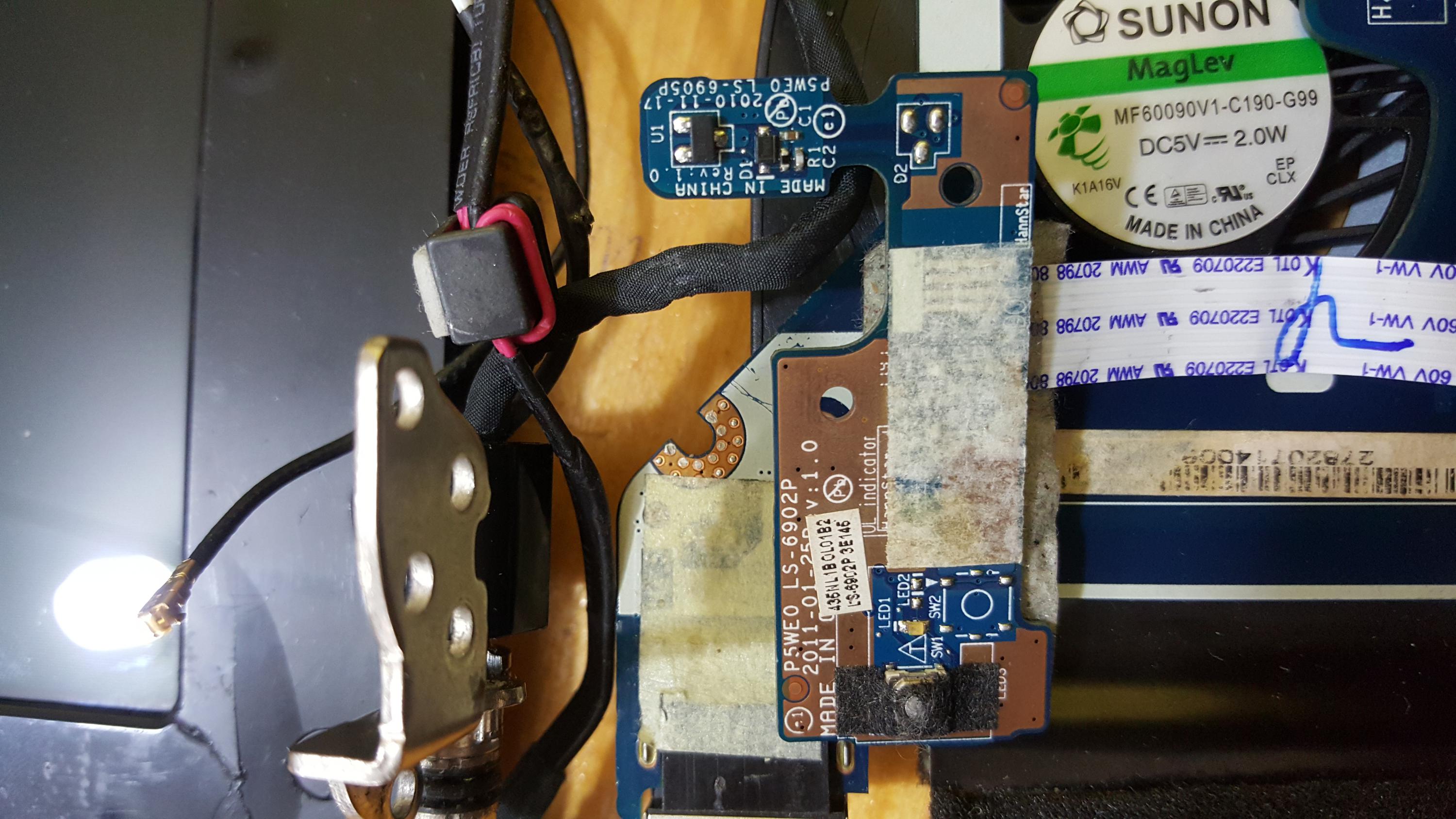

                find lid sensor on your laptop.
                If you found it, please provide an image of the sensor and say where it is connected to.

                  please provide an image of the power button board.
                  by the way, remove the injection into pin7 of JLVDS1, because you don't need it anymore.

                      EDIT: I think the lid switch sensor is on the power board because I could see a small block of magnet behind the LCD bezel below near the left hinge, the same place the power board is.

                                          I was suspecting the LID switch but now I have confirmed that the LID switch is functional as when right now I have assembled the laptop and when I close the lid the laptop goes in sleep mode almost immediately.
