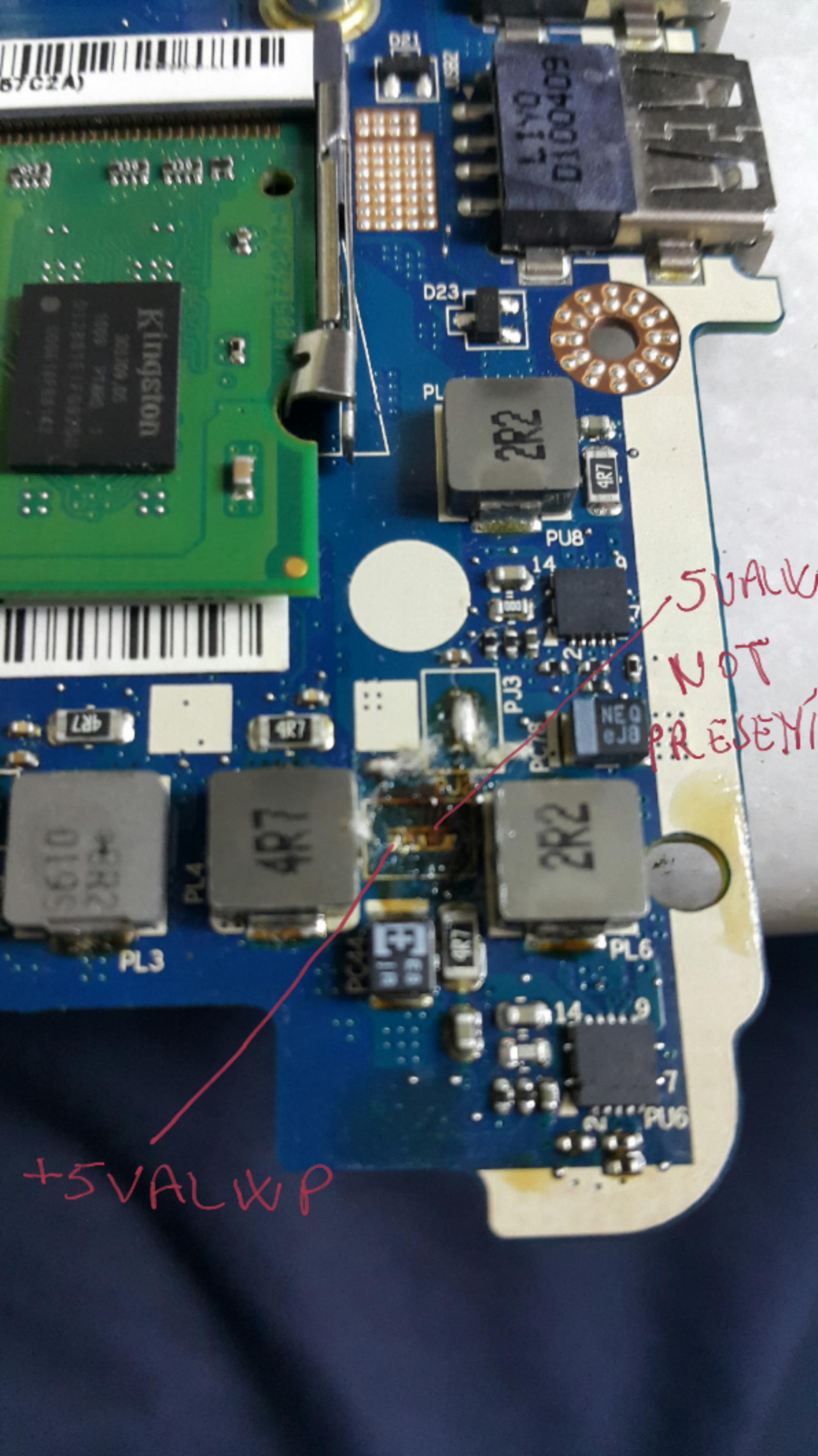

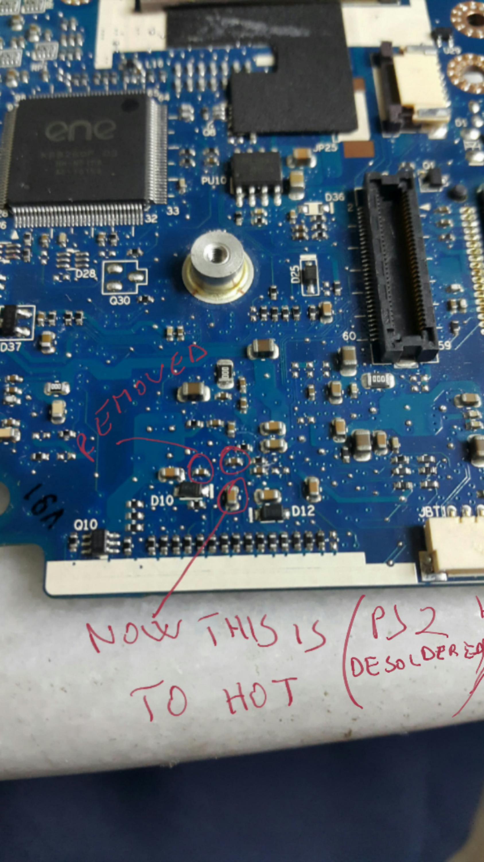

    Hi i have this acer not charging laptop.
    i checked it and no 3.3v on bios flashed it no change.
    Changed PU4 no change.
    The problem is 5VALWP and 5VALW
    when i desolder PJ2 5VALWP is present , but 5VALW no voltage
    with pj2 desoldered charge ok but no screen.
    Changed PU6 PU7 no 5Valw
    5VALW not present , that s the problem .
    Any help please.

    try replace Q19, may be it was leaked

      Replaced pq19 measured on pin 123 1.2v but no charge no power , after measured again pin 123 300mv , replaced pq19 and pq21 and the same pin 123 300mv no charge no power.
