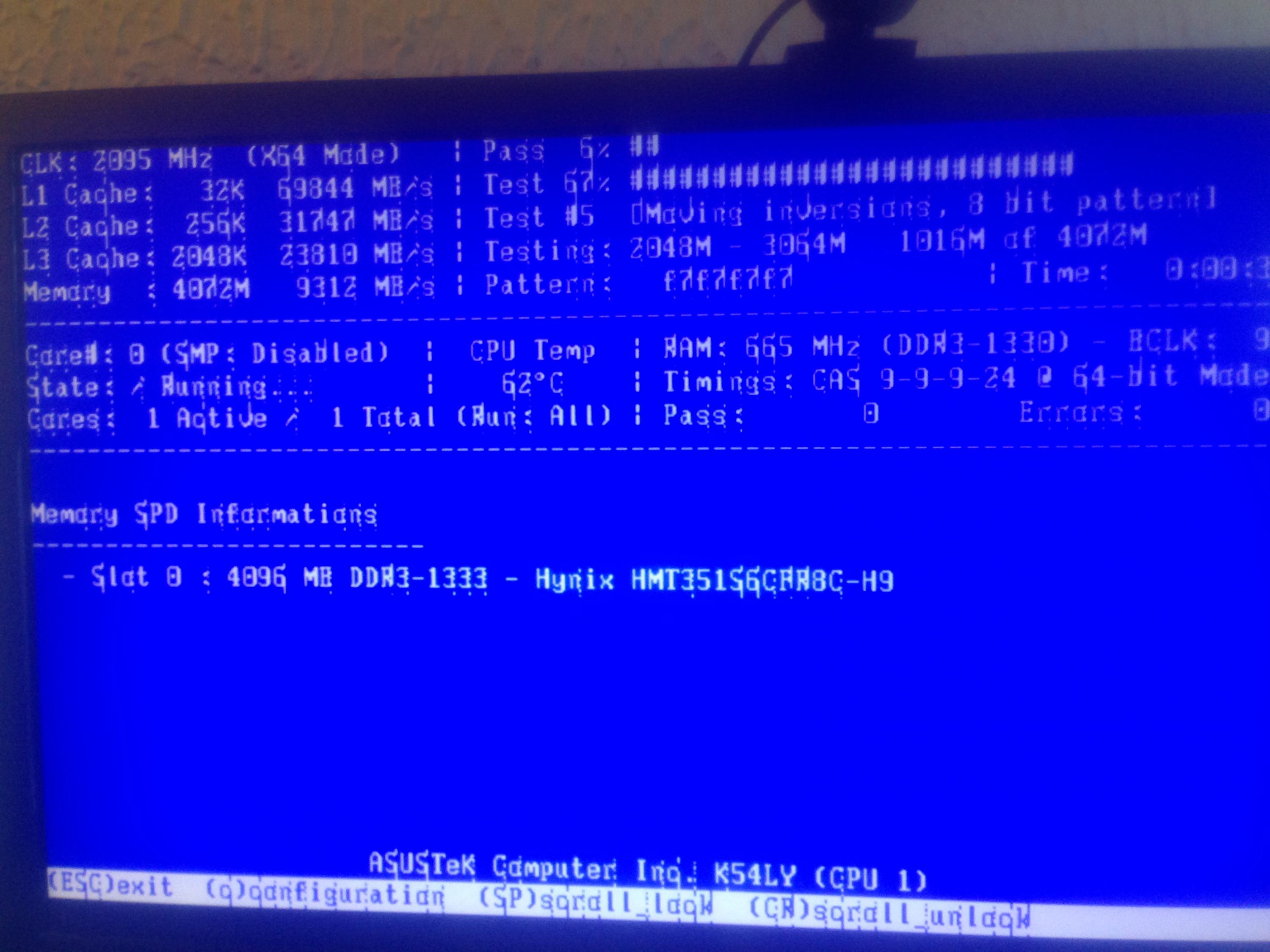

          well i try external display and i have picture on it hmm

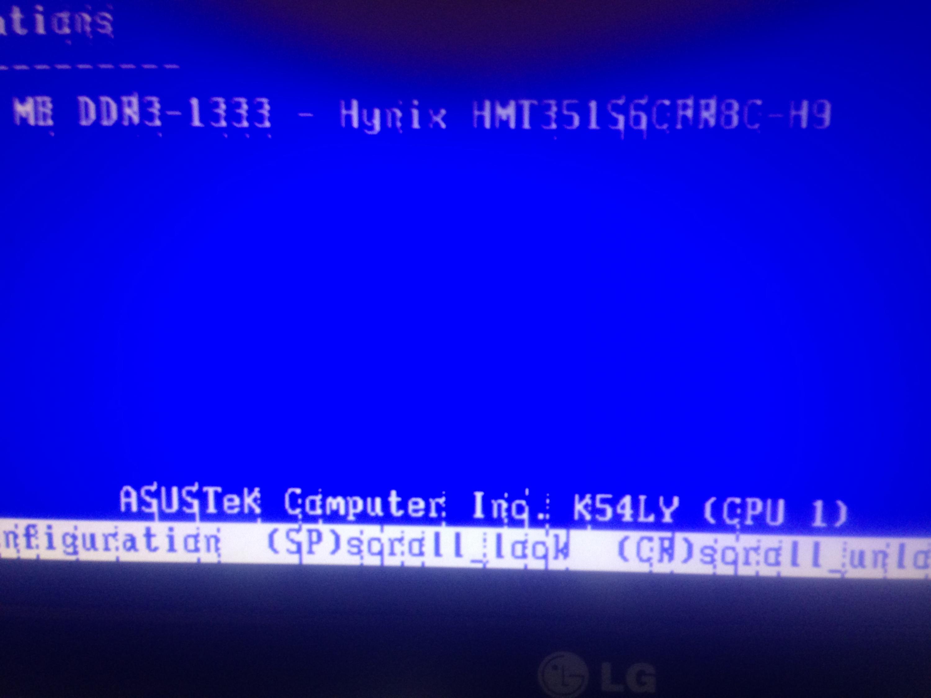

            this the picture on external display, is this GPU fail? Maybe reball or replace GPU?

              Re: ASUS X54H wont boot
              yes!
              if its like this in internal screen and it still goes than its ram
                No internal have no picture, external is like i posted (with defect)

                  I think the Gpu s the problem here, you can try reflow the gpu and if it work then reball or change it for new one.
