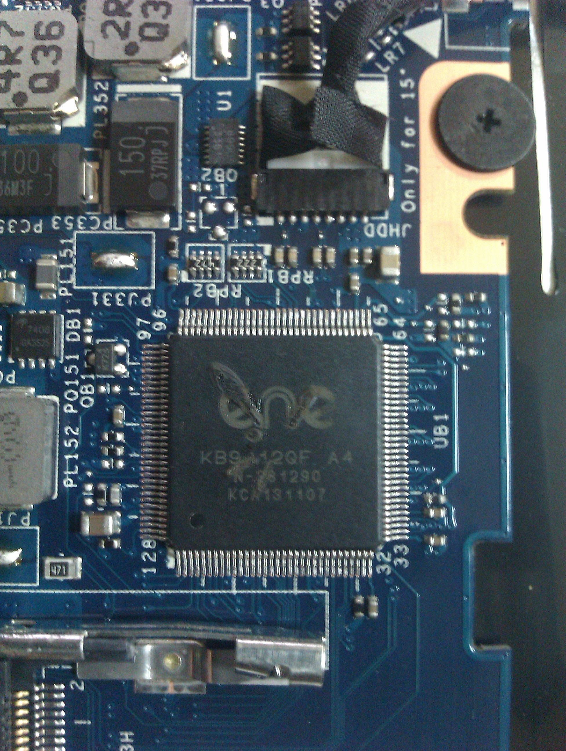

    i have satellite m50d-a-10d totally dead
    upon examining i saw burnt ene
    its burnt so that i cannot see fourth mark
    if someone can identify it would be nice
    i think this is KB9012QF A4
    if it is, can it be replaced with A3 version???
    i have no experience with this substitution and i have A3 available to buy
    tnx in advanced

    9012qf A4 .
    normally you can substitute it with an A3 . I already did it on dell ,acer , and HP. But sometime you have to program it .
    i use RT809f programmer to do that in the last case .

              9012 A3=9012 A4. Pin configurations also same but programming is must
