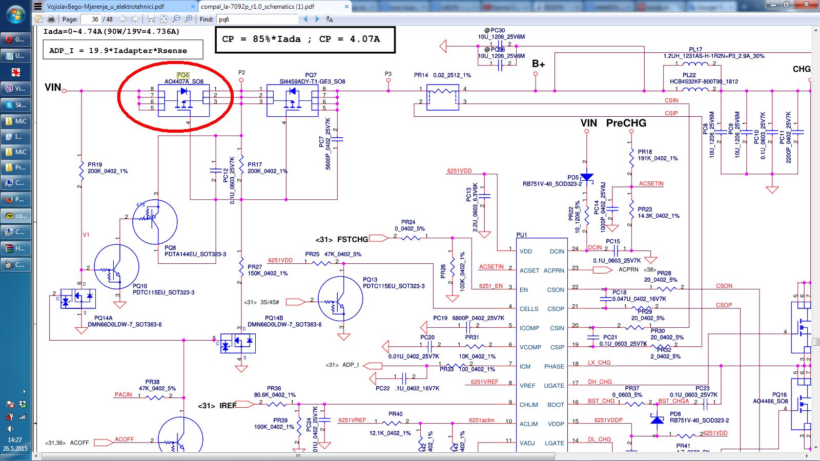

    Acer Aspire 5253 LA-7092P not power no lights
    Acer Aspire 5253 LA-7092P laptop will not power no lights
    AC ADapter is ok, conector is ok.

        Re: Acer Aspire 5253 LA-7092P not power no lights
        stops charging after a few seconds
        https://youtu.be/ihJy1rZuIyI
        Shematic:

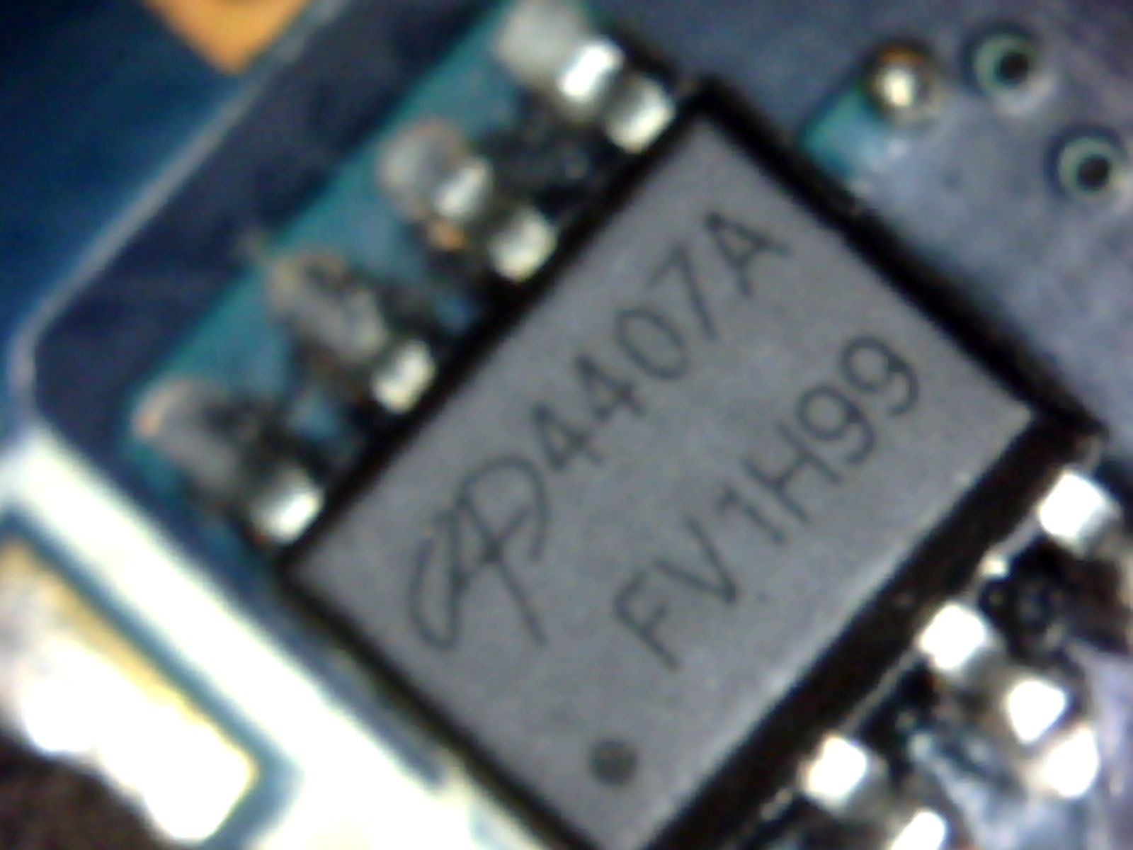

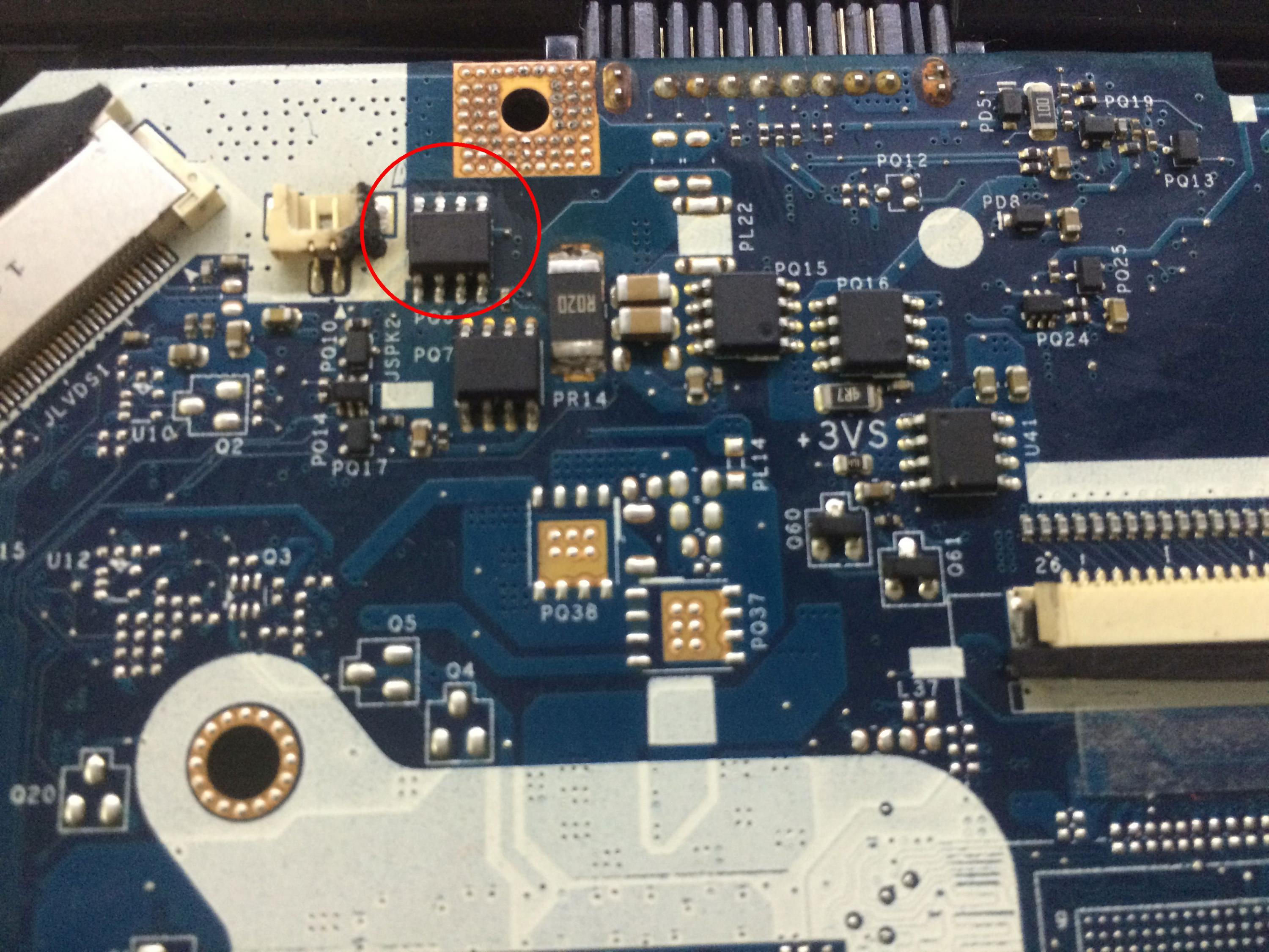

                            Finally I found the bad component. It is the MOSFET (A04407A) near the battery connector, after replacing the laptop works great.
                            see pictures:
                            Thanks for the help.
