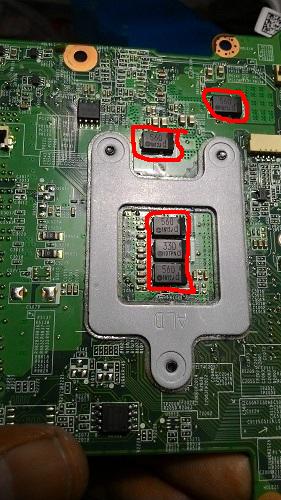

    Hi..i have a problem on my customer toshiba Satellite L840 freeze at loading windows..already change hard drive, ram .. but still same problem.. also i have flash the bios..
    try install windows 8, but also freeze at loading windows..
    board code.

                What you mean? Change bios battery..? Already change...cpu also

                  Does that tohiba has proadlizer capacitor? If does change it...If doesn`t check all capacitors in cpu vrm section...
                    the laptop use this capasitor

                        And replace these 3 bigs blacks caps.
                        Did you try to boot from Ubuntu?

                            i don't have cap 560..only have 330..posible to replace 560?

                              Just put one more. Or test them out if they are really 560.

                                Try to replace this capacitors...if not you can add one ads proposed but just for testing purposes...than if it works change them properly...
