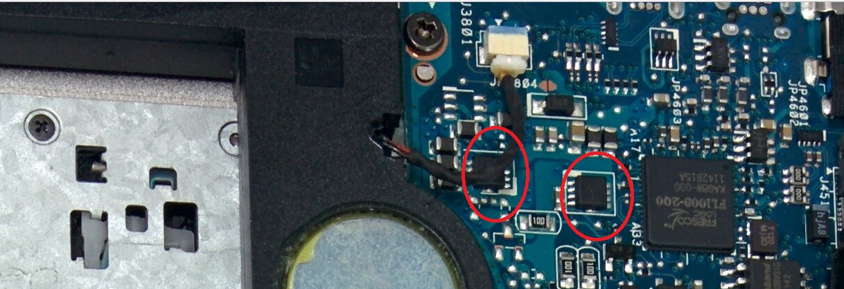

    the laptop problem with black screen no video and light.
    all voltage are present on board except VGFX_CORE on Pl8003.
    no short circuit found on coil .
    so what you experts are suggest?
    schematic available..

    check voltage on P_GFX_DHR_30 and ALL_SYSTEM_PWRGD signals

      @Ktmmotocross thanks for your reply.
      0 voltage on gate as you said P_GFX_DHR.
      this board have no components board numbers so it is very difficult to search the specific point.
      have any one board view soft for this ?thanks

        plz help these mosfet refernce n channel or p channel
