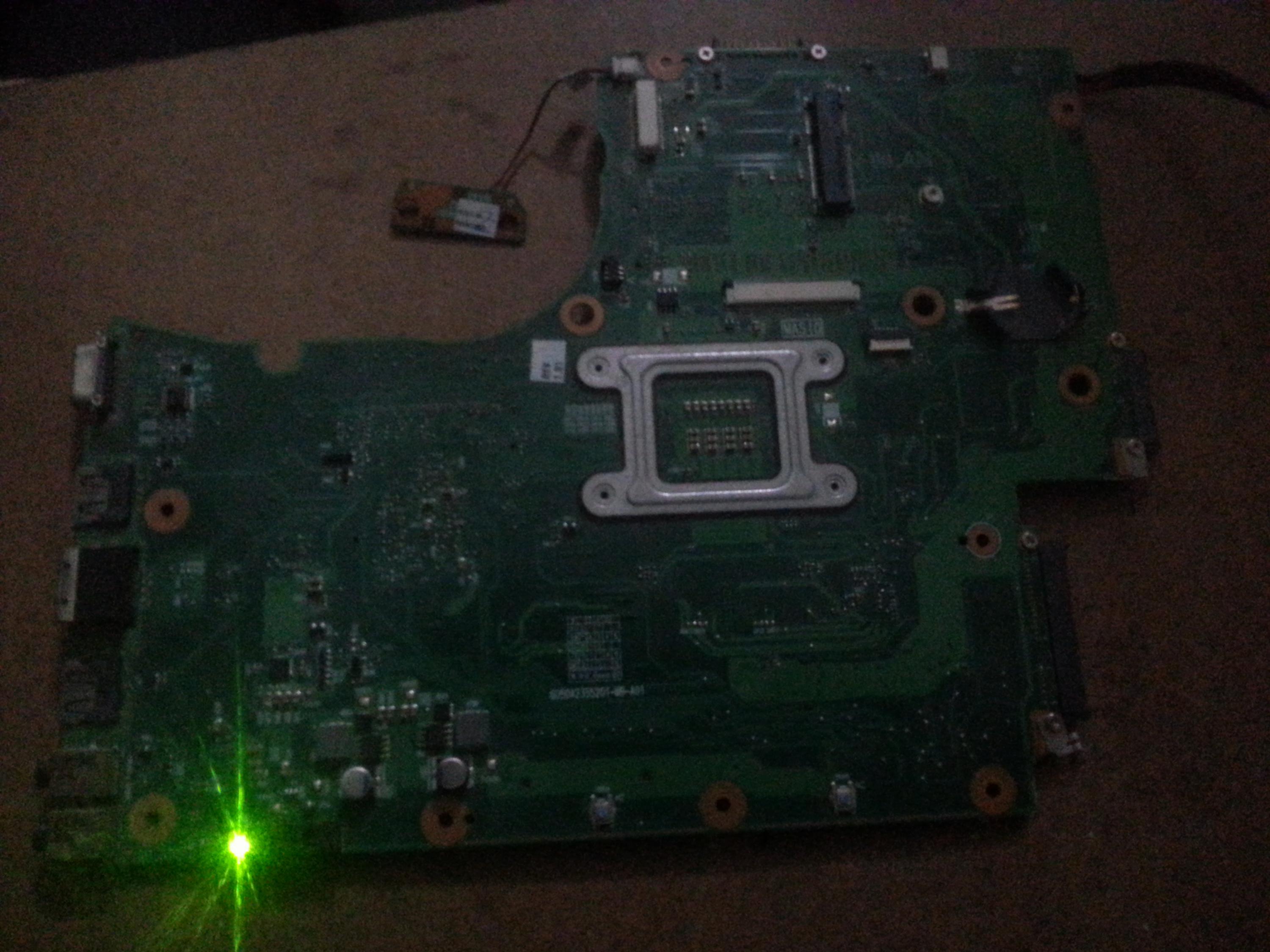

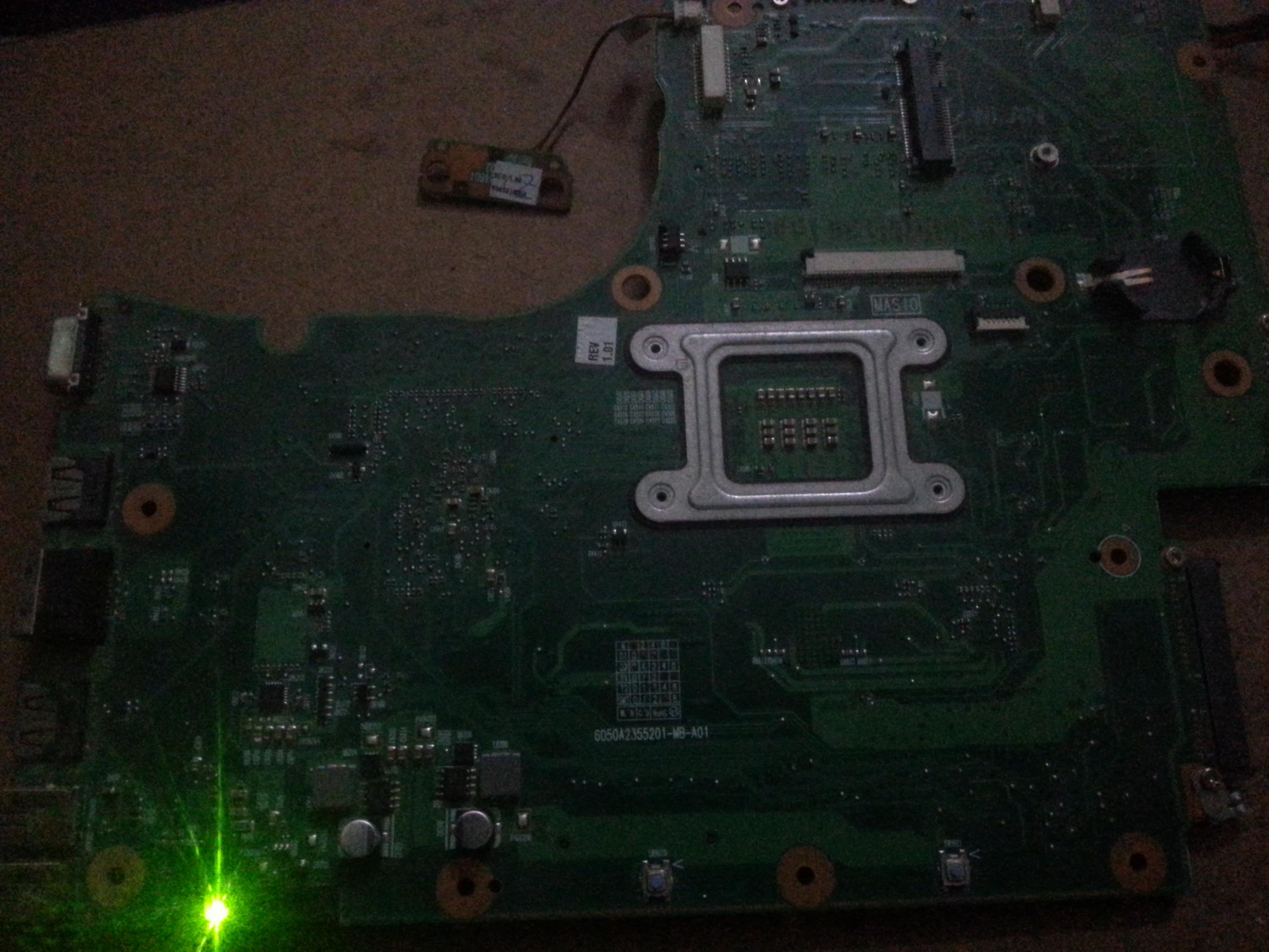

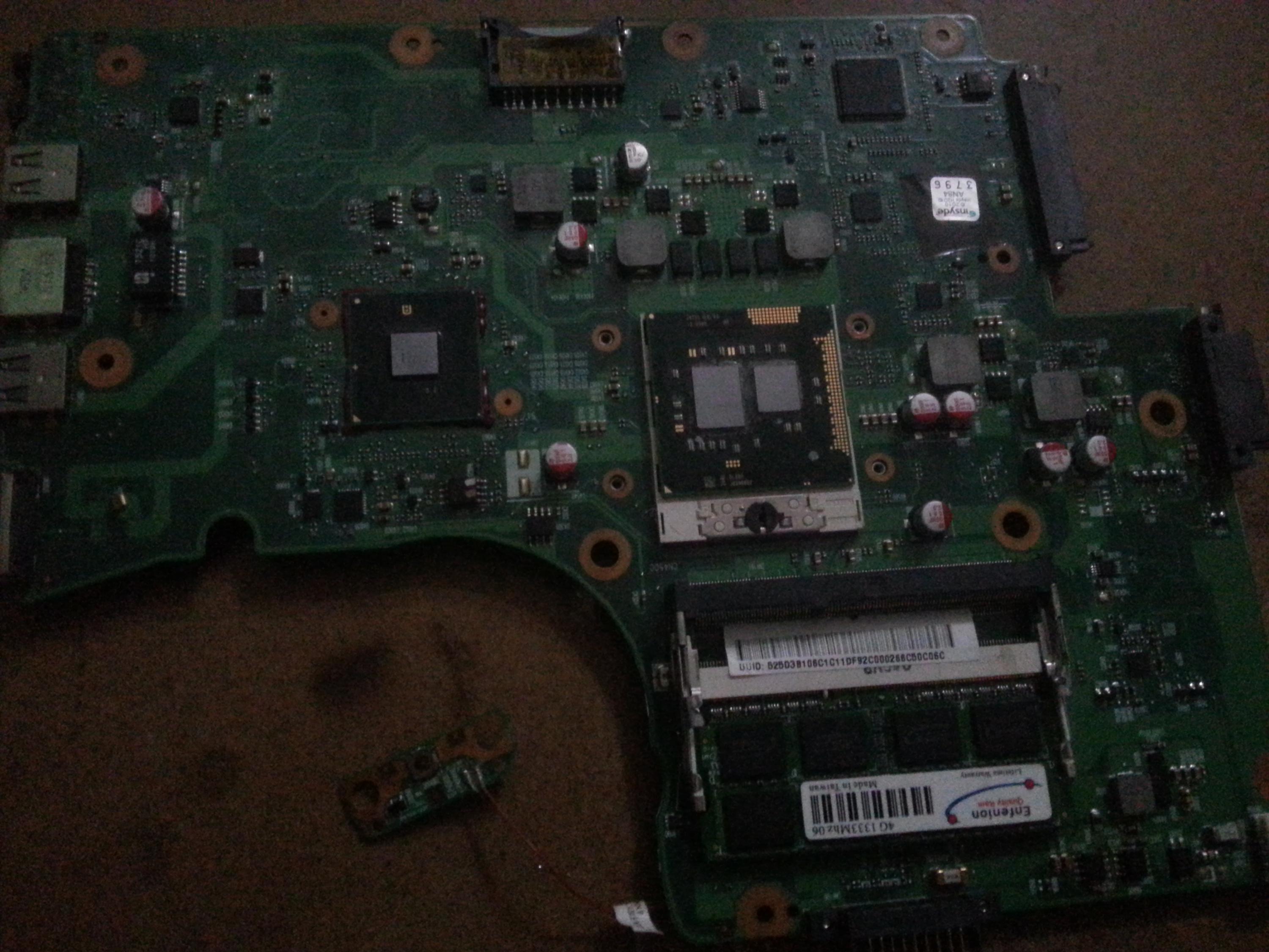

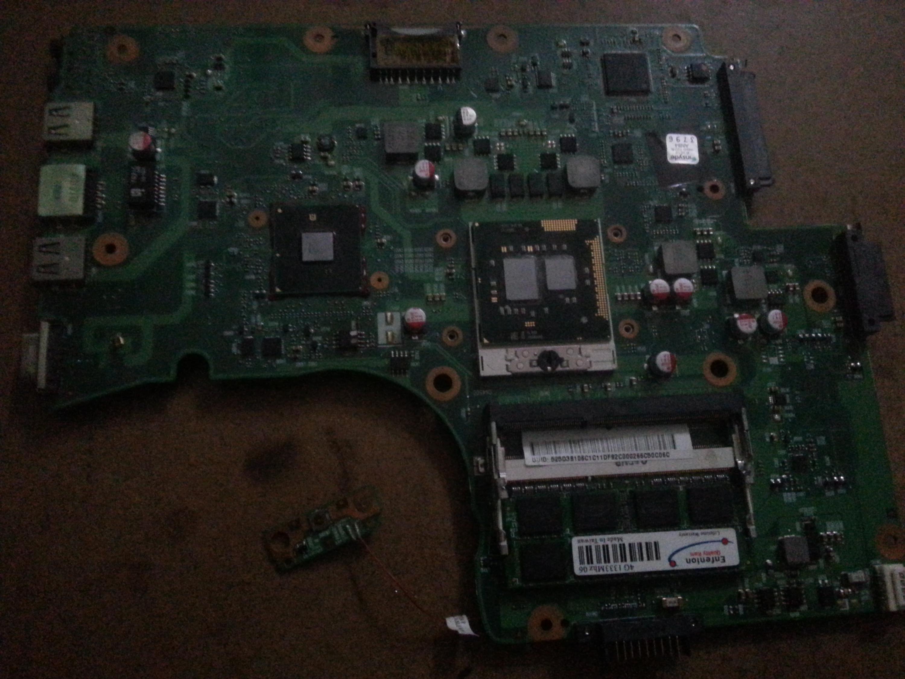

    hello please i have this Toshiba which can't on Toshiba C650-129 Can't On but the power light is on you can see from the picture please I need help can someone help me. Thank You.

    ok
    voltage on power button!
    does it drop when its press?
    post voltage on that IC .
    there is on forum how they fix this board with that IC.
    i fix in 6 months 20 C650. that IC goes bad
