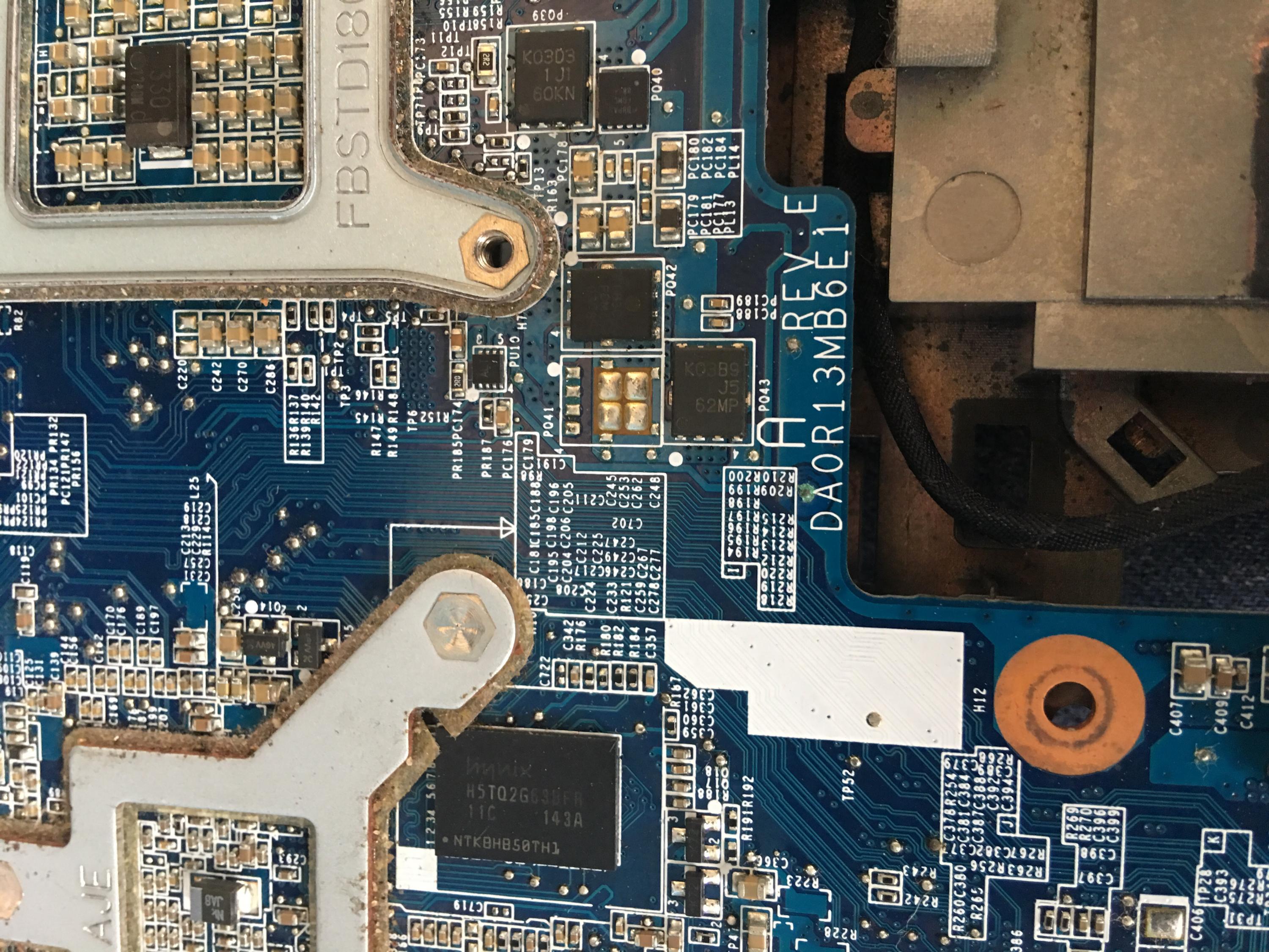

                  • Pascal Komlassan
                    • Jan 2017
                    • 806
                    • TOGO
                    Re: HP pavilion G7 white screen
                    Please I need the bios dump of this motherboard
                    DAOR13MB6E1
                    Rev:E
