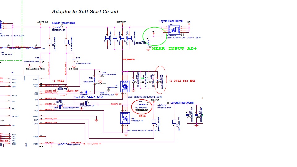

    acer aspire 4710z D28 burn
    what is the part number of this diode . ..
    do you have schematic

        Re: acer aspire 4710z D28 burn
        If the motherboard I'm looking at is the same as yours. This will be the part number of diode P4SSMJ24PT-GP. Can you post pic of DC1 area?

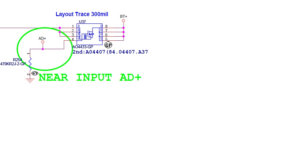

            it is connected with r254 and pin 4 of U37ic
            • lezsimply
              The Wanderer
              • Jan 2013
              • 645
              • Philippines
              nope its a different one.
                        we have same schematic. Look for d28 on page 41 "ad/batt conn" its along DC1 connector.
