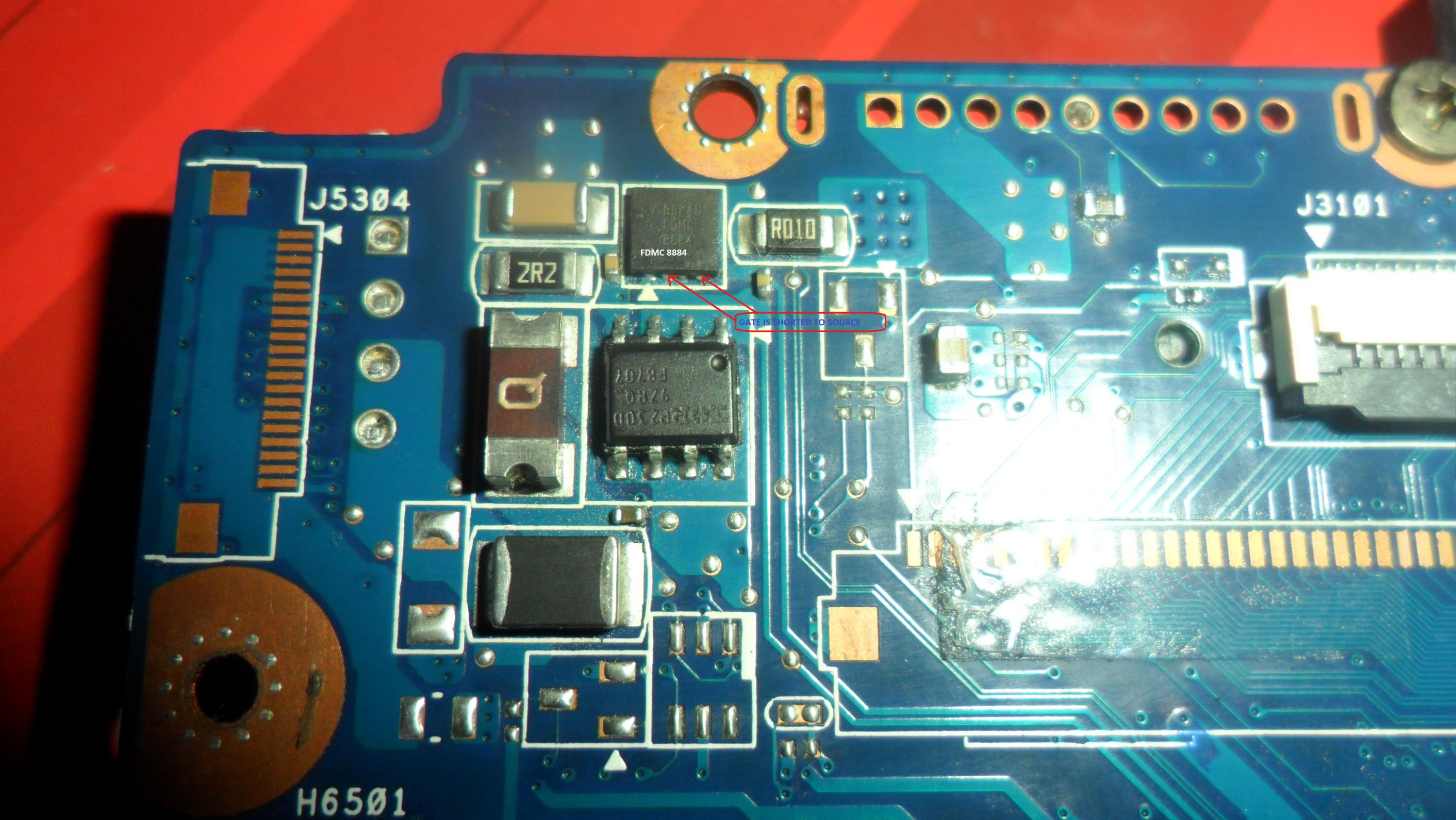

toshiba satellite c855 don't work with adaptor fdmc8884 is shorted
  • polytek
    • Dec 2013
    • 496
    • TUNISIA
    i have received the laptop from my friend, he tell me that the laptop work with battery, but not working with the dc adaptor, start troublshooting, i found the power mosfet fdmc8884 is shorted, i replace it the laptop is working fine and the battery is charged,
