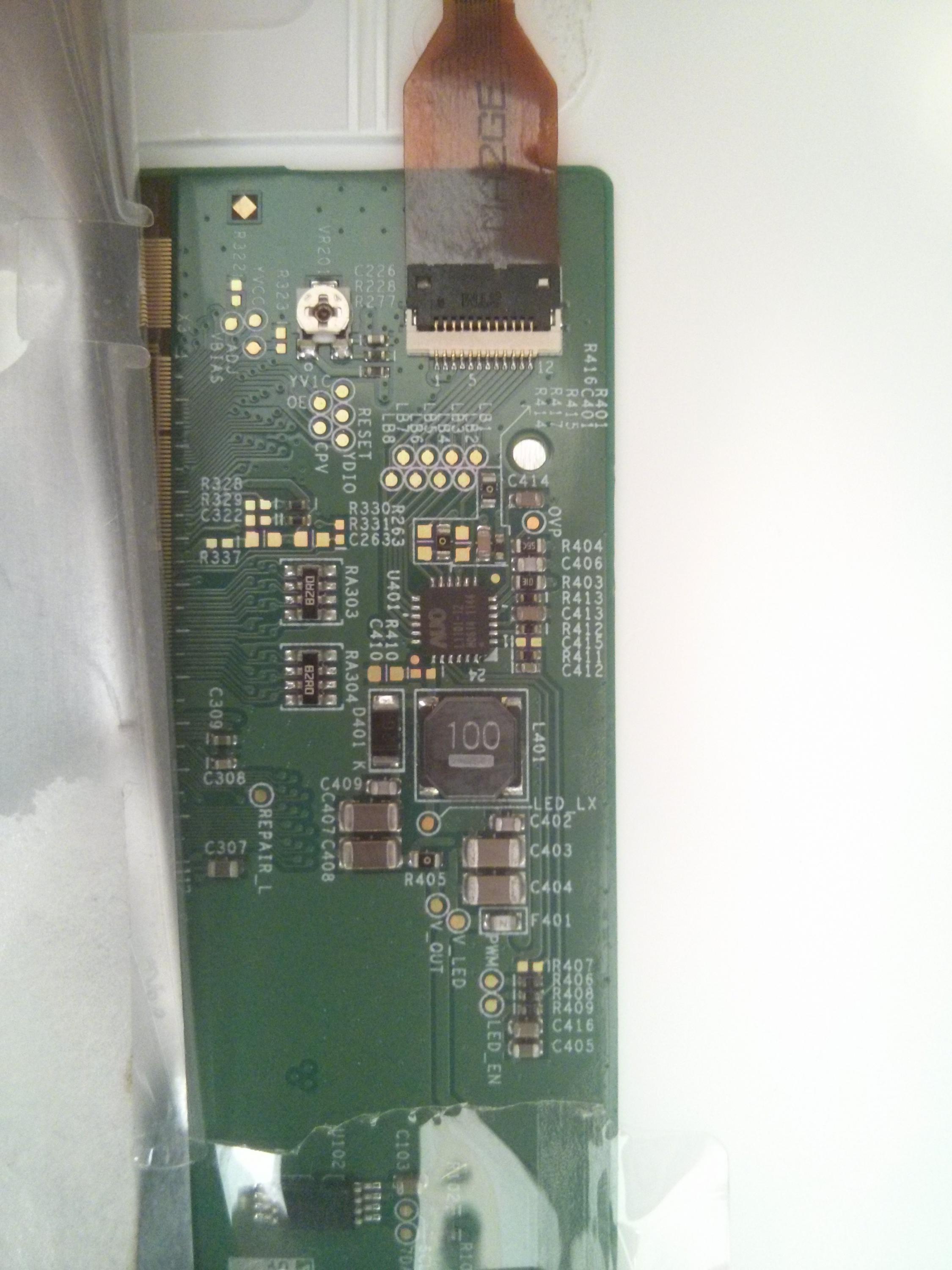

    inspiron 15r no backlight but voltages seem OK
    Can see screen with flashlight only.
    Dismantled and checked voltages on LCD controller board:
    LED_EN 3V
    V_OUT 0V
    V_LED 19.3V
    PWM 2.85V
    YVCC 2.43V
    LB1~8 0V
    no voltage at any of the pins on the ribbon connector going to the LEDs.
    This is a quite new laptop.

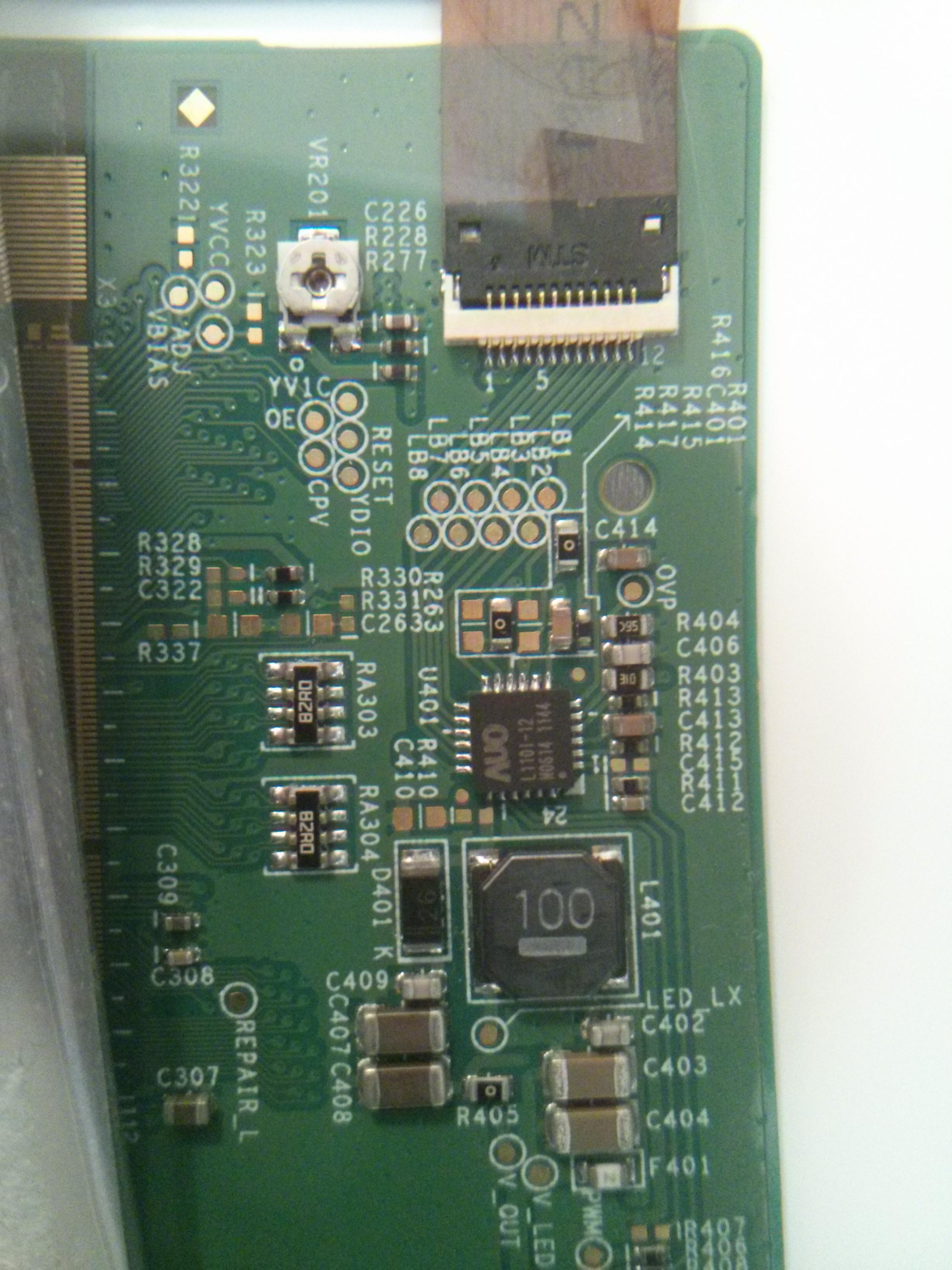

    Re: inspiron 15r no backlight but voltages seem OK
    Here's another photo but my eyes can't quite make out the chip number.
    The LCD panel model is B156HW02 V1, h/w: 4a by au optronics
    D/pn 035k06
    Link to datasheet here but I can't download, needs registration.
    http://www.panelook.com/B156HW02%20V...meter_688.html

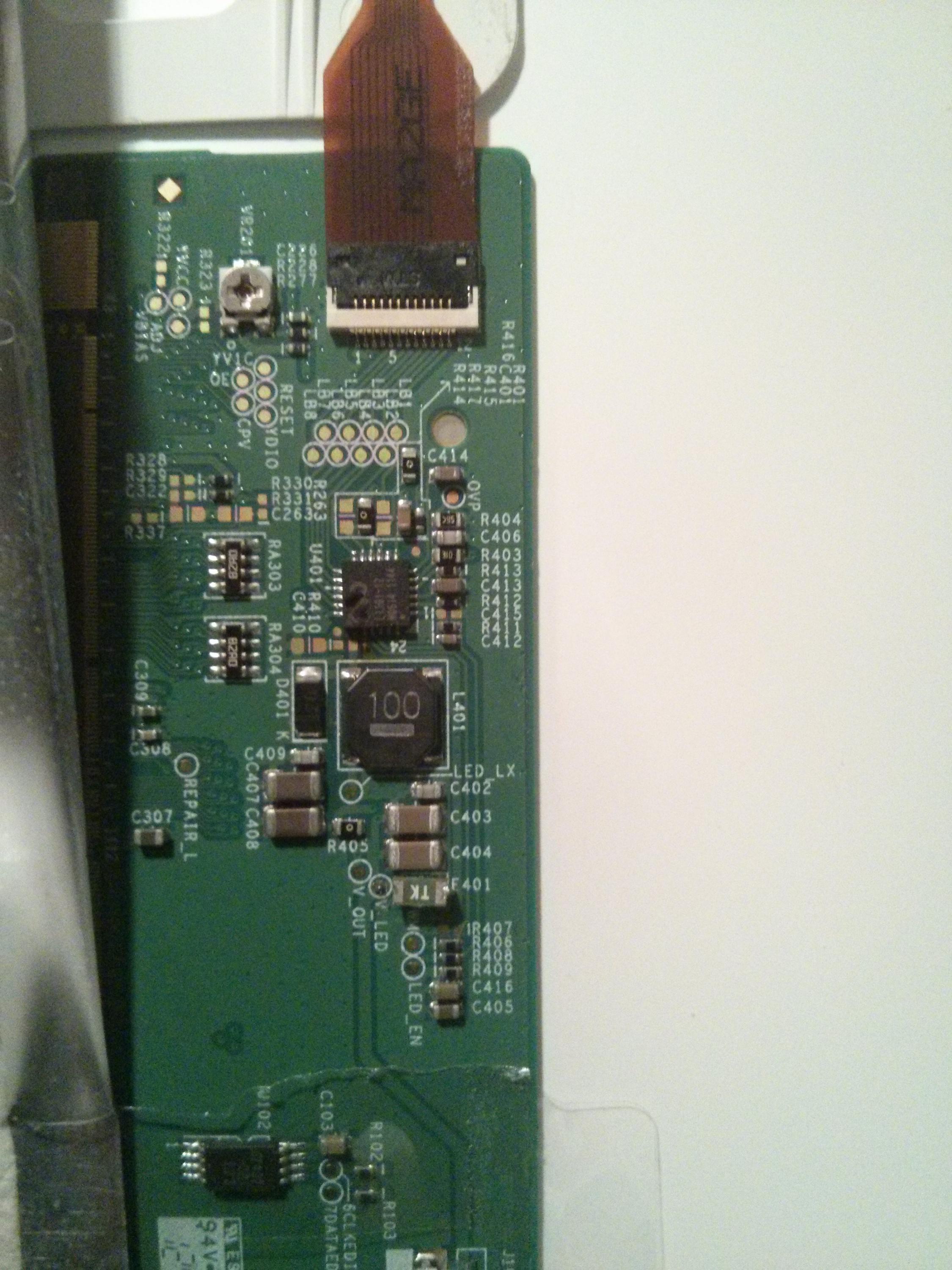

      I tested F401 shown in image and there was no continuity, is it meant to be a fuse??
      I'll await someone's confirmation since last time I jumped the gun.
      • trebo
        • 514
        • Wales, UK
        F401 is a fuse
        • frosty3907
          • Sep 2014
          • 30
          I shall replace
          • frosty3907
            • Sep 2014
            • 30
            Replaced fuse and protection ic went up in smoke.
            Whole panel is cactus now I guess?
              I have two of that model panel in different states of broken-ness. It seems to be a common issue with them. Unfortunately, there is no way it can be fixed, short of swapping the chips from an identical screen with another issue (like smashed).
                I guess there is some bad caps which are short.
                  Even if I replaced the protection ic it would just blow again. Seems these panels might have an issue based on the number of 15r n5010 threads. Super annoyed
                    What if I bridge the v_out and v_led test points? Try and cram 19v directly into the LEDs? Or is there a better way to do that?
                      Although I guess that probably will use too much power because it won't be pulsing?
                      I don't know seems a shame to throw out a perfectly functioning HD LCD panel.
                        You'll never believe it but I got the backlight working by bridging the two test points mentioned above, connecting ground to the LCD ribbon shield and removing two LEDs from each bank of 9. It flickers a bit and uniformity isn't great but there's a problem with the LCD panel!!! >
                        It is divided into three distinct horizontal sections, the middle section looks right, the left section darker than usual and the right section brighter, it's not the backlight because the change is too sudden. What the heck is that about??
