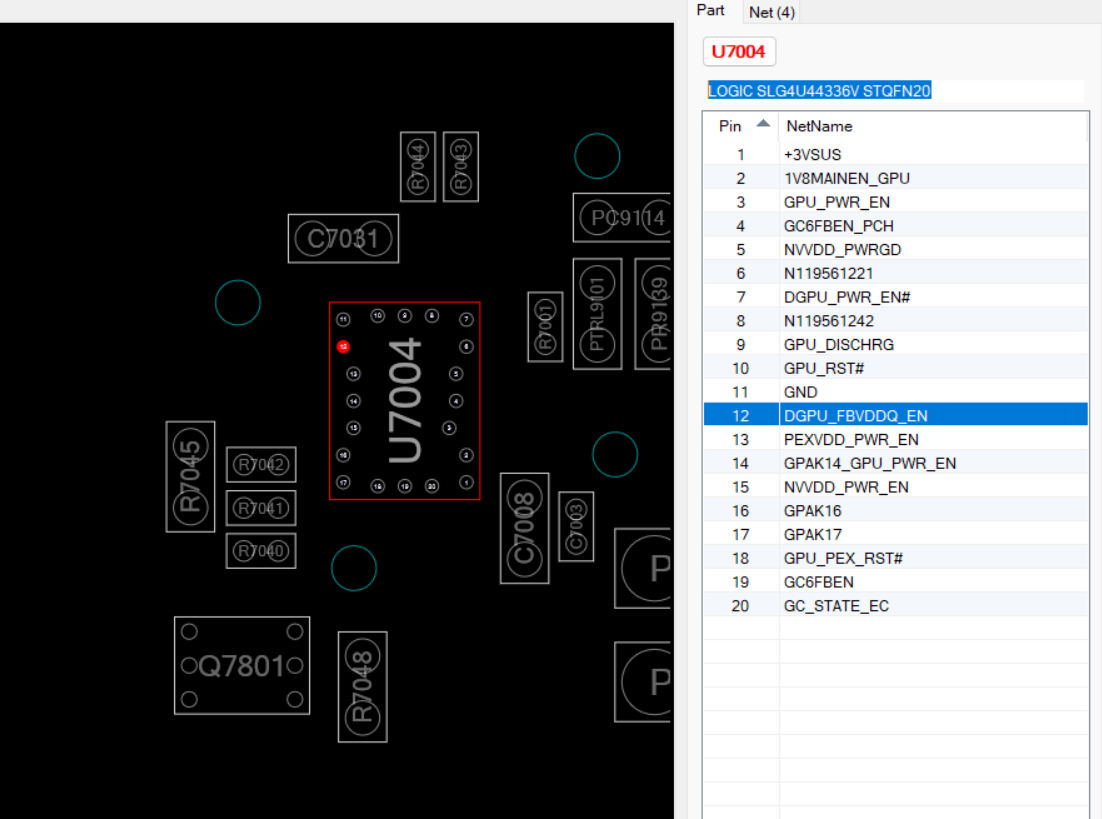

Hello everyone, I’m working on the motherboard of an ASUS FX516PC. Initially, the laptop had no response at all because the user replaced the RAM and accidentally caused a short circuit, which burned the EC. I replaced the EC and the machine now powers on and shows display, but it does not detect the GPU.
When I check the GPU power rails, there is no voltage for the VRAM and no 0.9V for the Vcore. The DGPU_FBVDDQ_EN signal, which enables the VRAM power, is missing. At the LOGIC IC SLG4U44336V (STQFN20 package), I have +3VSUS and 1.8V MAINEN_GPU. I replaced the SLG4U44336V logic IC as well, but the issue remains the same.
Can anyone help me?
