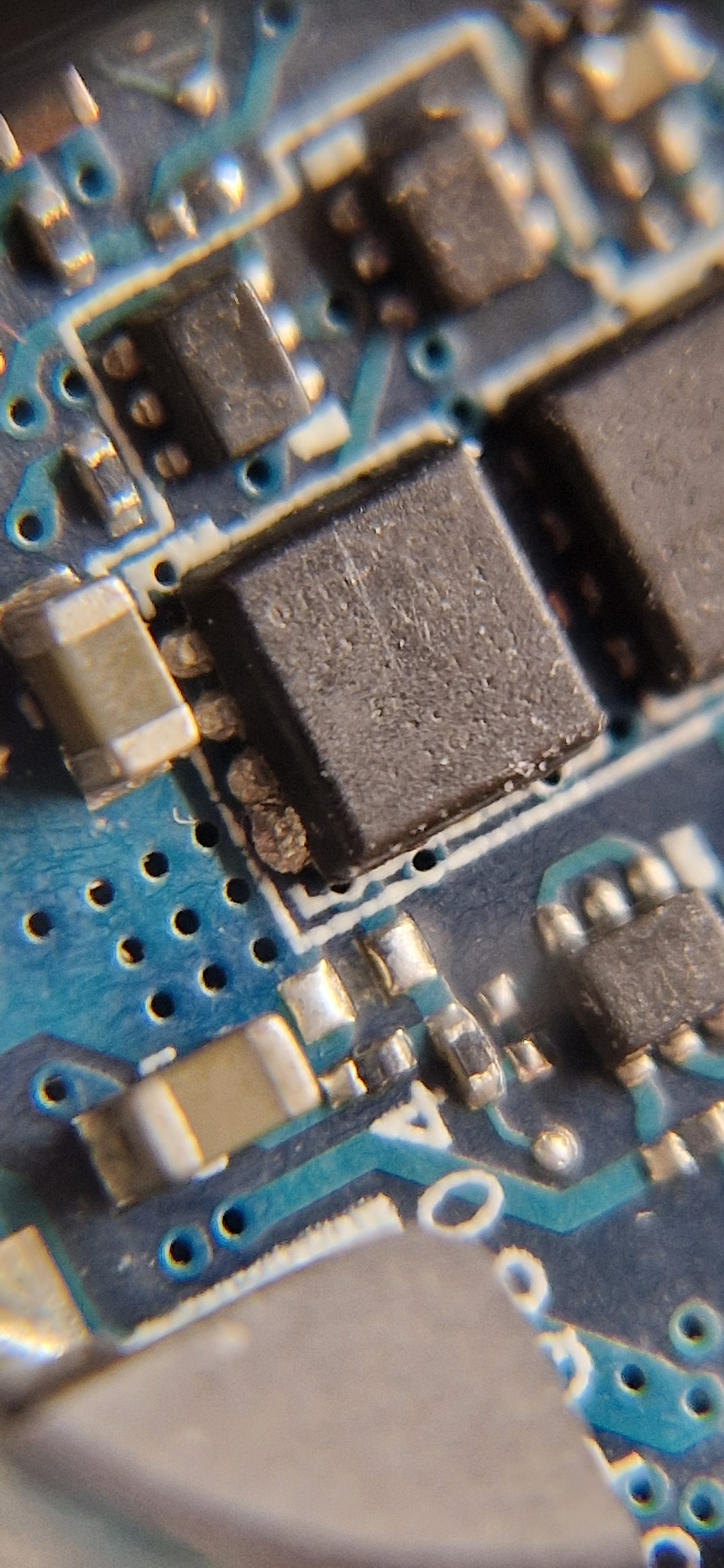

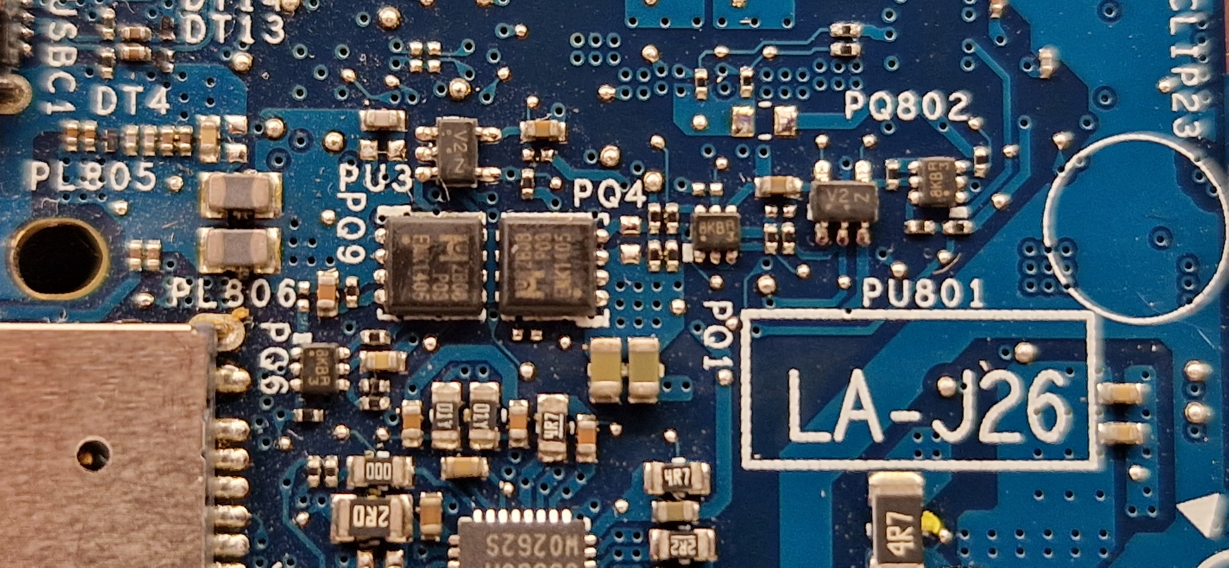

                          Look what I noticed on PQ801
                          There is short between Gate and Source

                            #53
                            I cleaned the short but still same voltages.

                              #54
                              Test PQ801 for defects since it was shorted.
                              • Andreasbest
                                • Aug 2014
                                • 1236
                                • Hellas ( Greece )
                                #55
                                Source Gate 175K
                                Gate Drain 6M
                                Source Drain 0.8M
                                • mon2
                                  • Dec 2019
                                  • 14996
                                  #56
                                  175k to me is low. Replace this mosfet.
