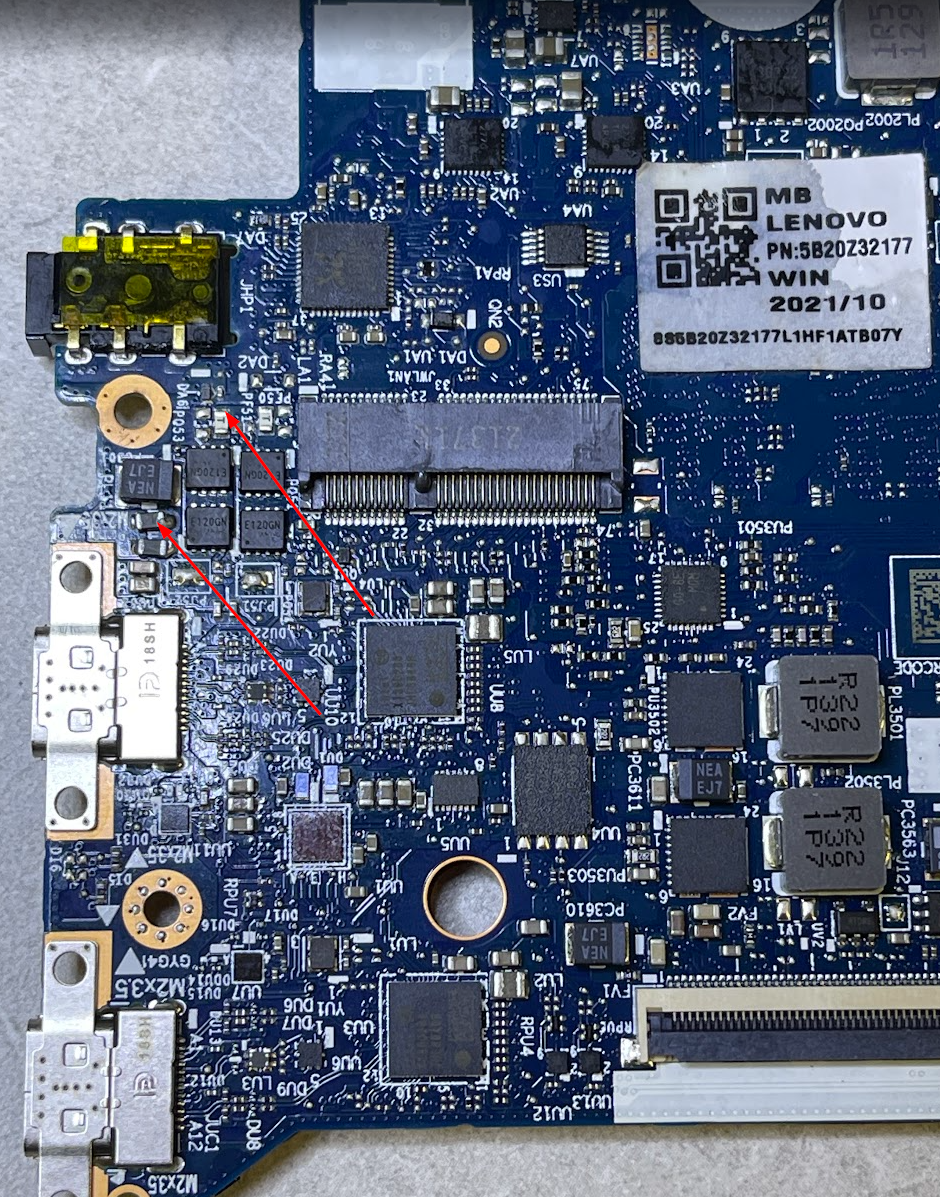

No Power - Lenovo Yoga 7 15ITL5
  • survivalbloke
    • Aug 2021
    • 307
    Lenovo Yoga 15ITL5
    Serial# PF32QTH9
    Board# GYG51
    I'm getting no power, USBc charger @5v, 0a. Short to ground at fuses(pictured). Injecting 1v @ fuse pf50 or pf51, inductor PL11 is lighting up. I would think those mosfets next to the inductor would be at play, but it looks like one end of the inductor connects to the fuse, and the other end looks like it goes to UU1. Where should I be looking next?Click image for larger version
