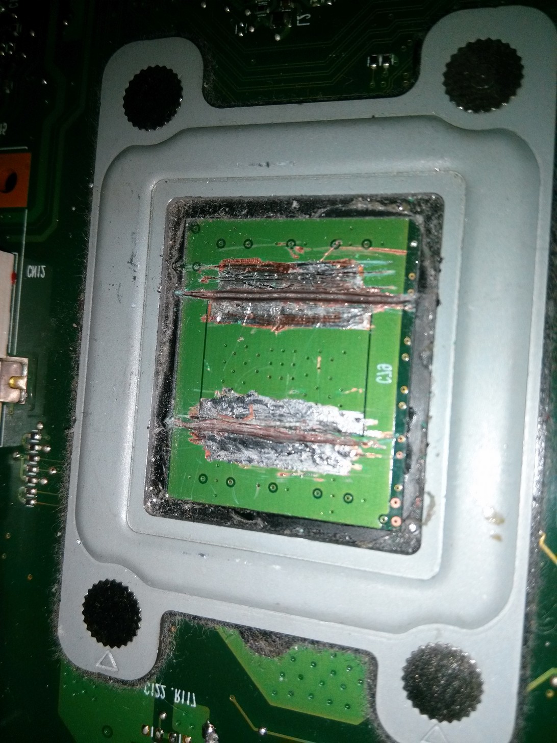

                      • magneh
                        • Apr 2014
                        • 622
                        • Portugal
                        #31
                        Re: Toshiba L300 Image Issues when entering OS
                        Hello !
                        Well tried to remove the copper between contacts...
                        Dunno if I'm doing it well ... but here are some pictures.
                        Till now the short isn't gone...
                        Cheers,
                        Jose
                        • rievax_60
                          • May 2012
                          • 897
                          • australia
                          #32
                          It looks like you did exactly what you were advised not to do. Read post 23 again.
                          It looks like the board is ruined.
                          • rievax_60
                            • May 2012
                            • 897
                            • australia
                            #33
                            I took a close look at your last 2 photos. You are trying to scratch through copper that is nowhere near the gap you where supposed to clear of stray copper fragments. Why?
                            Your photo in post 24 showed possible shorts in just a few places in the gap.
                            • magneh
                              • Apr 2014
                              • 622
                              • Portugal
                              #34
                              Hello!
                              Well it seems I didnt quite understood how to remove those copper fragments.
                              Thought I would have to remove all the copper between contacts.
                              RIP Mobo
                              Think I have another one with the same issue.
                              I think now I have a good idea how to do it and how to DO NOT.
                              Never ruined a board before :/
                              Thanks!

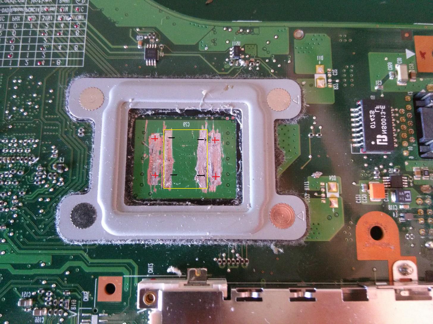

                                • rievax_60
                                  • May 2012
                                  • 897
                                  • australia
                                  #36
                                  I have marked the gap between the two areas of copper print in yellow. And also the polarity of the two areas.
                                  • Agent24
                                    I see dead caps
                                    • Oct 2007
                                    • 5085
                                    • New Zealand
                                    #37
                                    Wow, you gouged out pieces of the board like you were trying to cut right through it!
                                    -David VanHorn

                                      • Agent24
                                        I see dead caps
                                        • Oct 2007
                                        • 5085
                                        • New Zealand
                                        #39
                                        The last picture rievax_60 posted looks good. Maybe you can save it if you check the right places... hopefully you have not cut through any internal layers.
                                        -David VanHorn
                                        • rievax_60
                                          • May 2012
                                          • 897
                                          • australia
                                          #40
                                          yes, thats right, if he has not gouged down to the next layer, It should be ok with some repair to the + print that has been cut through. It would be good practice before risking the next laptop repair that was mentioned.
