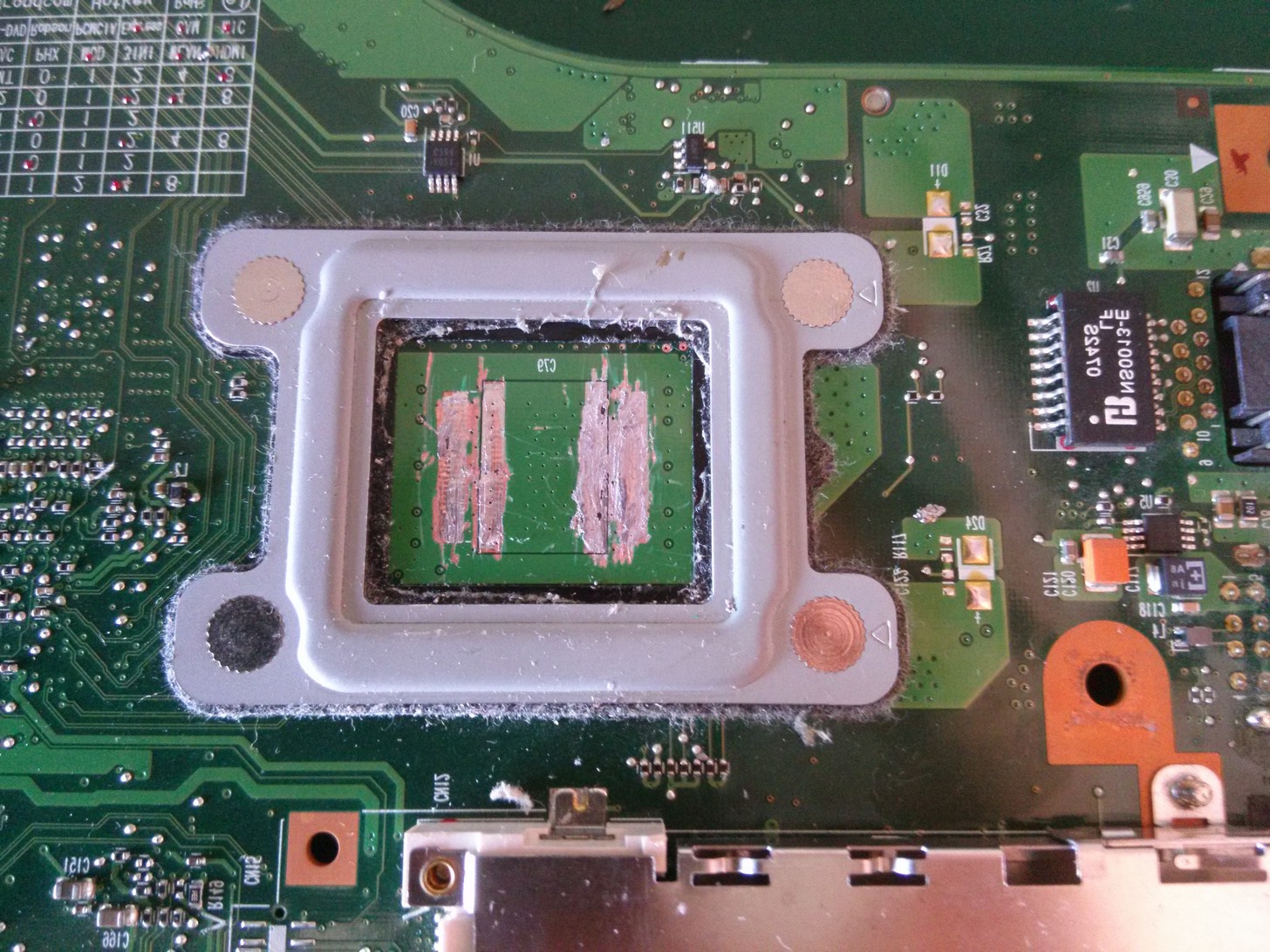

                      Re: Toshiba L300 Image Issues when entering OS
                      Any stray copper fragments need to be removed from the gap surrounding the rectangle shaped area that was under the old capacitor. A large sharp sewing needle will do the job. Then confirm that the short is gone.

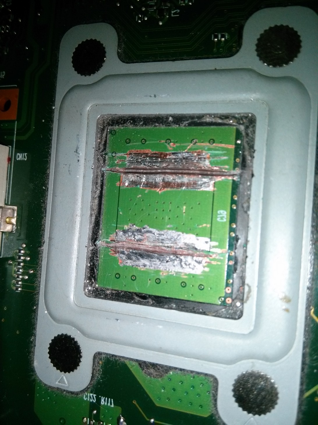

                        Hello !
                        Well tried to remove the copper between contacts...
                        Dunno if I'm doing it well ... but here are some pictures.
                        Till now the short isn't gone...
                        Cheers,
                        Jose
                          #32
                          It looks like you did exactly what you were advised not to do. Read post 23 again.
                          It looks like the board is ruined.
                            #33
                            I took a close look at your last 2 photos. You are trying to scratch through copper that is nowhere near the gap you where supposed to clear of stray copper fragments. Why?
                            Your photo in post 24 showed possible shorts in just a few places in the gap.
                              #34
                              Hello!
                              Well it seems I didnt quite understood how to remove those copper fragments.
                              Thought I would have to remove all the copper between contacts.
                              RIP Mobo

                                #35
                                It might be still repairable. But it would be too difficult to explain with enough detail that you would possibly misunderstand.
                                Have you figured out now what I mean when I say "gap"?
                                  #36
                                  I have marked the gap between the two areas of copper print in yellow. And also the polarity of the two areas.
                                    #37
                                    Wow, you gouged out pieces of the board like you were trying to cut right through it!
                                    -David VanHorn
                                      #38
                                      LOL
                                      Those who dont know how to do it ... that's the result
                                        #39
                                        The last picture rievax_60 posted looks good. Maybe you can save it if you check the right places... hopefully you have not cut through any internal layers.
                                        -David VanHorn
                                          #40
                                          yes, thats right, if he has not gouged down to the next layer, It should be ok with some repair to the + print that has been cut through. It would be good practice before risking the next laptop repair that was mentioned.
