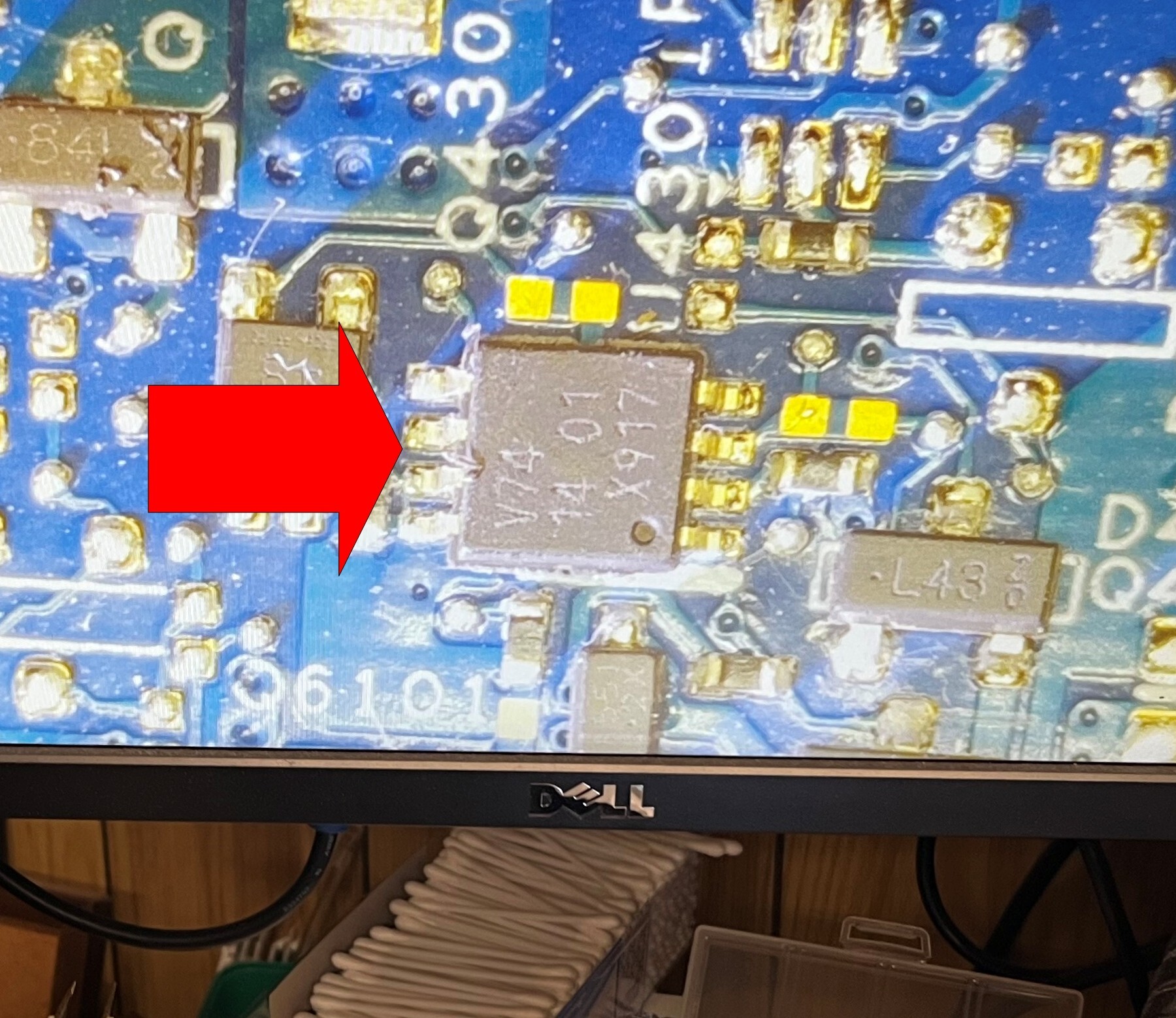

HP envy 13aq1001-ca 13.3 motherboard component identification
  • rddube
    Aspiring Expert
    • Jun 2013
    • 954
    Trying to identify what the component pointed by the arrow is for a HP Envy 13aq1001-ca motherboard for which I can't find the schematics nowhere. It is marked Q61010 on the silkscreen and the component is marked V74 14 01 X917.
    Anybody have an idea what this component is?
    It is shorted on a few of its legs.
  • dankva
    • 2
    Hi! It looks like a D-type flip-flop 74LVC1G74DP, see https://assets.nexperia.com/document.../74LVC1G74.pdf
