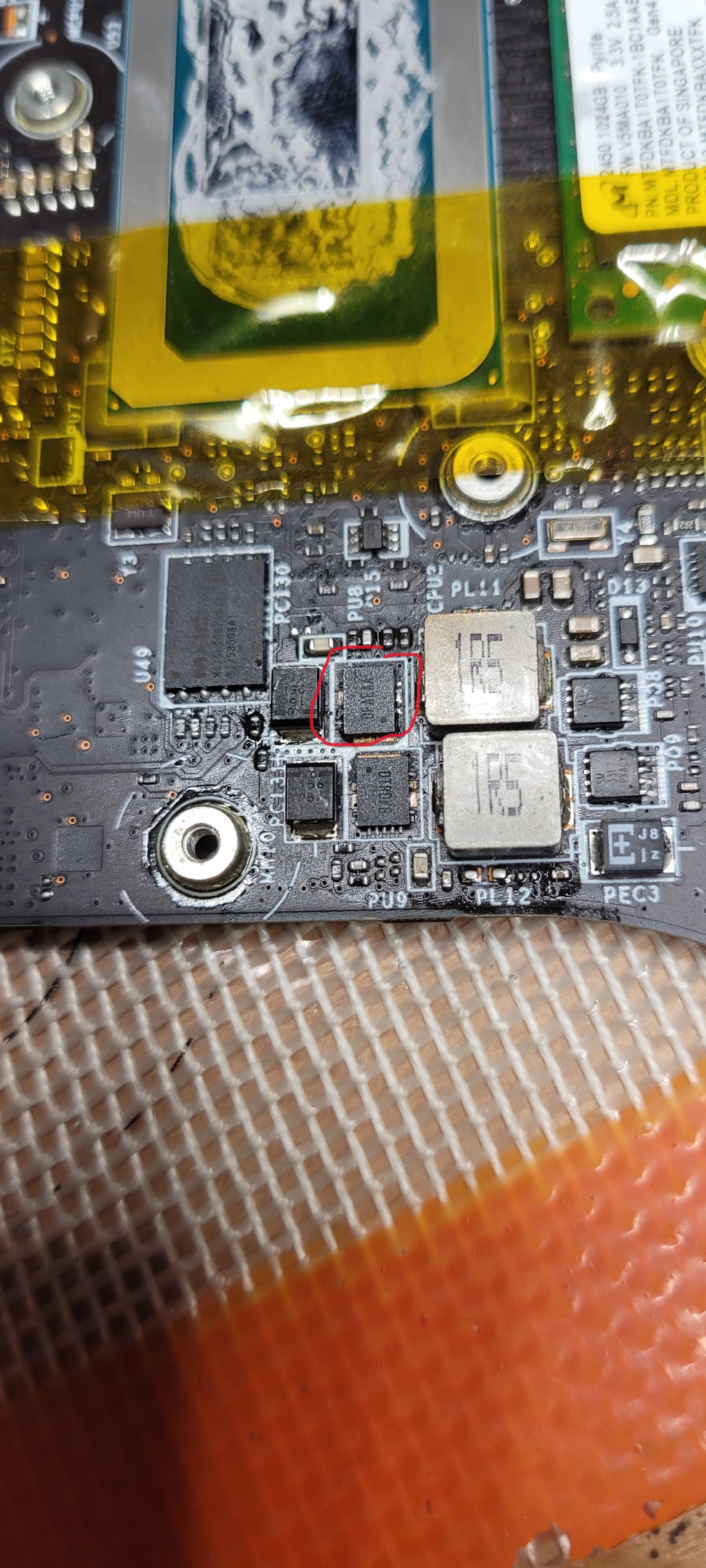

    Hello, I have an MSI motherboard pulling 200mA 20v and the IC with marking " DFAEAA " is getting hot.
    MSI Summit E13 Flip Evo E13FLIP EVO A12MT-026US-BB
    Mobo part number : MS-13P31
    I would appreciate it if someone could help me find this part or help identify it. I have searched for a schematic but no luck. Thank you.

    DFA*** SY8371BTMC
    Can't find datasheet, only the pinout and example circuit here:
    https://www.silergy.com/zh/productsview/SY8371BTMC

      Thank you for the info. I will try that chip and see how it goes.
