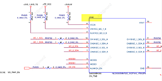

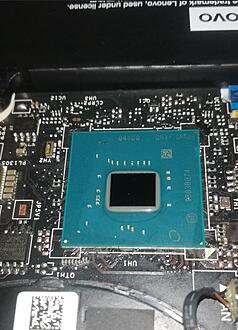

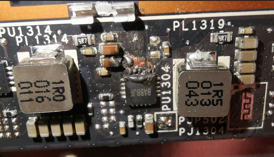

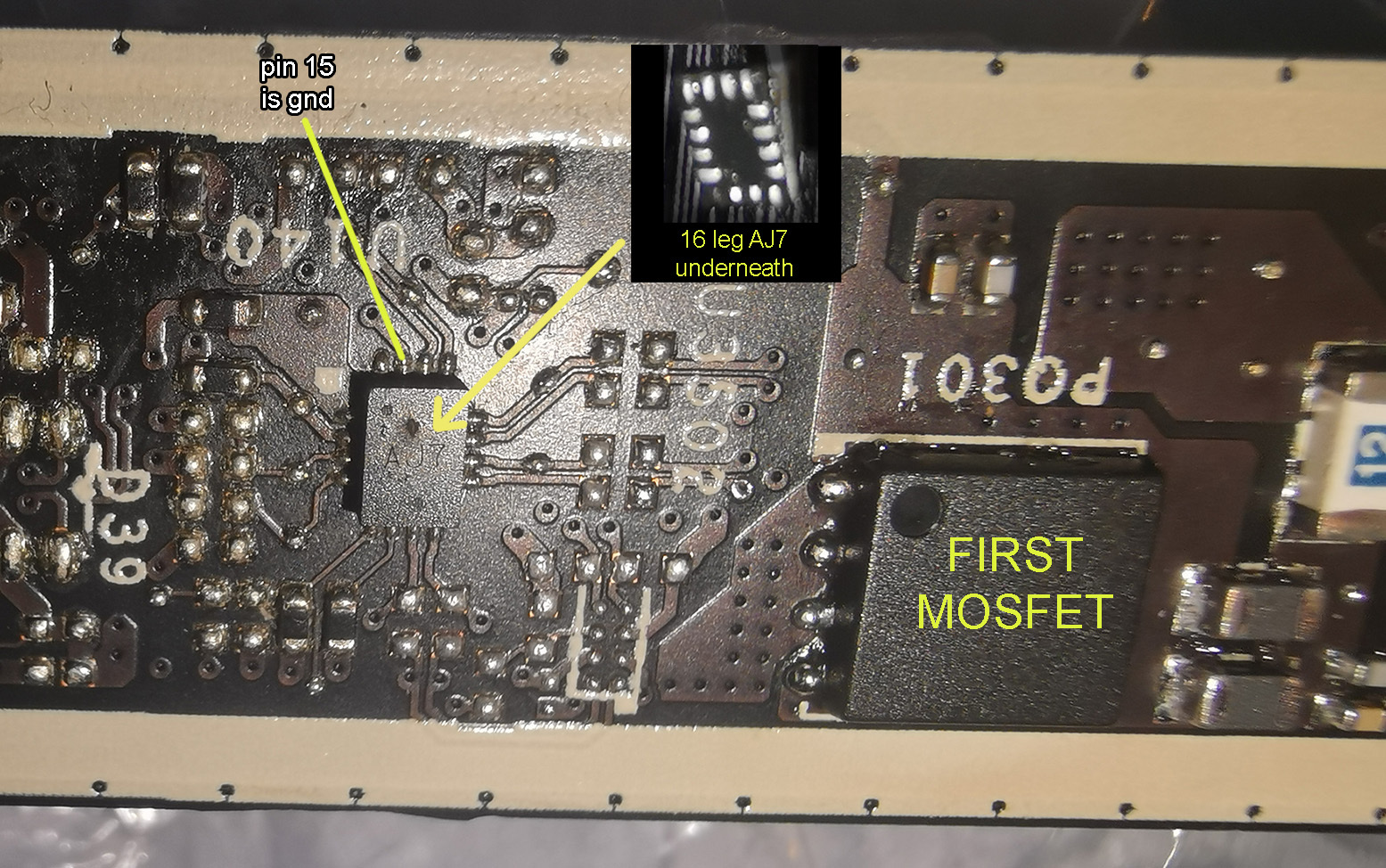

    Hello I'm currently repairing a lenovo ideapad s740 (intel i9 9th gen + gtx 1650) had got most of the issues solved, but in the end one ic is burnt and gets pretty hot, an AJ7, it's a 16leg qfn 2x3mm ic, I tried to find this everywhere, but couldn't make it, there are some AJ but those are different. Now this ic Is close to the first mosfet (it's not connected tho), in that part of the board there's nothing except for the edp connector and a little fpc that leads to some led signals (cpu, lenovo key and that kind of stuff).
    I leave a picture of the ic on both sides, maybe someone knows what is the name of this, because with the code I can't find it, thanks.
  • DeXXter
    • Aug 2023
    • 112
    • Chile

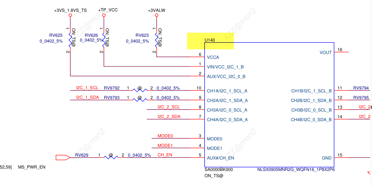

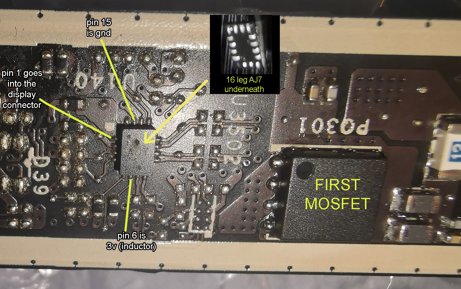

    I was checking the ic connections and the power comes from the 3v on pin 6, now it makes sense this ic got burnt (3v was one of the first failures), and pin 1 goes into the screen/edp connector, so probably a power supply for that.

      Mainboard model?

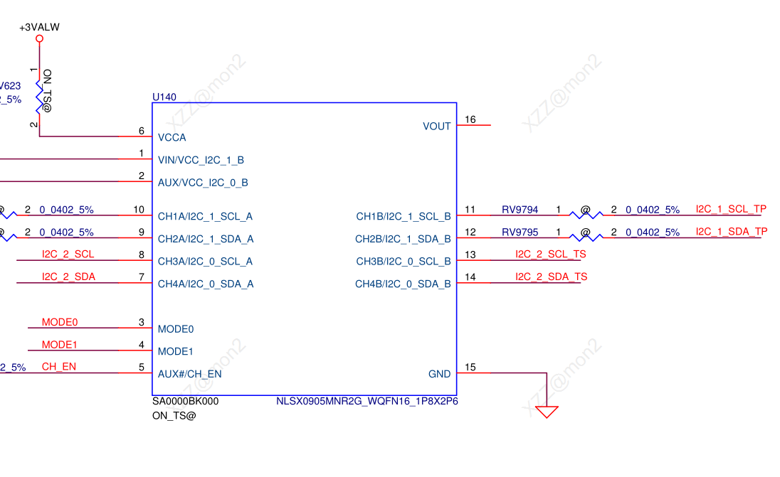

        Getting close but no hit yet on the part number.
        NLSX0905MNR2G

            It's a EL571 LA-H231P Rev: 1.0
            Mon2 found the ic NLSX0905MNR2G but still I can't find it anywhere to buy or find a replacement.

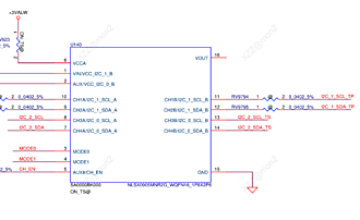

              From the schematic, this appears to be an I2C / SMBUS multiplexer with level shifting features. The part is mated to the touchpad. Very likely that there are replacement drop in parts from Texas Instruments / NXP.
              NLSX = ONSEMI. Still searching.

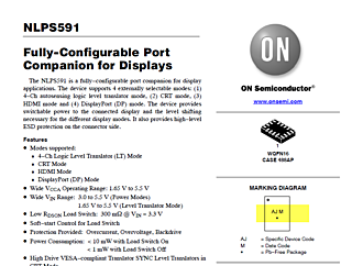

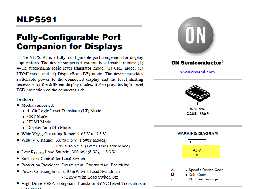

                Good news or bad news?
                Good news - see attached. Appears to be a drop in replacement (from a quick review). Bad news, part is still impossible to find and probably is EOL. Perhaps others can replace it.
                ONSEMI # NLPS591MNTWG

                  This part is the wikipedia definition of hell.
                  My Google searches come up with the following with this part number.

                    Ok, found it but appears this will be a no fix due to the MOQ.
                    https://www.rocelec.com/part/01t4w00...T-NLPS591MNTWG

                      Thanks man, this was one hell of a job, I spent hours looking for this ic, at least you found the specific one. In the end I might just leave it like that, no touchscreen.

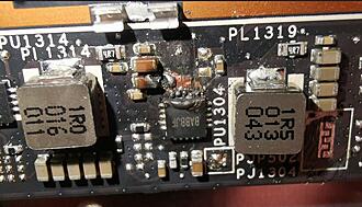

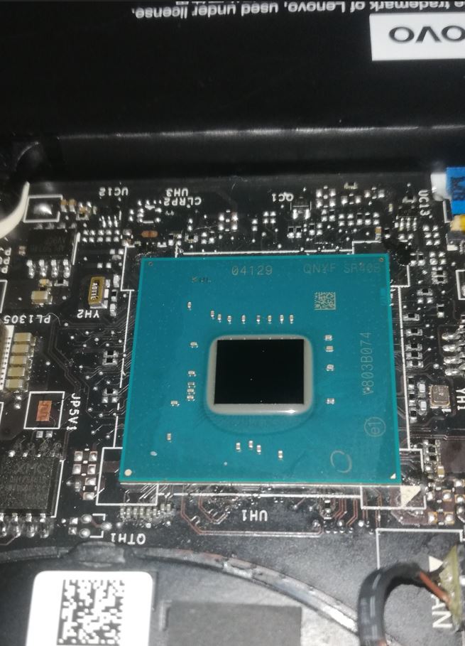

                            Alright the s740 is working, no touchscreen tho, just as a regular laptop, I got it with a 3v power supply exploded, among other failures, so I'm quite happy tbh (it just gets pretty hot sometimes-->small heatsink), thanks to mon2 for the help
                            Click image for larger version  Name:	S740 3v power supply.jpg Views:	0 Size:	103.3 KB ID:	3716638 Click image for larger version  Name:	S740 new pch.jpg Views:	0 Size:	91.9 KB ID:	3716639 Click image for larger version  Name:	image.png Views:	0 Size:	473.3 KB ID:	3716640

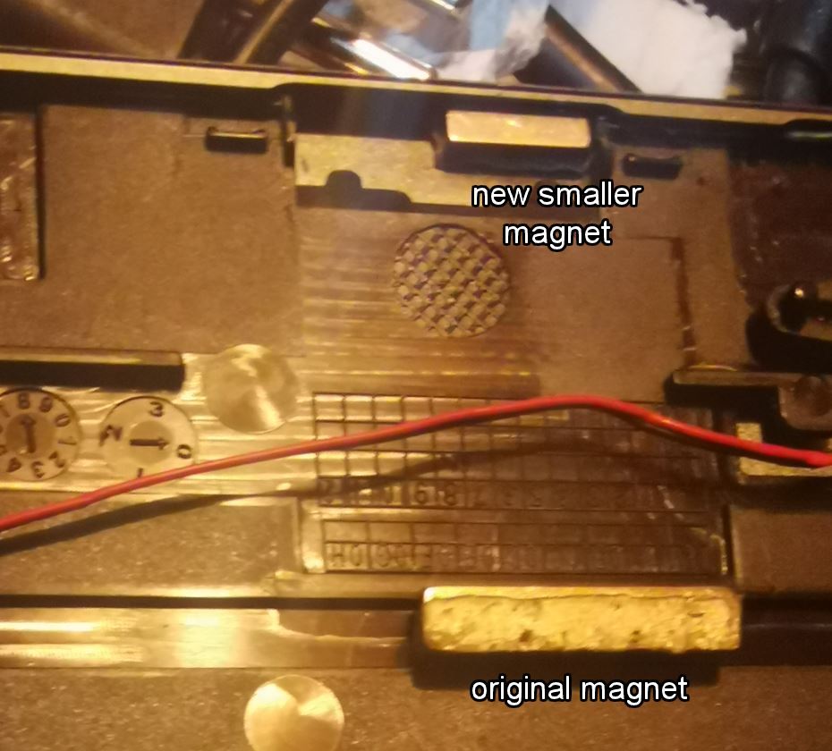

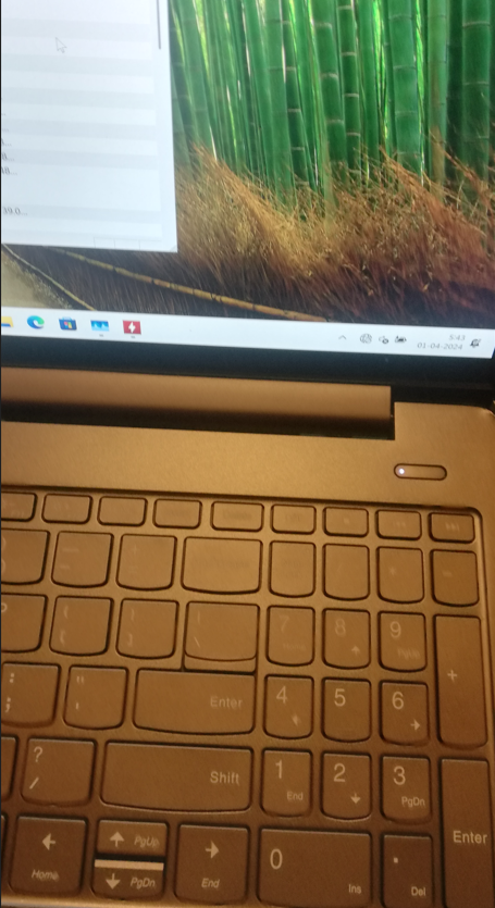

                              Well I got one last issue, when I close the cover it won't turn on again, the little led just keep flashing normally, I have to disconnect all the power and turn it on again, also when it enters in suspension on windows also won't turn on and when I turn it off, and close the cover and plug the adapter, then open the cover and try to turn it on, also won't. I'm guessing the hall sensor, do you have the schematic or that part, so I can check it? My last option would be some ball under the pch got faulty, but gotta check hall sensor first.

                                Alright, after this nightmare, I finally fixed the lid sensor issue (hall sensor) and probably found out why this is as massive as it's, literally a lot of people online having the issue of black screen after they close their screen on devices with only months of use, sometimes no backlight and as solution people tell you to press the on/off button for 30s, or do a cmos reset, which works, you discharge the system, but once you close your laptop, the issue returns.
                                First of all the lid sensor is located on the right side of the webcam inside the screen (on lenovo S740), so pretty hard to get there (not like this is the main issue tho). So the magnet is nearby the trackpad. this is very strong and too long and tend to mess with the lid sensor when it gets very close to each other (when you close your device).
                                Knowing this is not hard to fix the issue, it took me hours to get to the there tho, so you have to find a smaller magnet, in my case checked that on the right side of the lid sensor had less effect, so less probably to screw the sensor on top, so I put it there (picture)
                                I hope this might help someone who is having this kind of issue.
