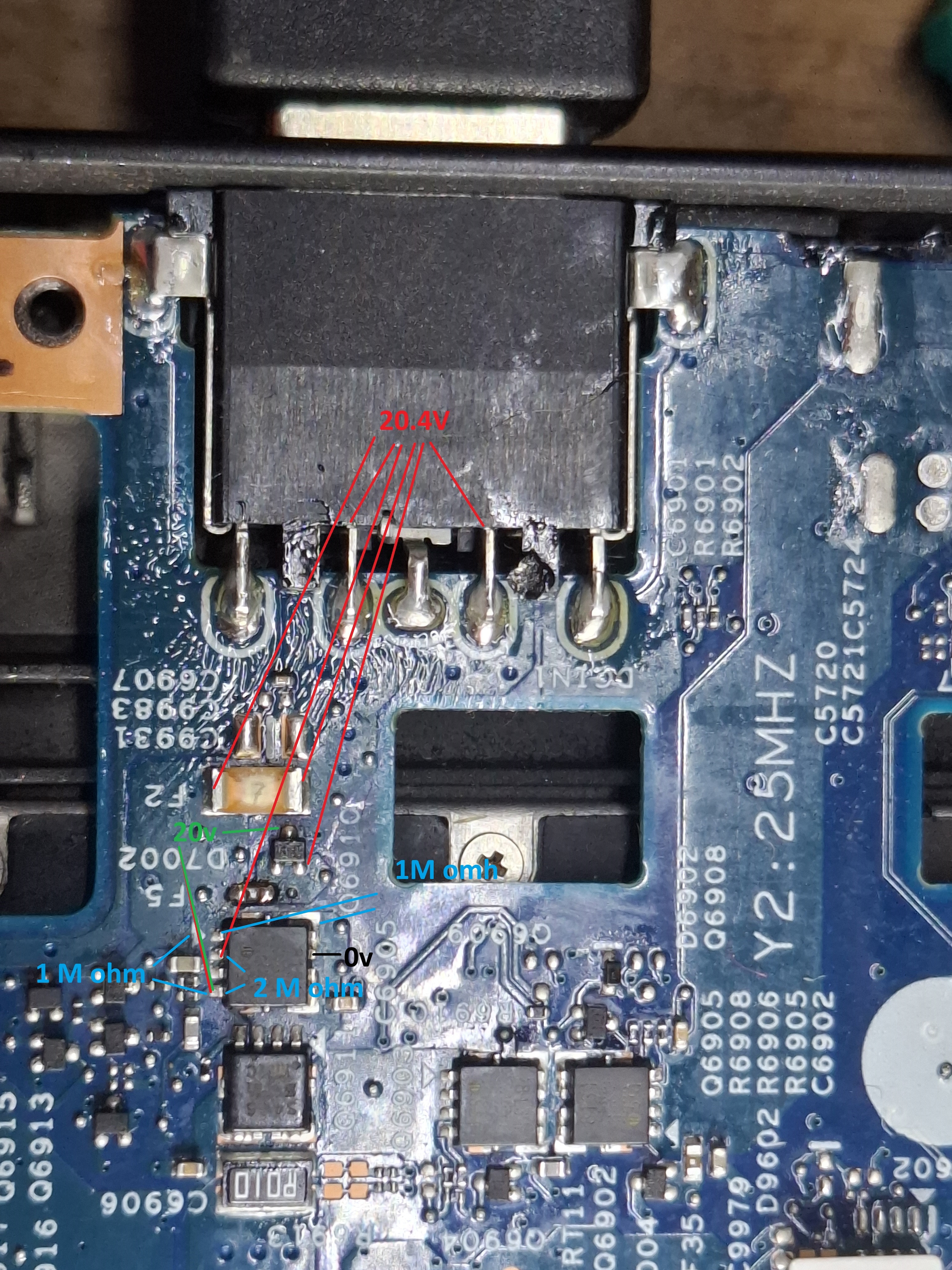

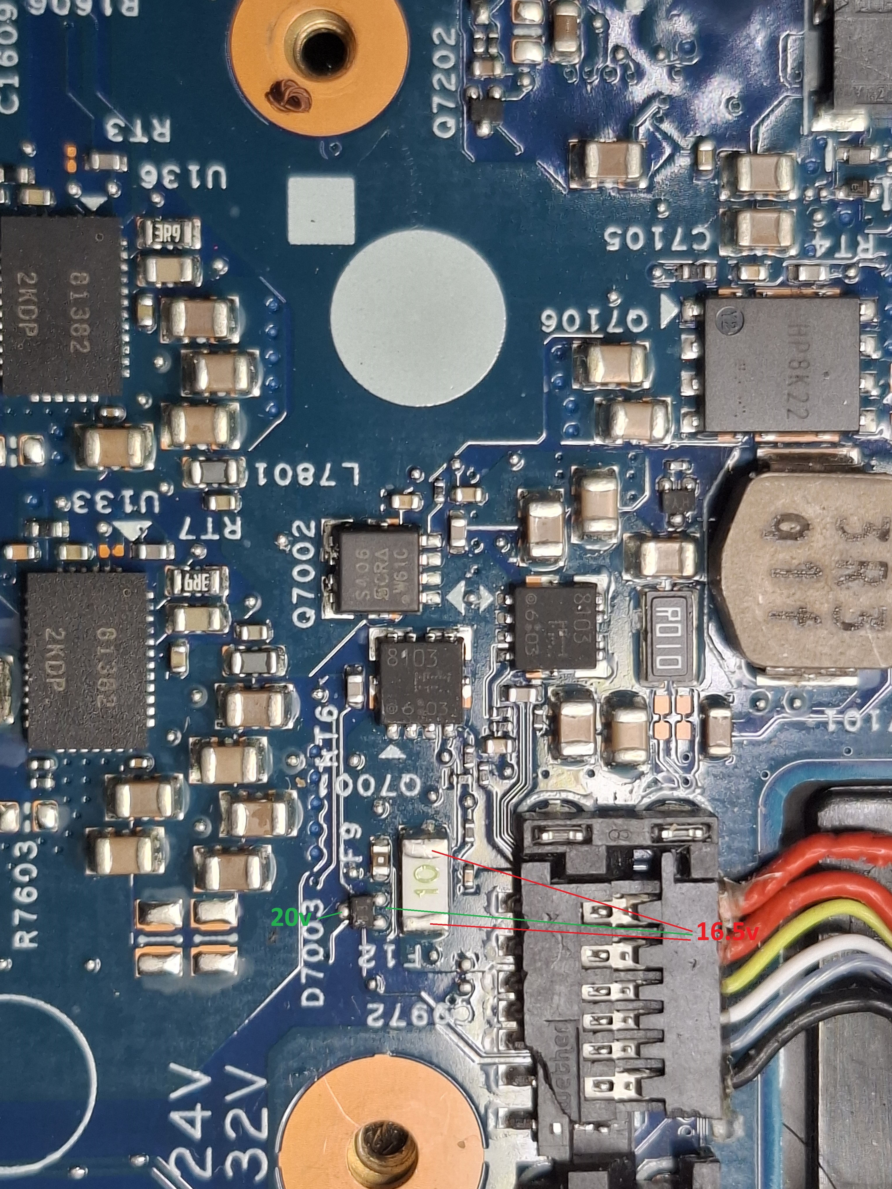

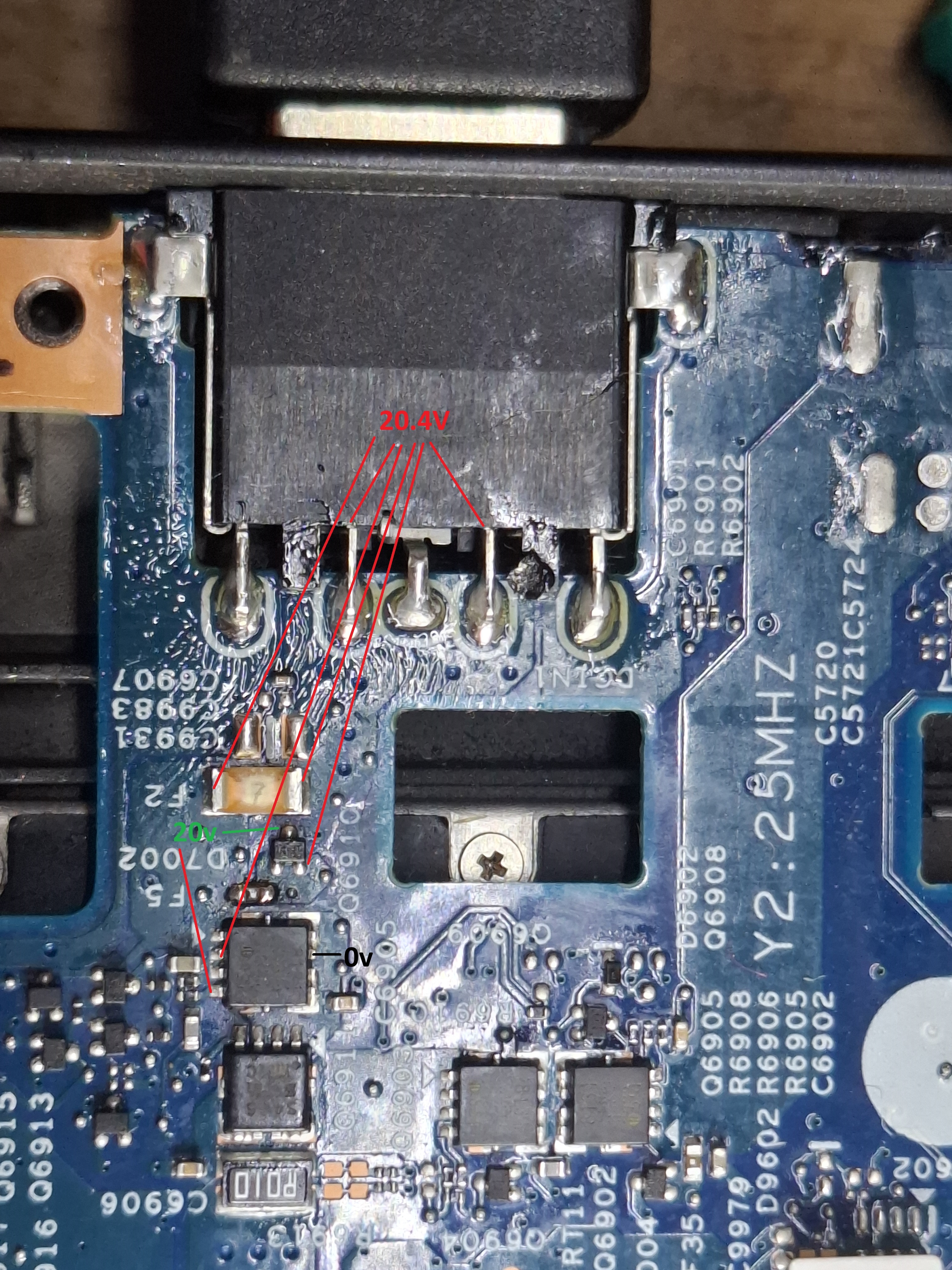

    I´ve a Lenovo x1 carbon gen 4th, 14282-2m lrv1 mb, wich don´t power on.
    I´ve upload initial voltages, in two images
    somebody know, where to begin?
    I´ve found some brd view and a pdf
    Thx in advice!

    Hi.
    1) review the charger bible by piernov that is linked above.
    2) the dcin mosfet with 20v is a suspect. Share the part # on this mosfet. Most likely to be defective.
    To confirm, remove all power. Meter in resistance mode.
    Measure the resistance across:
    source / drain
    source / gate
    gate / drain
    Post all measurements. Each should be hundreds of k ohms or higher else may be defective.

      Thx for your answer mon2!
      The diagram says:
      Q6910
      TPCC8131-GP
      source / drain = 1 Mohm
      source / gate = 1 Mohm
      gate / drain = 1.2 Mohm
      • Xiran
        • Jan 2019
        • 49
        • Qro
        Everything seems to point to damage to the processor... checking for shorts, the data lines of 2 USB ports are in low impedance, I trace the lines, remove connected components, but the short persists, the line now goes directly to the processor
