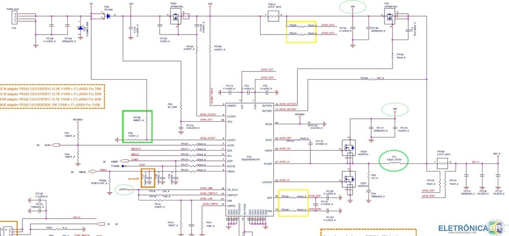

    Hi, everyone!
    Analyzing the input circuit, the first MOSFET had 19V at the drain and 0V at the source, with a 0V gate.
    I replaced it and nothing. I injected voltage into the missing side, and the laptop turned on.
    I found that the BQ24780s has 19V at VCC, 2.79V at ACDET, 0V at ACOK, and it varies in millivolts on the ACDRV pin.
    Could it be the cause of the problem?

    Review the 2nd dc in mosfet. The gate pin of the first 2 DCin mosfets are often shared. If one becomes defective, the other one also suffers. It the 2nd one that is the first suspect.

            Have you seen this video?
            https://www.youtube.com/watch?v=6x9W...INFOTEC-ARLENO
            Partial schematic(?) from a user forum referencing his same unit (out of Brazil):
            Click image for larger version  Name:	partial_schematic.jpg Views:	5 Size:	96.8 KB ID:	3703739
            https://eletronicabr.com/forums/topi...osfet-de-alta/
              I saw this video, but in my case I have ACDET (2.79v), but no ACOK (3.3v).
              I also don't have (it varies in millivolts) ACDRV, ACN and ACP

                Does this partial schematic match your board? If yes, which mosfets have you tested?
                • G_sene
                  No, my motherboard is 02737A
