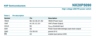

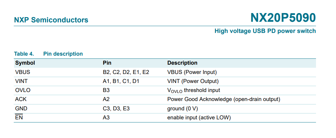

    I have an E14 Gen 4 AMD that shows no signs of life.
    When connected to the charger the board initially drew 30 mA at 10 V.
    The thermocamera showed a hot spot at one edge of the PD controller. I therefore replaced the PD controller, after which the board drew 5 mA at 20 V.
    Further investigation revealed that the power switch UT5 (NX20P5090UK) was not activated. The EN# signal is missing. This is supposed to be generated by the PD controller.

    UT5 (NX20P5090UK) was not activated. .The EN# signal is missing.
    There is another case of the same issue from last week here on this forum.
    What is the exact voltage to ground of the EN# signal?
    • rumpumpel1
      • Jul 2019
      • 162
      • germany
      The EN# signal has 3,2V to GND.
      • mon2
        • Dec 2019
        • 14659
        So the load switch is DISABLED. This line needs to be LOW = 0v to enable the load switch.
        In the other case, this load switch was defective. The ENABLE was active yet the voltage did not pass through.
        Measure the voltage to ground of the output of this load switch. What is the resistance to ground?
