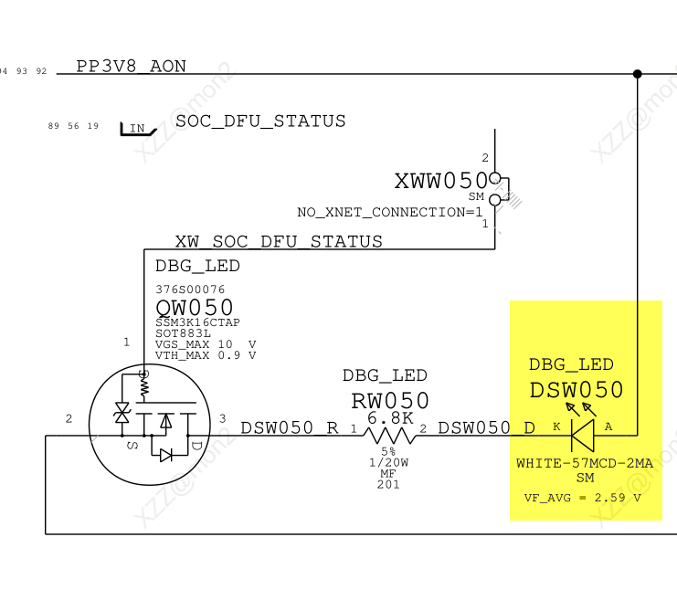

        also, I checked SOC_DFU_STATUS and it's around 1v. does that mean it's in DFU mode and that would explain the 5V instead of 20? I don't know much about it

          https://boards.rossmanngroup.com/thr...fu-mode.63954/
          If machine is in DFU mode, then SOC_DFU_STATUS wil be high.
          0V means the machine is in normal state, not DFU.
          To me, this logic level is too low but can you confirm if there is a status LED @ DSW050 on your board? This LED will enable if you are in the DFU mode.
          The logic level will enable the mosfet and the mosfet will sink the current required to enable the LED to be visible.
