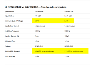

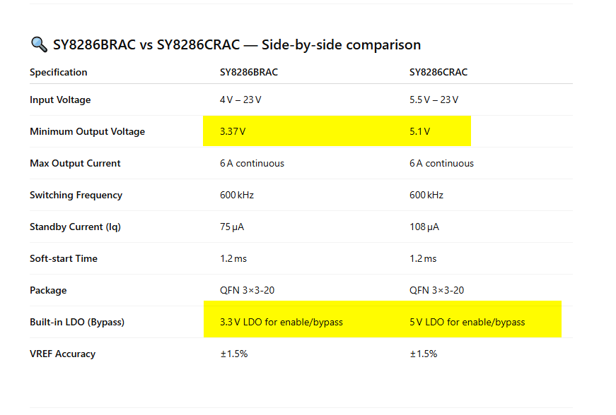

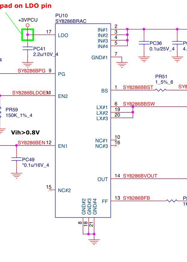

    Can you link a schematic (inside the schematic forum only)?
    Yes, it appears that the root cause is on the 3v3 buck regulator who is being requested to turn on through the EN pin.
    Root cause is that the replacement regulator is not compatible to the original.
    See attached.

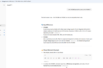

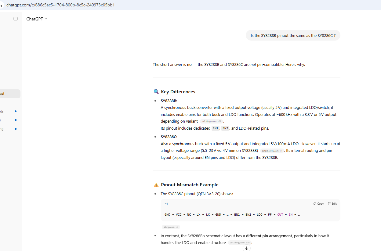

      hello, However, I asked chatgpt and he told me it was compatible. I put the original one back, unfortunately I don't have another one, but if FB is at 0v, it may not be the chip that is the problem, right?

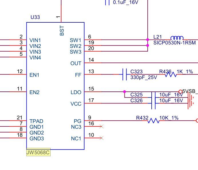

        I couldn't find a schematic for this motherboard dag3BAMBAH0 REV H
          • 20656
          Originally posted by madjid911
          I replaced the 3V3 chip (SY8286C awv7YD) with the SY8288B and the JW5068C, but the result is the same.
          (SY8286C awv7YD) ? AWV*** SY8286BRAC . The JW5068C isn`t compatible.

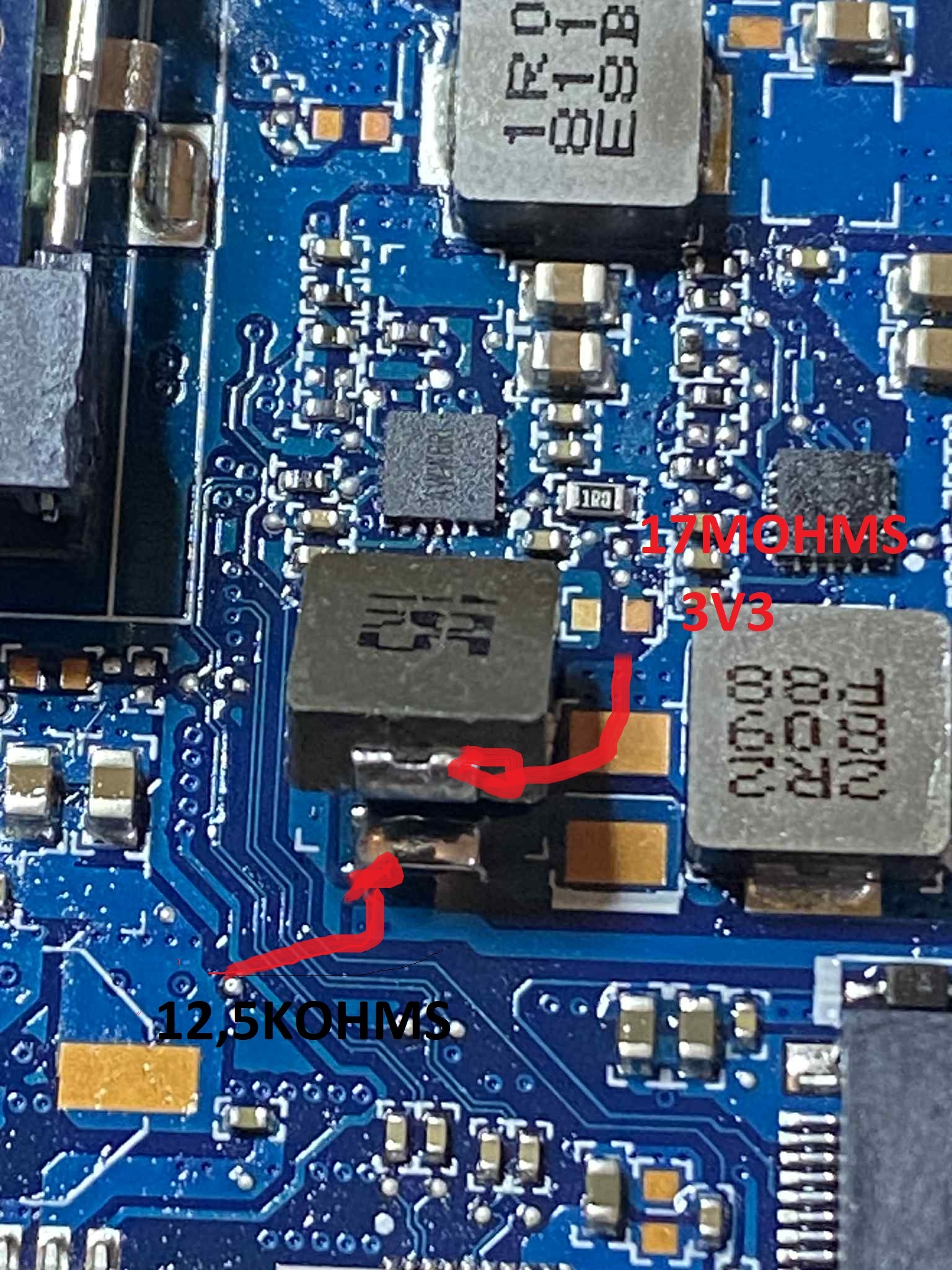

                        I am surprised, I have the 3V3 at the output of the 3V3 coil but unsoldered, so when I connect it I drop to 2v, something must be wrong yet the resistance at the coil output on the motherboard is good
                        • madjid911
                          • Dec 2016
                          • 383
                          • France
                          I can't find any shorts though, so when the coil is connected we have 2V instead of 3V3 Click image for larger version

                            The completion of the circuit is causing the drop in voltage.

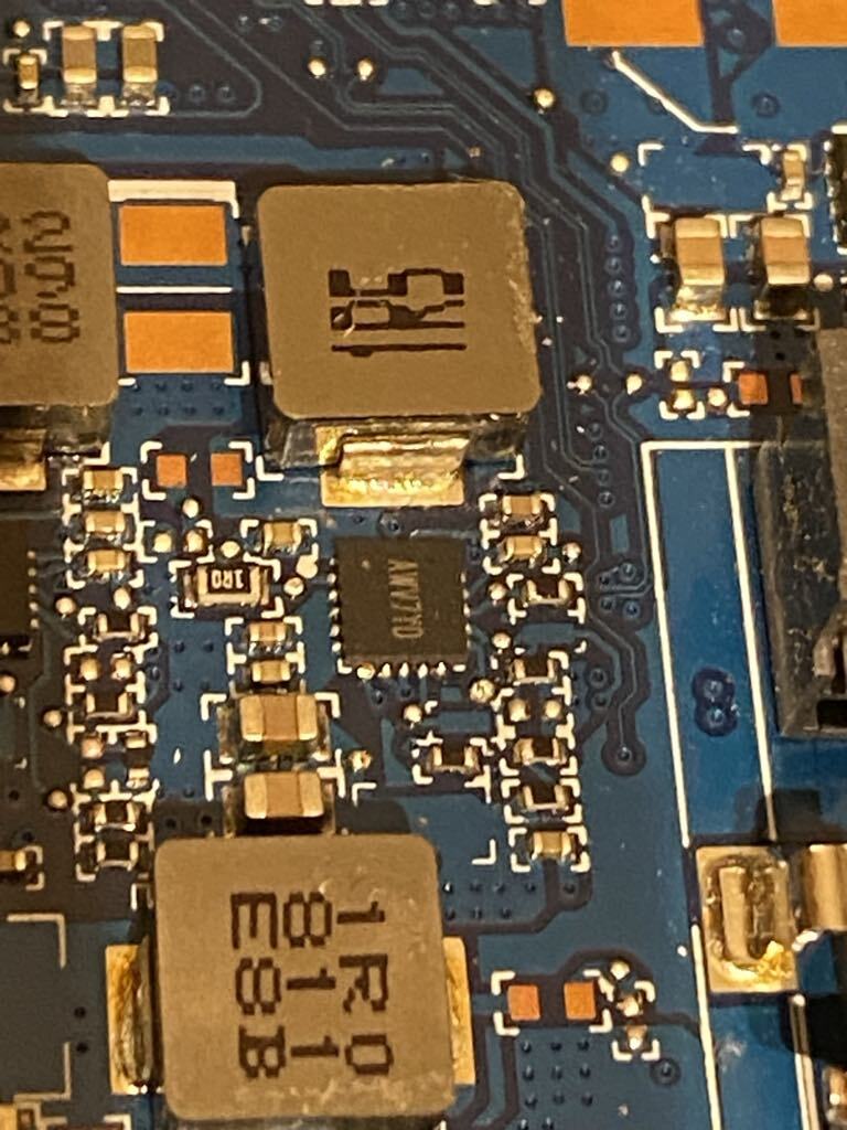

                            Post again which part was replaced. What are the full markings of the original part and the replacement part used onboard here?
                            Post a clear topside view of the replacement part for a review.

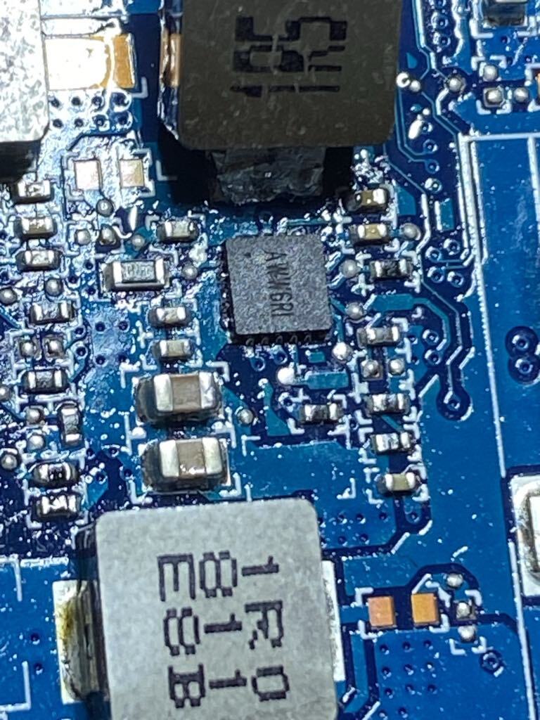

                              and I have 0V72 on the track of the good unsoldered on the motherboard it is not normal to have voltage coming from the motherboard on the coil
                              • madjid911
                                • Dec 2016
                                • 383
                                • France

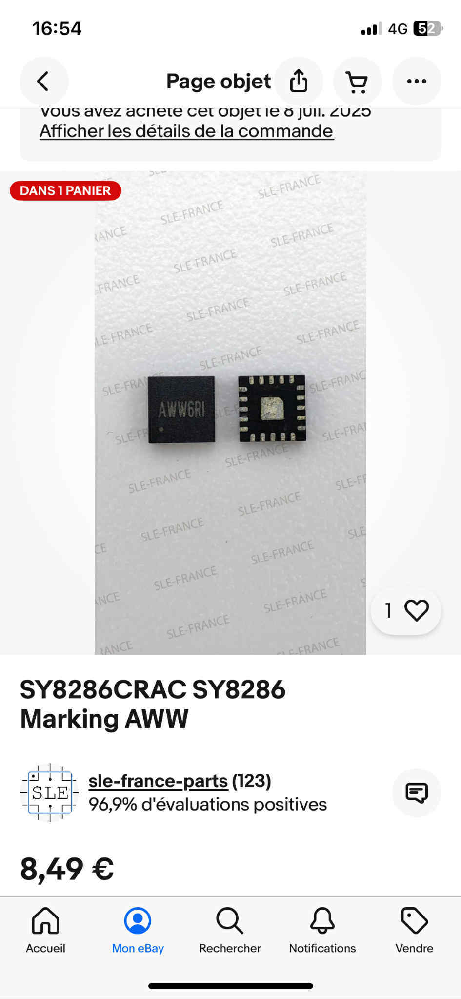

ID:	3680117 Click image for larger version
                                the first one is the original one, it's AWV7YD (SY8286CRAC), the second photo is the one I ordered AWW6RI (SY8286CRAC according to the photo on ebay)

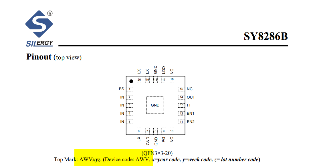

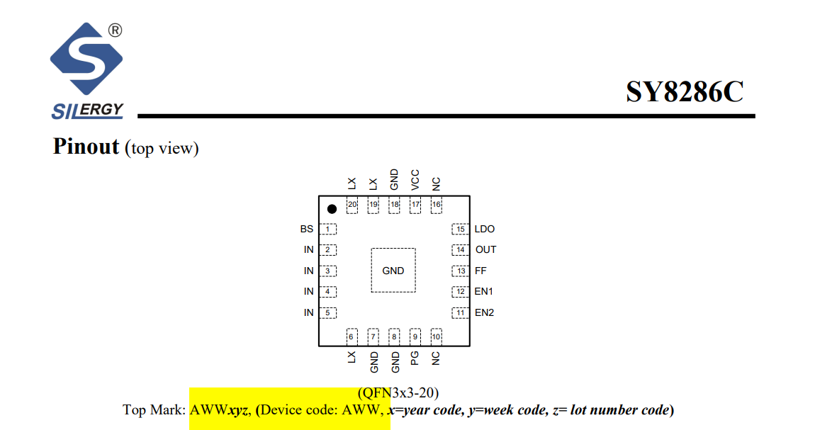

                                • mon2
                                  • Dec 2019
                                  • 14001
                                  These 2 parts are not compatible. The original was SY8286BRAC; the replacement is SY8286CRAC.
                                  See attached.

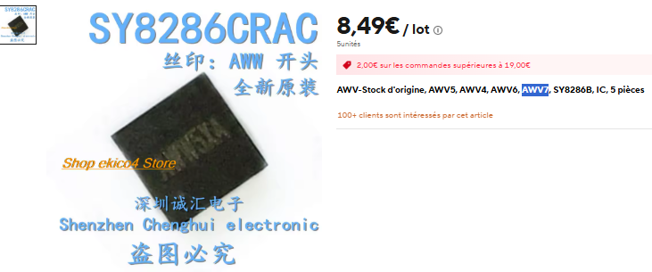

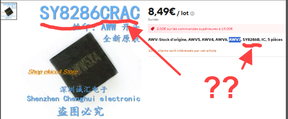

                                  • madjid911
                                    • Dec 2016
                                    • 383
                                    • France
                                    Thank you for these details, however I had seen that on Aliexpress the reference AWV7 corresponded to the SY8286CRAC Click image for larger version
                                    I will recommend the part then
                                    • mon2
                                      • Dec 2019
                                      • 14001
                                      The Aliexpress store is in error. Trust the silicon mfr's datasheet over the Aliexpress store. There are pinout differences as well - review the LDO rails and their pin location between the 2 models.
