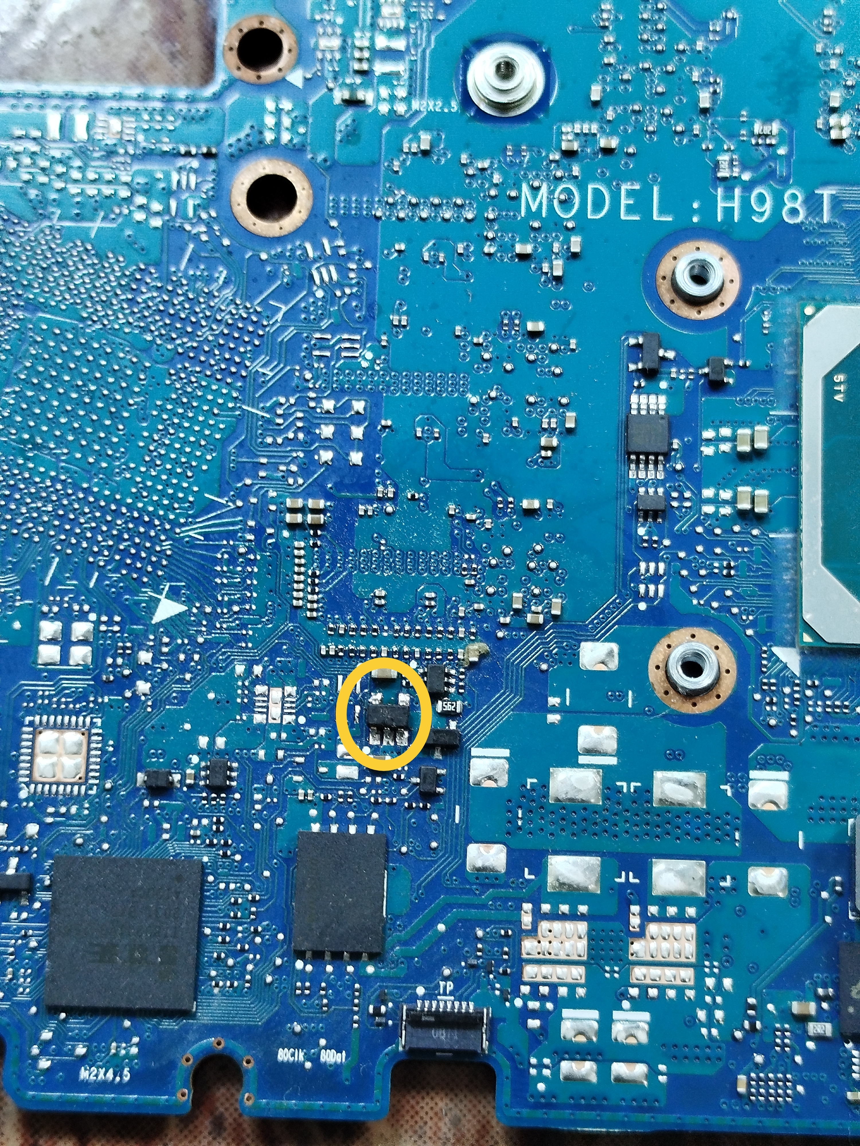

    Model BOD-WFH9
    Motherboard H98T DAH98TMBAC0 REV C HF
    no power and when connect power adapter I hear leak sound and the ic in the pic overheating I removed it and the laptop power on with no display .
    So what is this ic and can I bypass it ?

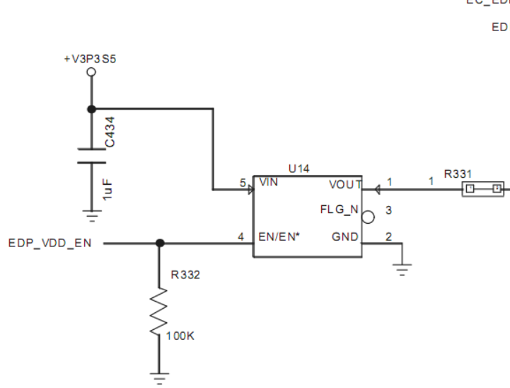

    Might be lcd panel vcc power switch, check pinout and output for low ohms and if it is connected to edp connector, change for same type.
