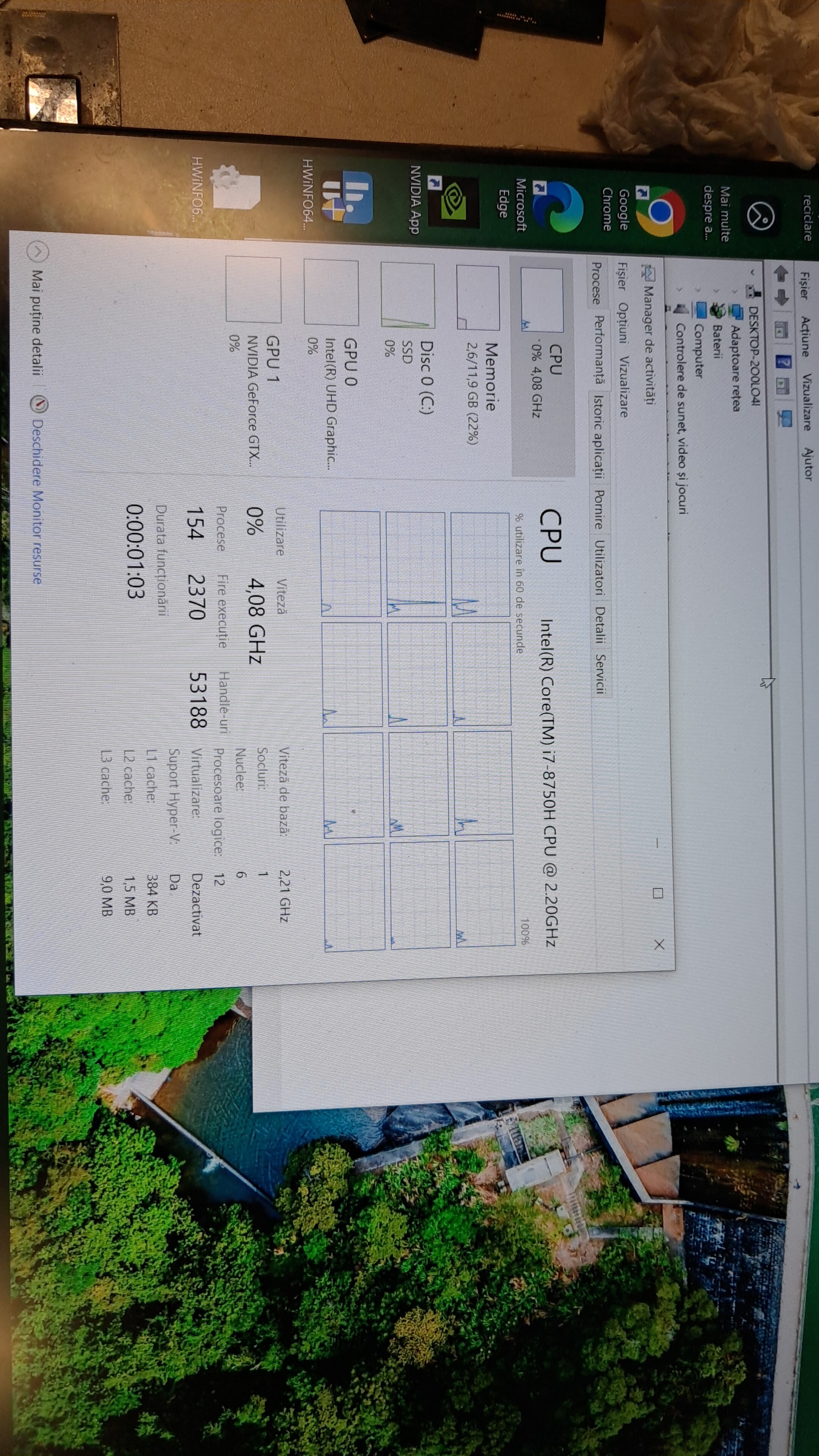

    Hello. I have a Pavilion 15 cx0006nq. My panel did not start all the time and when he start he flicker like in attachment. I change panel and edp cable, PCH, BIOS(rewrite). No changes. On hdmi image is ok. Can you help me with an ideea?

          Data lines comes from CPU. I pull out CPU and check traces. They are ok. I reballed back the CPU. Remaining CPU to exchange... its a i5 8300h. I think i can put a i7 8750h...
          Hope to not have problems with power supplyes..(for panel or CPU- noises or else). With a scope, signasl is clear.

            I put i7 8750h in place of i5 8300. Full succes and no flicker anymore.
            Can be closed this.😅
