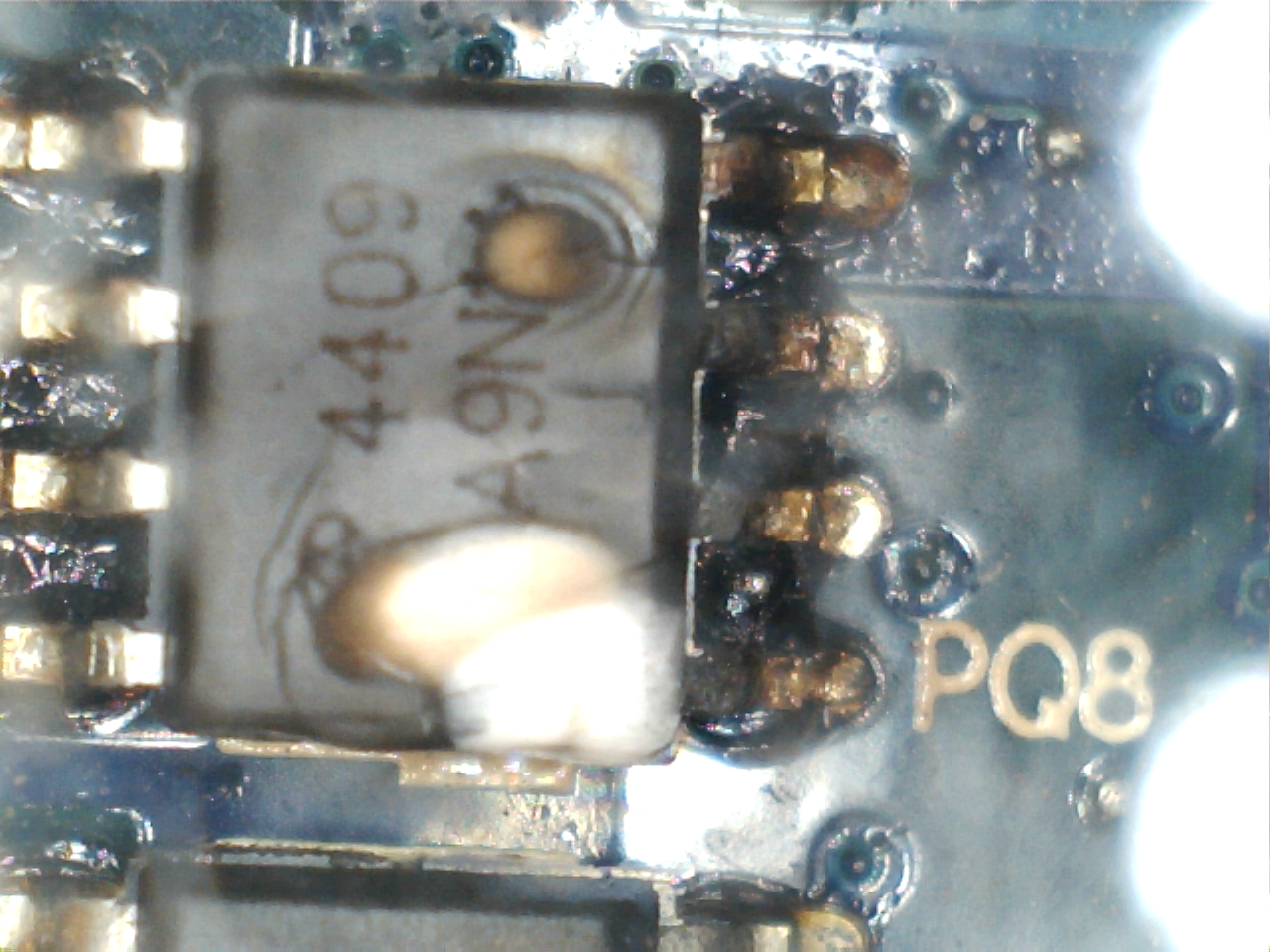

    Acer Aspire 5534-1096
    The power jack was replaced but noticed that PQ8 Ic was burnt can only read partial number of 4409 and A9N something. dont know if its 11,14 or 17

    Re: Acer Aspire 5534-1096
    this P-channel mosfet no need to read partial number..!! this is AO4409 mosfet..
    you can replace this mosfet..with some other number also AO4407,AO4435..!!
      Thanks. I will try to find one in US, if not China!
        The IC came in from China. I replaced it and it works fine . Thank You Kuldeep for the part number.
