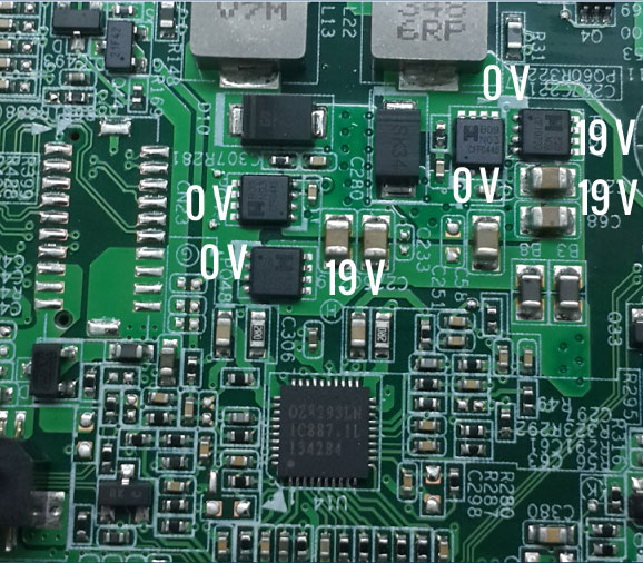

    Dear friends i have this Advent Torino Z200 from my customer who spilled vine on it. opened it and clean the vine spilled on some parts. the laptop charging and the red light is on when its charging. But there is no 3v nor 5v thus it not opening with or without battery. There is this chip named OZ8293NL responsible from 3v and 5v (i think so because i dont have the scheme). i attach the pictures also. Also i cannot find the scheme of the laptop nor the 3v 5v chip. There is 19 v suply for the chip. Any help would be appriciated. Thnks

    When i measure the tension between the coils to the ground it 9 ohm. is this normal?

      topic closed there was short circuit on the motherboard. cleaned and everythin is ok
