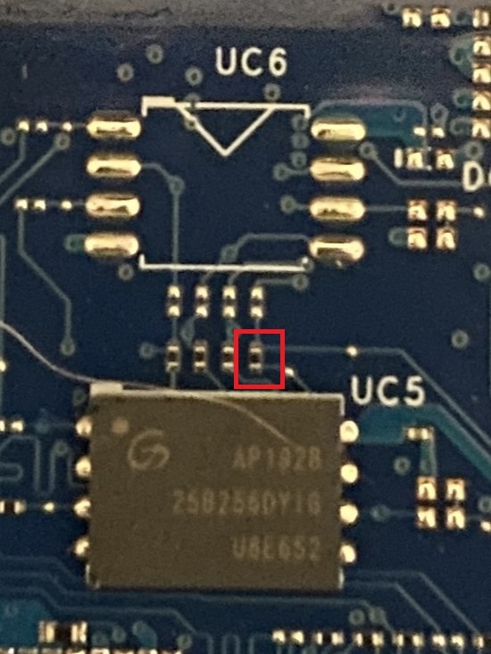

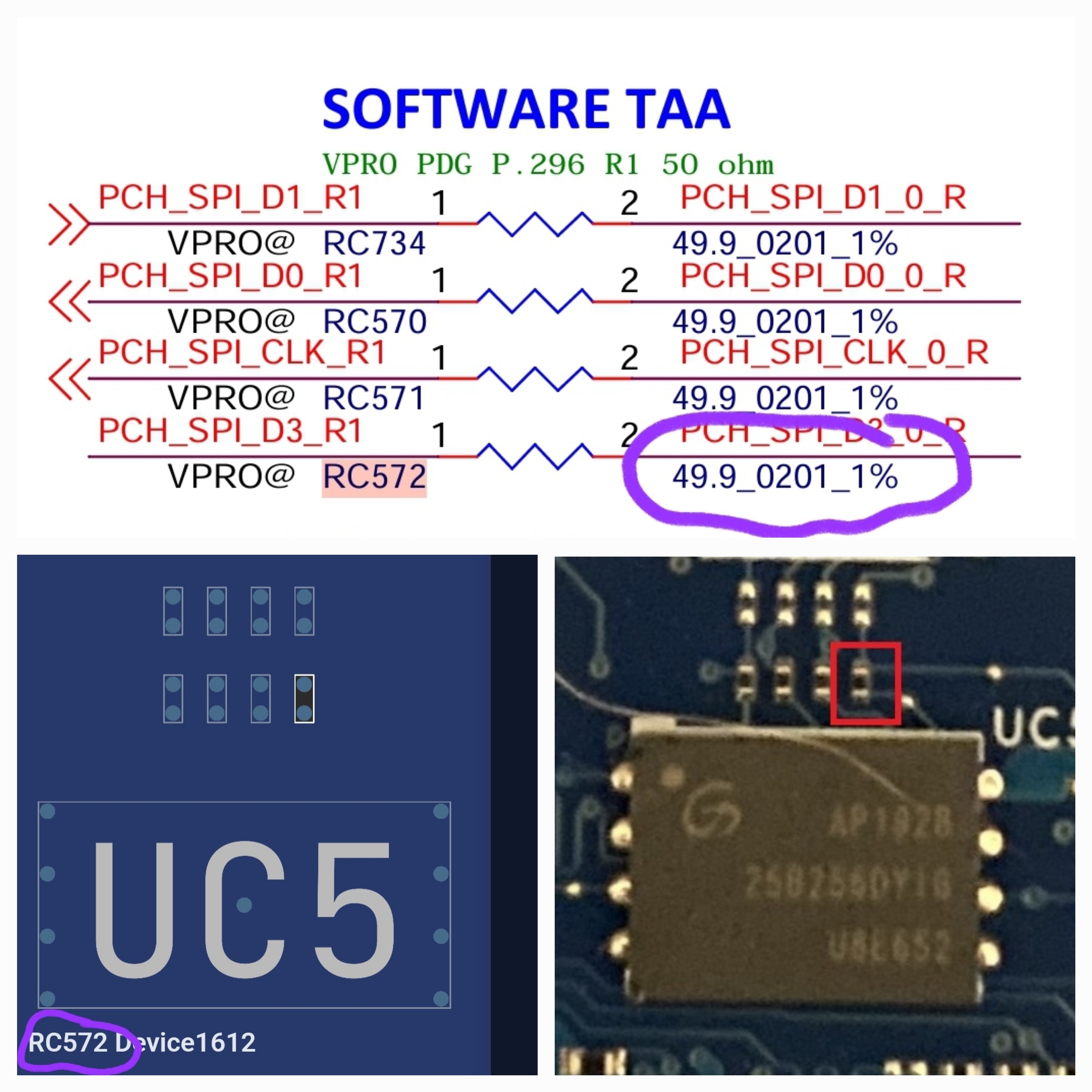

    I was trying to remove bios password from my dell latitude 5400 by removing and programming BIOS chip and i accidentally blown away 1 part above the BIOS chip which i think is a resistor. I looked at boardview of it and i came to a part R_0201.
    Can anyone help me figure which part should i order to fix it or will there be any workaround to run the laptop.
    I have attached the image of the part which i am missing.

      Boardview and schematics are available so I don't really understand the problem here.

        Thanks for your reply. I am really new in hardware and i don't know much about all the components .
        I wanted someone to confirm on what part i need to order to fix my laptop.
