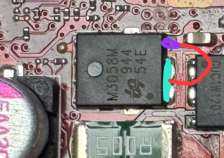

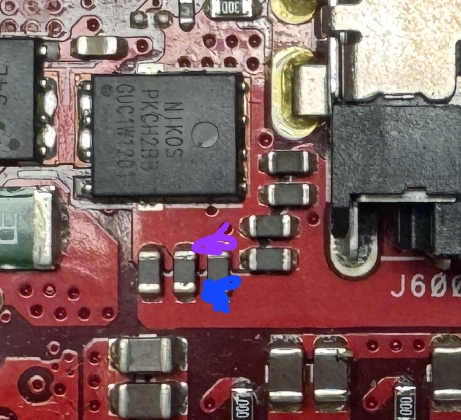

      Picture of the area with the DC-IN Mosfets and of the charging controller including surrounding circuit please.
      Or are you able to find and measure everything on the base of the designations in the schematics?
        Not super strong with reading schematics, I get lost pretty quickly.

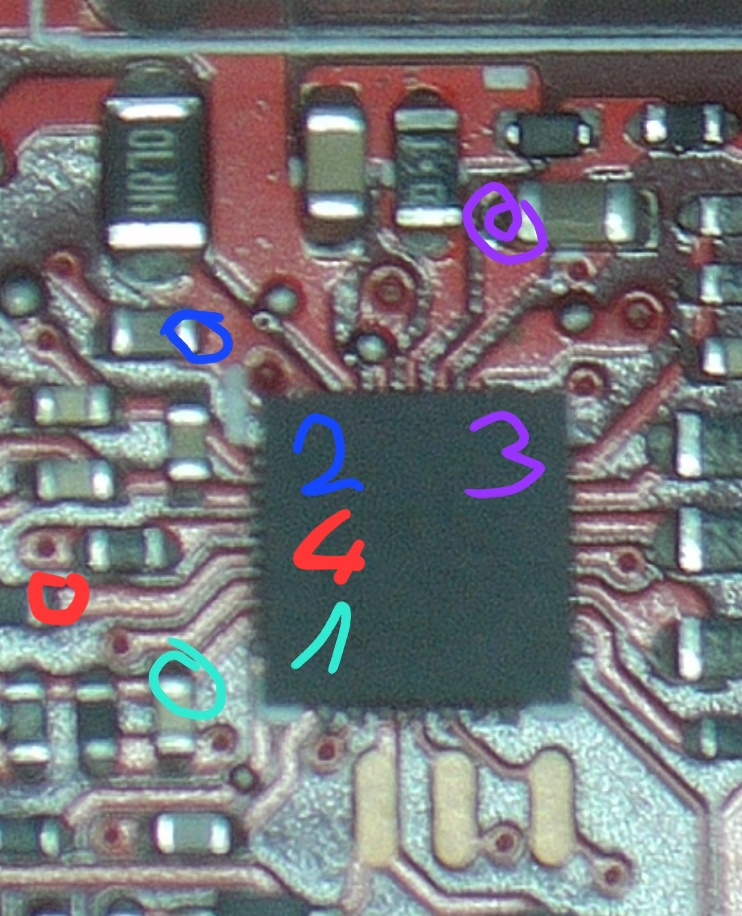

          Then picture of the charging controller and surrounding circuit too please. Should be a BQ24780S iirc.
          Edit: And resistance between these two points please (Source and Gate) to start with.
Name:	Screenshot 2025-06-06 15-22-49.png
            2.176Mohms
            • Sephir0th
              • Oct 2020
              • 1289
              So the DC-IN Mosfets are most likely fine.
              Plug the charger and measure voltage at the following 4 points: ACDET, VCC, REGN and ACDRV. Pay attention to not slip with the probes.
                All are showing 0v, everyone other than 3 is showing OL in diode mode.

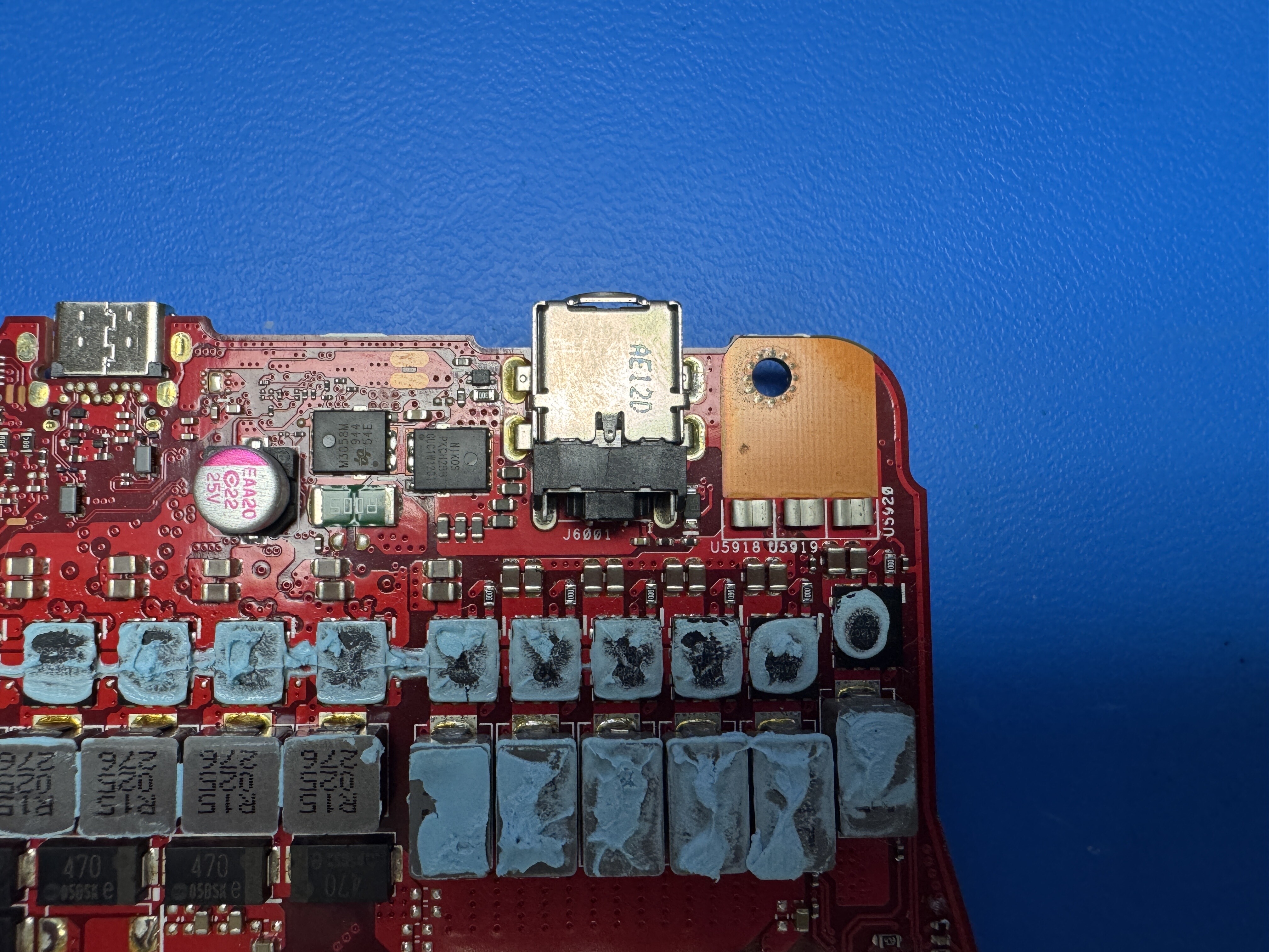

                          Using diode mode for resistance measurements is bad practice, since each multimeter works with a different test current which will result in different values who are not really comparable anymore. When you work with me, we will always work in Ohms mode, even if it is a MacBook...
                          However, when you say, the charger is working, then the DC-IN Jack must be faulty (Broken/Loose Pins/something else)
                          You are absolutely sure about that? Double-checked your GND, etc.?

                            I will order and replace the DC-IN jack and we can go from there. I think that is the best case scenario

                                    Hey, I got really sick so sorry for the late reply. I did go ahead and swap out the charging port and it did resolve the issue. Not sure why, but it works now! Thanks for all of the help, I really appreciate you!
