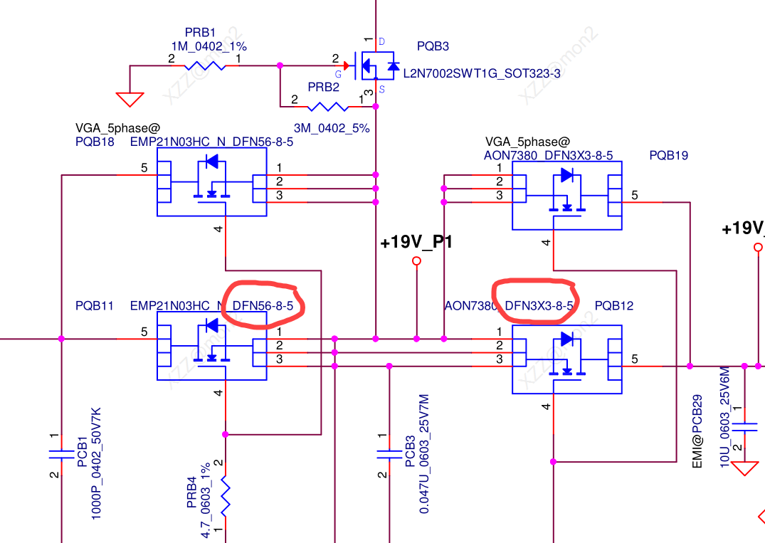

Acer Nitro 5 AN517-52-56A5 - won't charge, shorts the AC adapter

    Yes the removed mosfet is 100% defective.
    The second mosfet also looks to be in trouble. Replace it as well. Measurements are too low.

      Thank you, so I need to order a replacement for it. Will SIS412DN be a good replacement for B09N03?

        Can you confirm if the 2nd mosfet you have tested is @ PQB12 silkscreened area of the PCB? The body size of PQB12 should be smaller that the first DCin mosfet.

          Yes, it is definitely smaller and it is PQB12. I have just removed it. It seems to have 3x3mm in size.

            The replacement is 50% lower current than the original. 12A vs 24A. Would you have other options? Otherwise the part is suitable and also 3*3mm.

                  AON7380 did the trick - it is not sold by the store I'm about to order MDU1511 from, but I can order it for a little price from a different seller.
                  So, to sum up, I will order:
                  - AON7380 for PQB12
                  - MDU1511 for PQB11
                  I will do it now, when it arrives I will attempt a repair, hopefully the PC will boot. I will update the thread for sure. Thanks!

                      Actually, I found a store (TME.eu) that has AON7380 in a very good price. They also have AON7318. Which one would you recommend?
                      I see that PQB11 is EMP21N03HC, which I was about to replace with MDU1511. That store doesn't sell MDU. Any replacement from AON? For example they have:
                      - AON6512
                      - AON6560
                      - AON6500
                      I only checked 115A and higher, because the datasheet I found for EMP21N03HC says that its drain current is 100A, but I'm not sure if that's true. They also sells lower currents from AON.

                        Select the part with the highest current. We are all seriously in trouble if the logic board truly consumes the peak current value but there is the brief in-rush current that is of concern for the selection process.

                          Hold on guys before jumping to order these mosfets. have you checked the resistance to GND on CLR located just after these dc-in mosfets?
                          I beleive it'll show short to GND. Adapter is no more shorted 'coz you removed the mosfet.
                          So do check whether your 19v rail is still shorted or not. Else the new mosfet will get shorted again.
                          Usually whenever, +19V rail gets shorted, the dc-in mosfet also gets shorted. So i beleive your +19V rail is still shorted.
