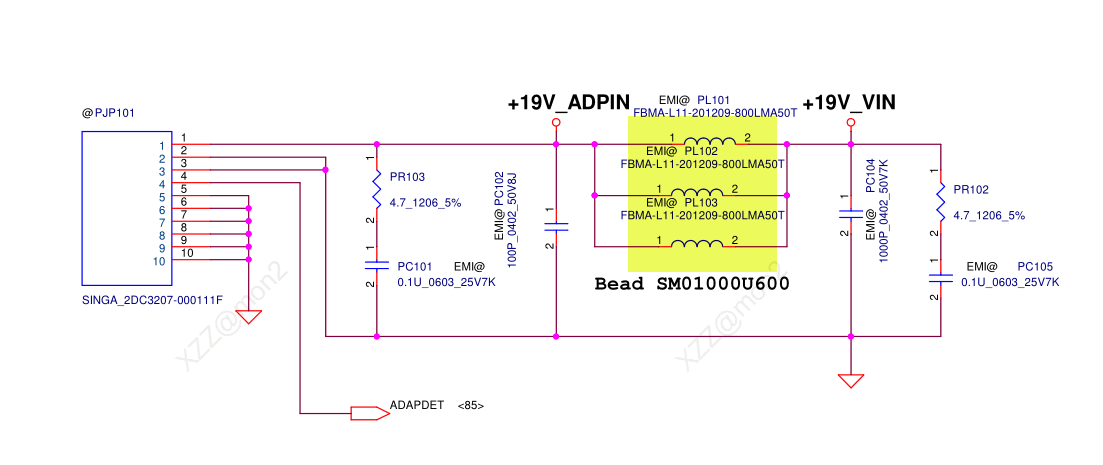

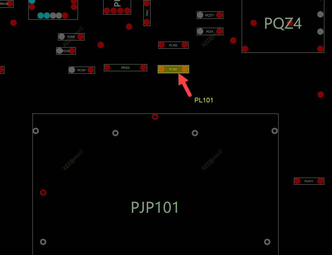

    See attached. Remove all power. Meter in resistance mode.
    Locate the parts behind the dcin adapter connector. There are a few ferrite beads (coils) behind this connector.
    Place one meter probe (either color) onto the tips of the PL101 ferrite bead; other meter probe to ground (metal shield is ok). What is the resistance in ohms showing on your meter?
    We are checking if there is a short on the main DCin power path by testing the resistance. A low resistance is often bad.
    Click image for larger version  Name:	DCin_fb.png Views:	0 Size:	68.7 KB ID:	3627966
    Click image for larger version  Name:	PL101.png Views:	0 Size:	26.0 KB ID:	3627967

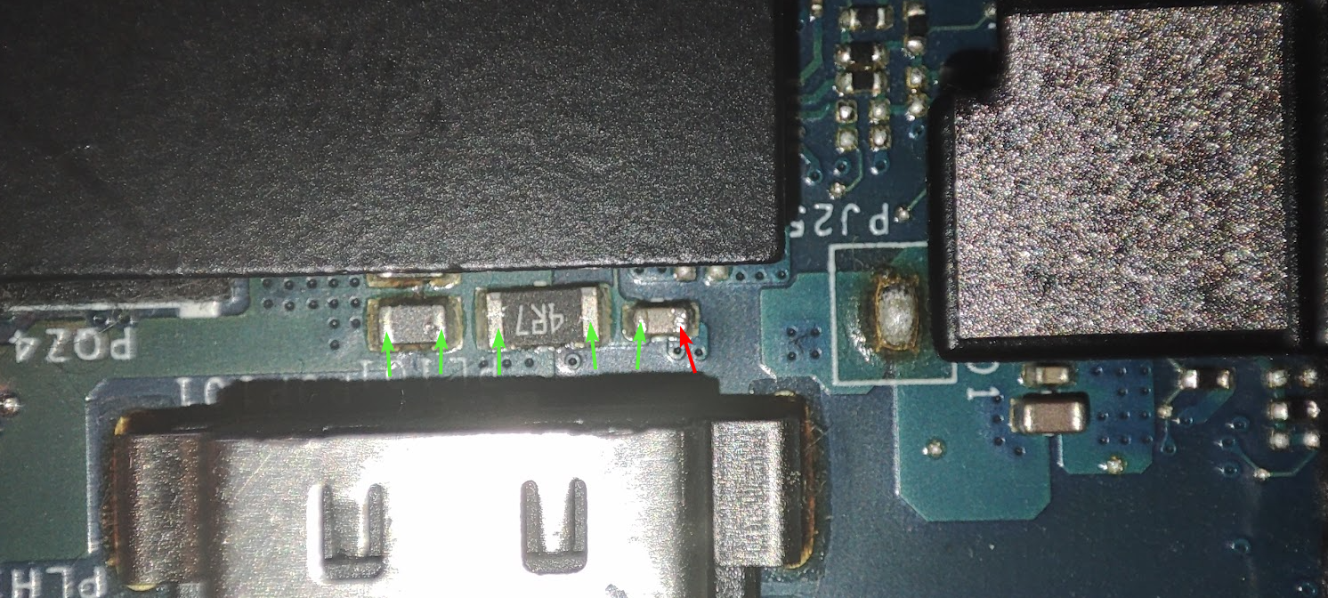

      So, I've put my multimeter in 20k Ohms mode and it showed following values - please see the image with arrows attached:
      1. Black probe on GND, red on arrows:
      - green arrows: 9.50
      - red arrow: 0.00
      2. Red probe on GND, black on arrows:
      - green arrows: 17.92
      - red arrow: 0.00

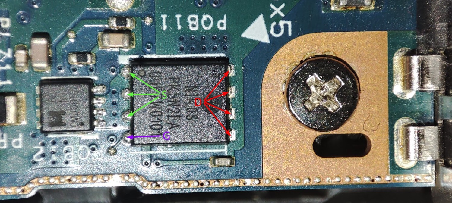

        I've been googling and reading about it and I think that the PQB11 MOSFET might be dead.
        I measured it in diode test mode and I get the following results:
        1. Red probe on source, black probe on drain: 0.000V
        2. Black probe on source, red probe on drain: 0.000V
        3. Red probe on gate, black probe on source: 0.621V
        4. Black probe on gate, red probe on source: 0.494V
        5. Red probe on gate, black probe on drain: 0.620V
        6. Black probe on gate, red probe on drain: 0.492V
        I'm attaching a photo with source, drain and gate marked according to my measurments - hope I haven't done a mistake here.
        Do the results I got prove that the MOSFET is indeed dead? Now I'm planning to remove the MOSFET and measure it while desoldered, also measure pads on motherboard. But before I do so, I would love to get some feedback and make sure that I'm following the right path.
        What I'm affraid of is that I've read on some other forum that if this MOSFET is dead like in my case, there is a huge possibility that CPU got 19V and is burned right now, meaning the notebook is basically dead. What do you think?

          Yes, the mosfet looks to be shorted. Flux and remove and replace this part. Double-check the mosfet after it is removed and on your workbench.
          Repeat the testing for the next DCin mosfet that is to the left of your picture. Confirm that this mosfet is ok or that it is also defective. The CPU risk with another mosfet that is the high side mosfet that mates with this main power rail. For now, do not be concerned about the CPU mosfet. The DCin mosfets are a common point of failure. Review the sticky article on charger circuits above by piernov for full details of your case.
          This defective mosfet can be replaced by many others from donor boards. Post details of the mosfet you pan to use as a replacement before soldering it into place. Use flux + hot air with low air pressure to prevent the loss of the tiny parts surrounding these mosfets.

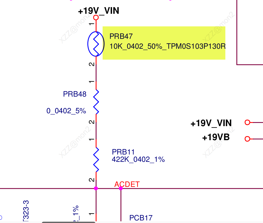

                        Thanks, will do it shortly. For now I managed to desolder it (that damn GND pad added me some gray hairs ) and it still shorts and there is no short on pads on motherboard, so I believe it really was faulty.

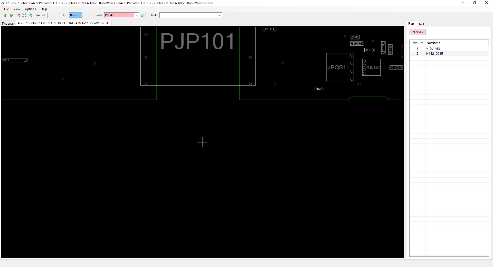

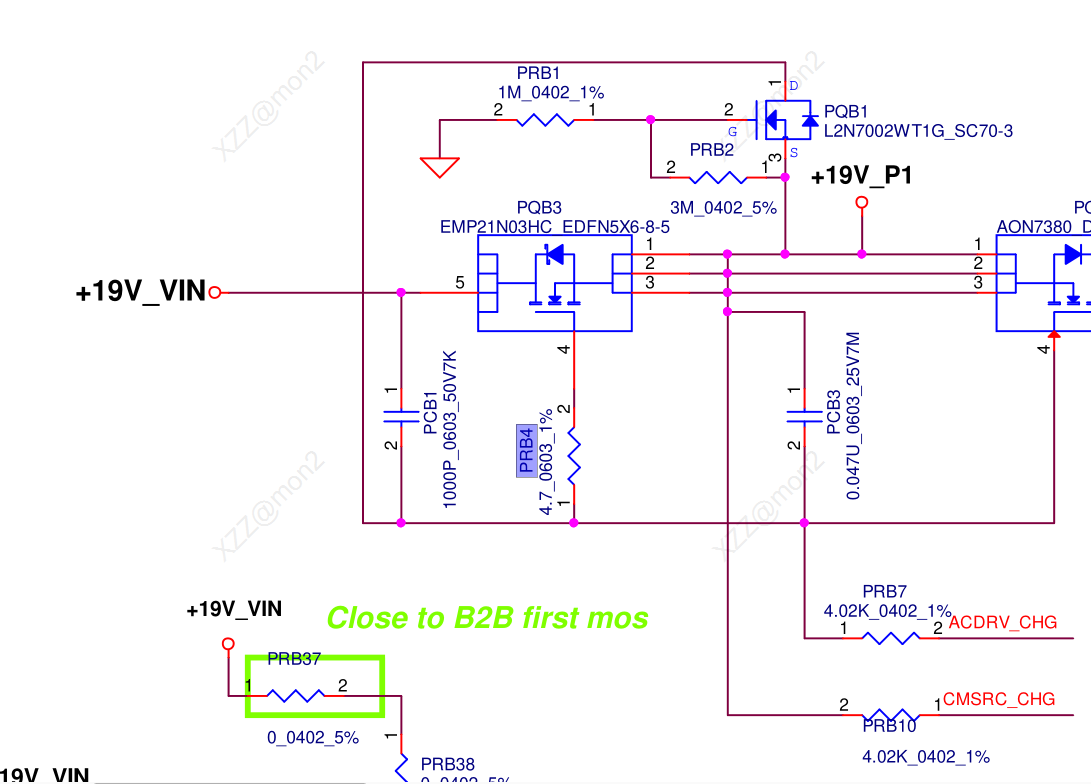

                        Unfortunately I accidentaly desoldered the PRB47 and I need to put it back in place. Can you please tell me if it's polarised and has to be put in the correct way or it doesn't matter?
                        Sorry for asking noob questions, but I'm not even really sure what is this. For now I believe that this is a resistor and I can put it back in place any direction.
                        • mon2
                          • Dec 2019
                          • 14575
                          Do you mean PRB4? Unable to find a PRB47 in the schematic. No polarity to resistors.
                          PRB4 = 4R7 ohms 0603 SMD resistor. Order a few of these if placing an order. Otherwise, replace with any value of 10-100 ohms here.
                          Click image for larger version  Name:	PRB4.png Views:	0 Size:	103.1 KB ID:	3629148

                            I mean this one, maybe I have a different schematics file?
                            It is really tiny, but I haven't lost it, so I will just try to put in in place.
                            I will come back with measurements shortly.
                            • mon2
                              • Dec 2019
                              • 14575
                              This part is a thermistor - acts like a temp sensor. No polarity but is required to be present else the logic board will have off measurements for the temps in this region of the board.

                                Thanks, I managed to put it in place.
