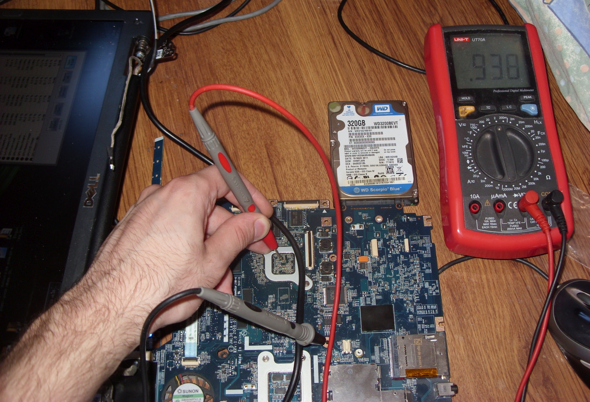

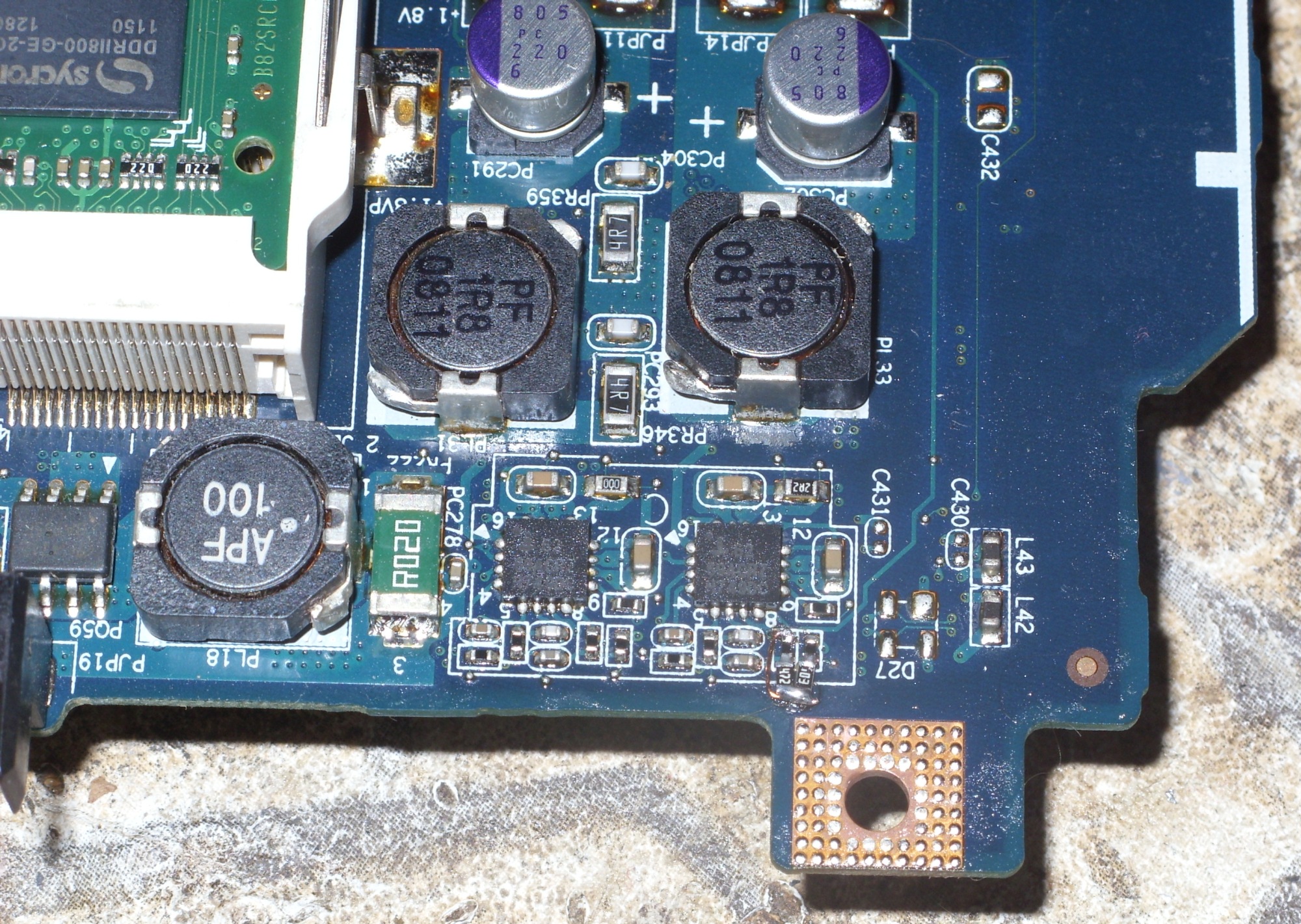

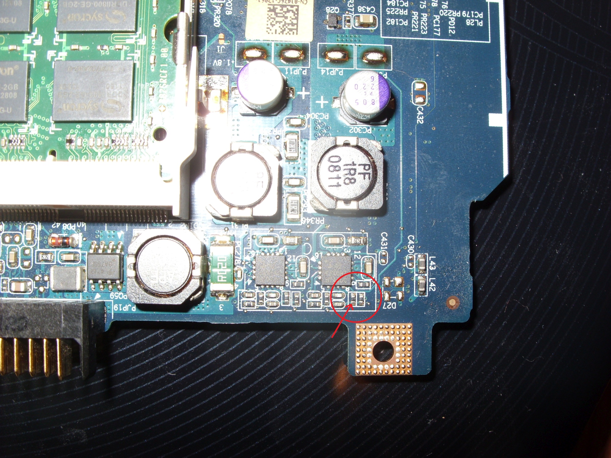

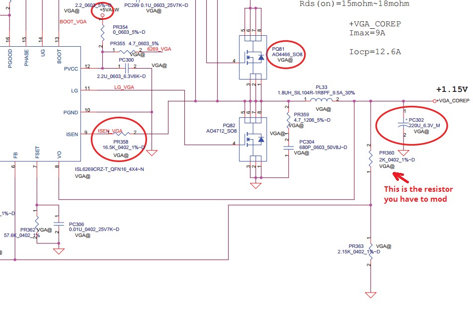

    And here's another one. Same laptop with this, now even cooler.

    Just did another one tonight with the exact same values of resistors. Runs like a dream. A third one is due in the next few days...
