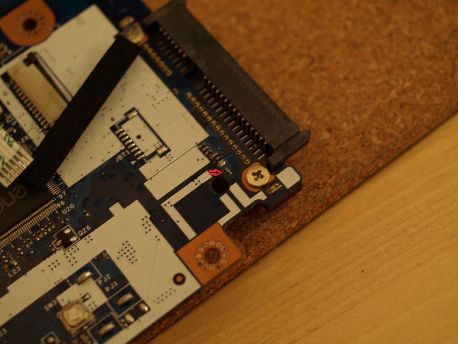

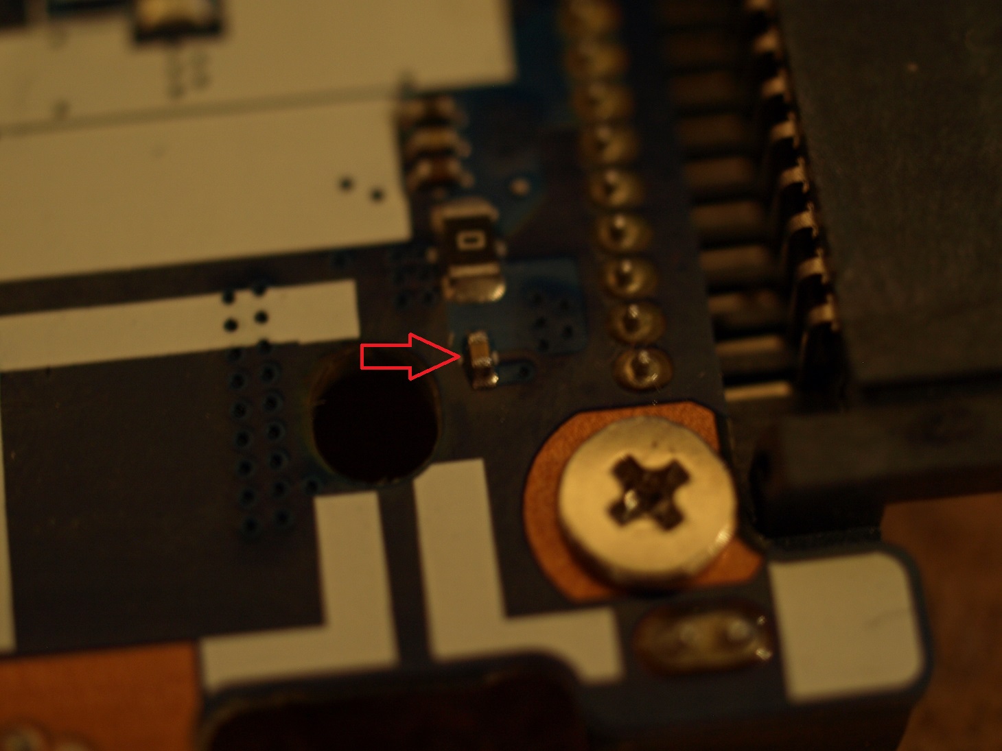

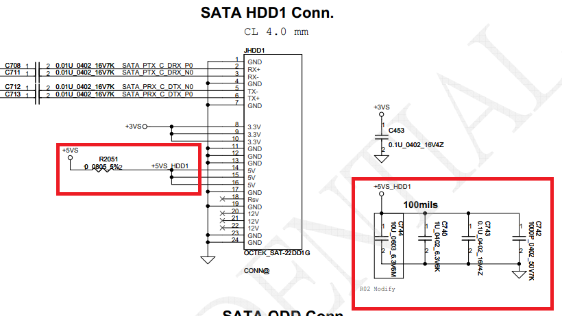

    After some searching I read that running some power through B+ should heat up the faulty component, so I did this and found the marked capacitor gets hot.
    I cannot locate this component on the circuit diagram to find its value and replace - can anyone help?
    It appears the bottom of the cap goes around to the other side of the board to 0v, the top goes to a ferrite bead (I think that's what it is) and then on to +5V for the HDD.
    I cant see any ferrite bead marked on the circuit diagram for this area. My board is marked as Rev 1.0 and the circuit diagram rev 2 if it makes a difference.
    Can anyone please help identify this overheating component?

      Re: Acer aspire v3-531 dead, b+ short?
      if u remove that capacitor, light goes up ?
      check also after removing voltage on both pins
