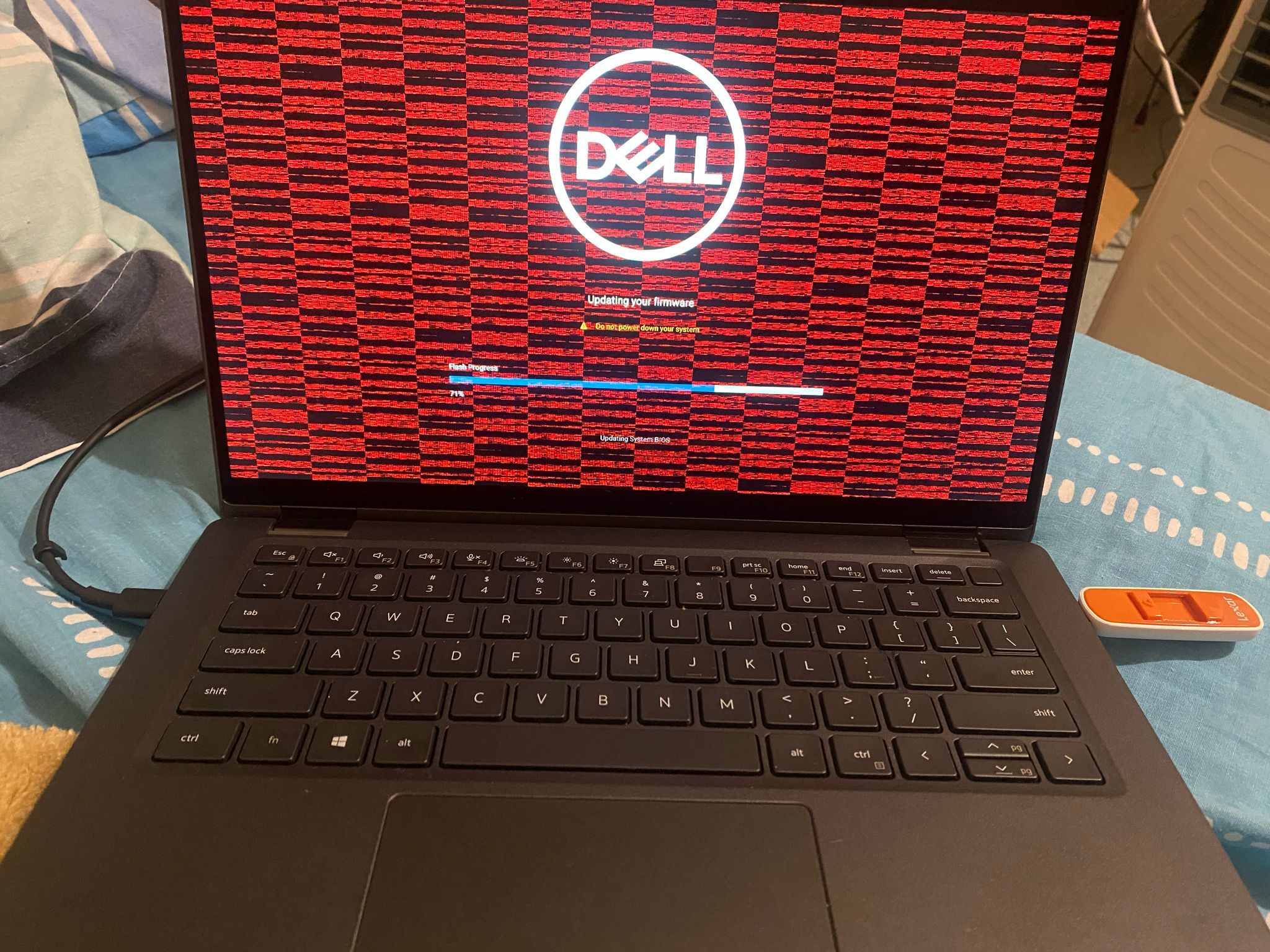

    I was trying to install windows on this laptop and it just stops in middle and the screen looks like this. I thought it could be an BIOS issues so i tried installing updated BIOS on it but every time it just goes like this.
    I don't know what are the options i have to fix this.

    Looks to me like a bad GPU core — could be faulty RAM, but the GPU core is more likely.
    If the system has a dedicated GPU, try running MODs/MATs, or Tserver/dmgg.py.
    • If a bad RAM chip is detected, replace it.
    • If the issue persists after replacement, you may have installed a faulty RAM module, soldered it improperly, or the GPU core itself is bad.
    • If no bad RAM is found at all, then the GPU core is faulty.
    If there's a dedicated GPU, you can disable it as a workaround.
    If there's no dedicated GPU (i.e., it's integrated), then unfortunately, the only solution is to replace the CPU/integrated - chipset and GPU.
    You could also try heating the GPU to around 180°C to see if it temporarily resolves the issue.
    If it does, then the GPU is definitely faulty — but it might work again for a short time.
    The fix could last just a few minutes, hours, days, or even years — you never know.

      I have a problem very similar to this but my screen is blue instead of red, you can barely see anything past all the destoryed graphics. It could boot to bios but if I didn't, it would just do the screen I described.
