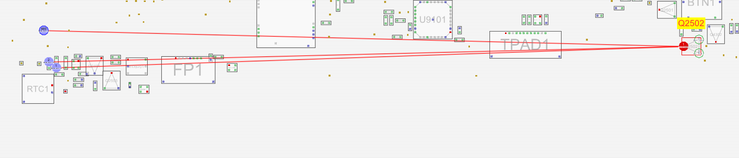

    Hello
    This device came in with a strange problem,
    The laptop starts by resetting the time and date settings every time it is turned on, as if the RTC battery was removed.
    RTC battery is brand new, 3V is present at Q2502
    No liquid damage or corrosion, board is clean
    Same on AC or battery
    schematic and boardview can be found here
    https://www.badcaps.net/forum/troubl...nd-boardviewer
    Any help will be appreciated
    Click image for larger version  Name:	resim.png Views:	0 Size:	55.5 KB ID:	3602212
    Click image for larger version  Name:	resim.png Views:	0 Size:	80.1 KB ID:	3602213

    What about the GATE behaviour of Q2502?
    And I think it's a good start to measure the current at the battery connector, if there the battery really gets drained. Or maybe the problem is something else. The battery voltage is good as low as 2 Volts.

      RTCRST#/SRTCRST# present with no power attached,only cmos cell connected.
