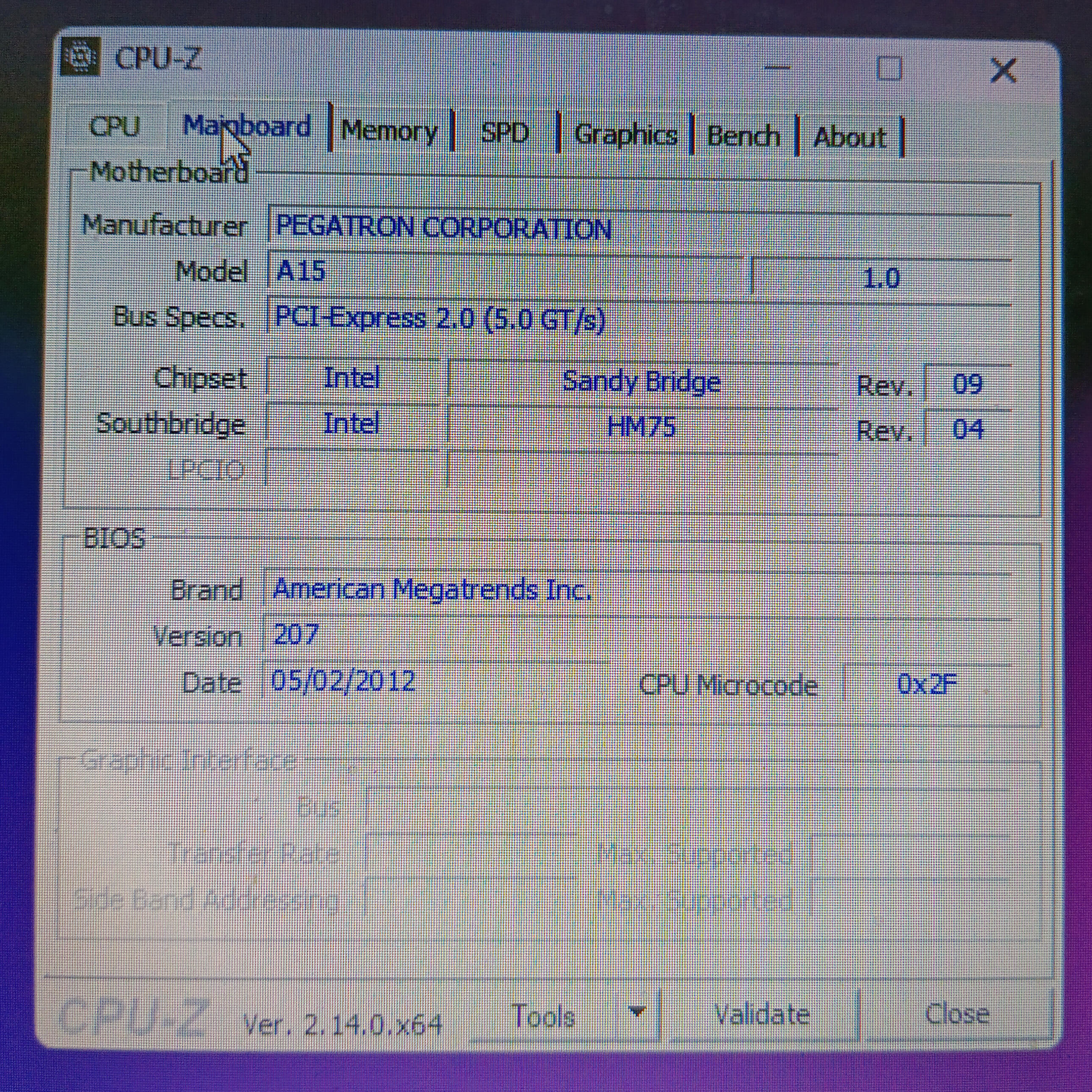

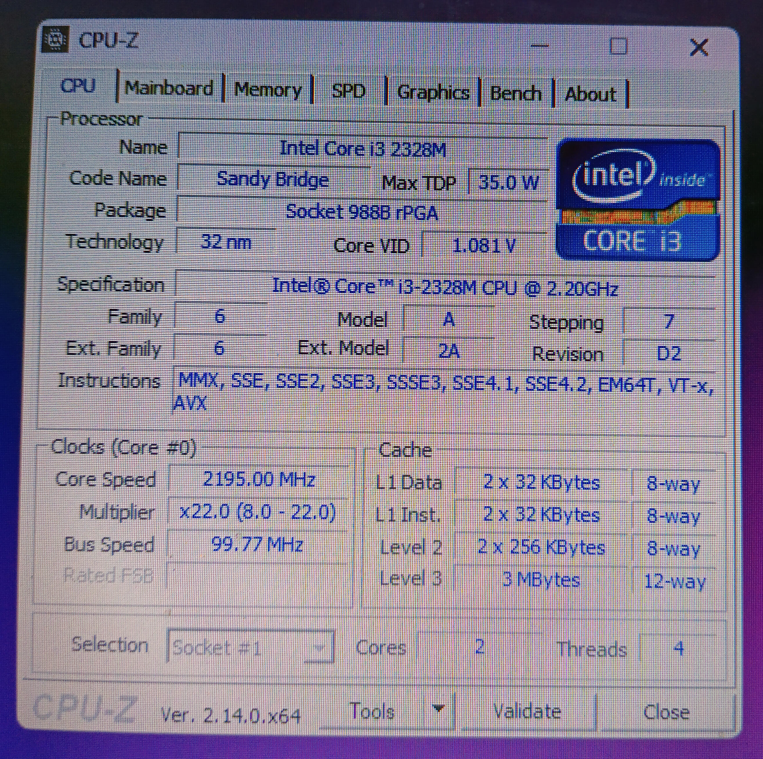

    I have an old laptop the brand is "Turbo X", model A15YA Ver1.0, BIOS ver. 207, CPU: i3-2328m
    Can I use a 4-cores CPU?
    Which do you think is the best possible CPU upgrade option for this laptop??

    Supported CPU list .
    https://www.cpu-upgrade.com/mb-Intel...5_Express.html

      CPUz chipset: HM75 not HM65 as at your link.
      Will the BIOS support these CPUs?
      • tomodachi
        • Apr 2012
        • 610
        • Turkey
        if your chipset is HM75 yes, it will also support these CPUs
