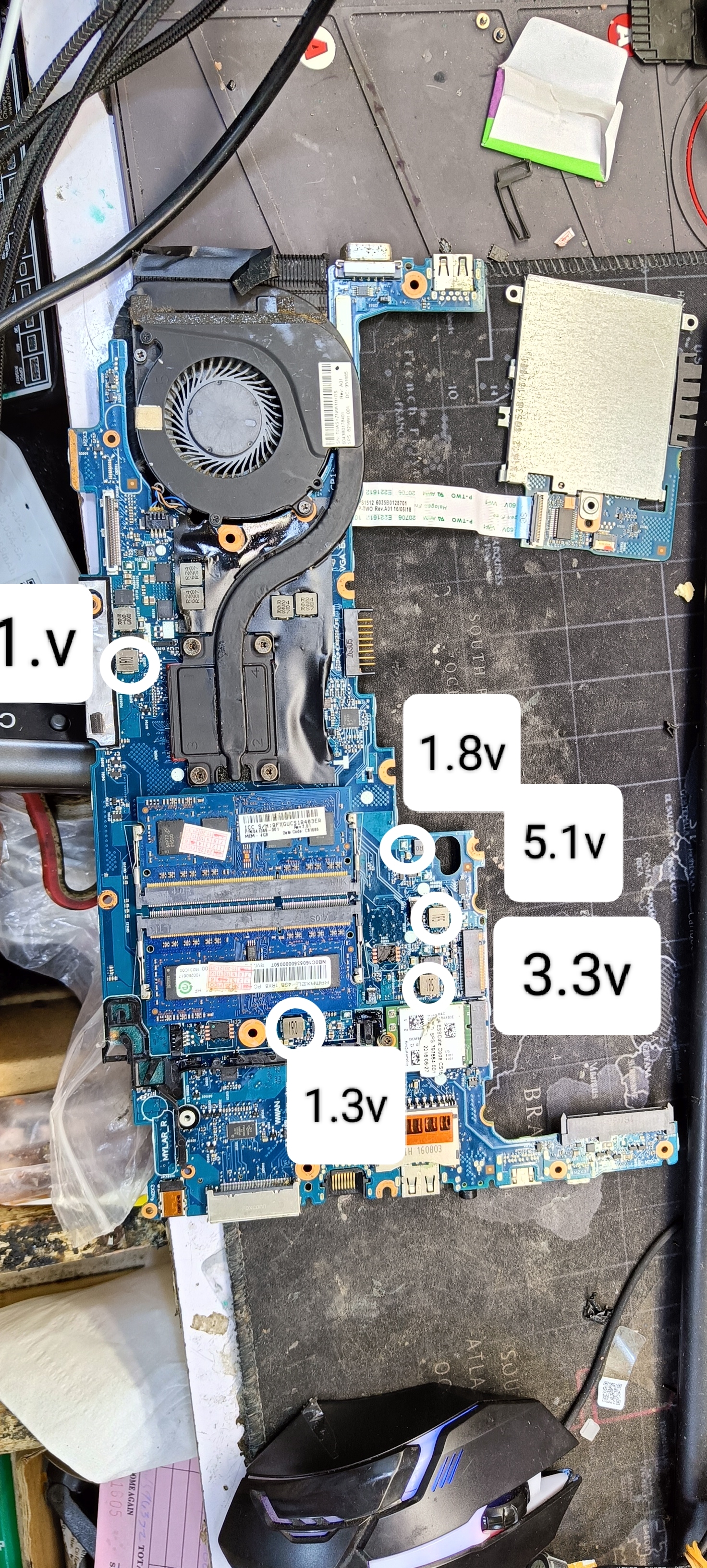

    good day to all pls help me with this laptop HP EliteBook 725 G3
    ​with motherboard model LADY LUCK - 6050A2725101-MB-A02
    All Volts is present 19v,12v,3.3v,5.1v,1.8v,1.0,1.3 but it does not power up
    when i plug charger with battery showing charging light which is white but when i turn on nothing happens
    i already flash bios 16mb,8mb same issue pls help

    Check LIDSW# and powerbutton voltage.
