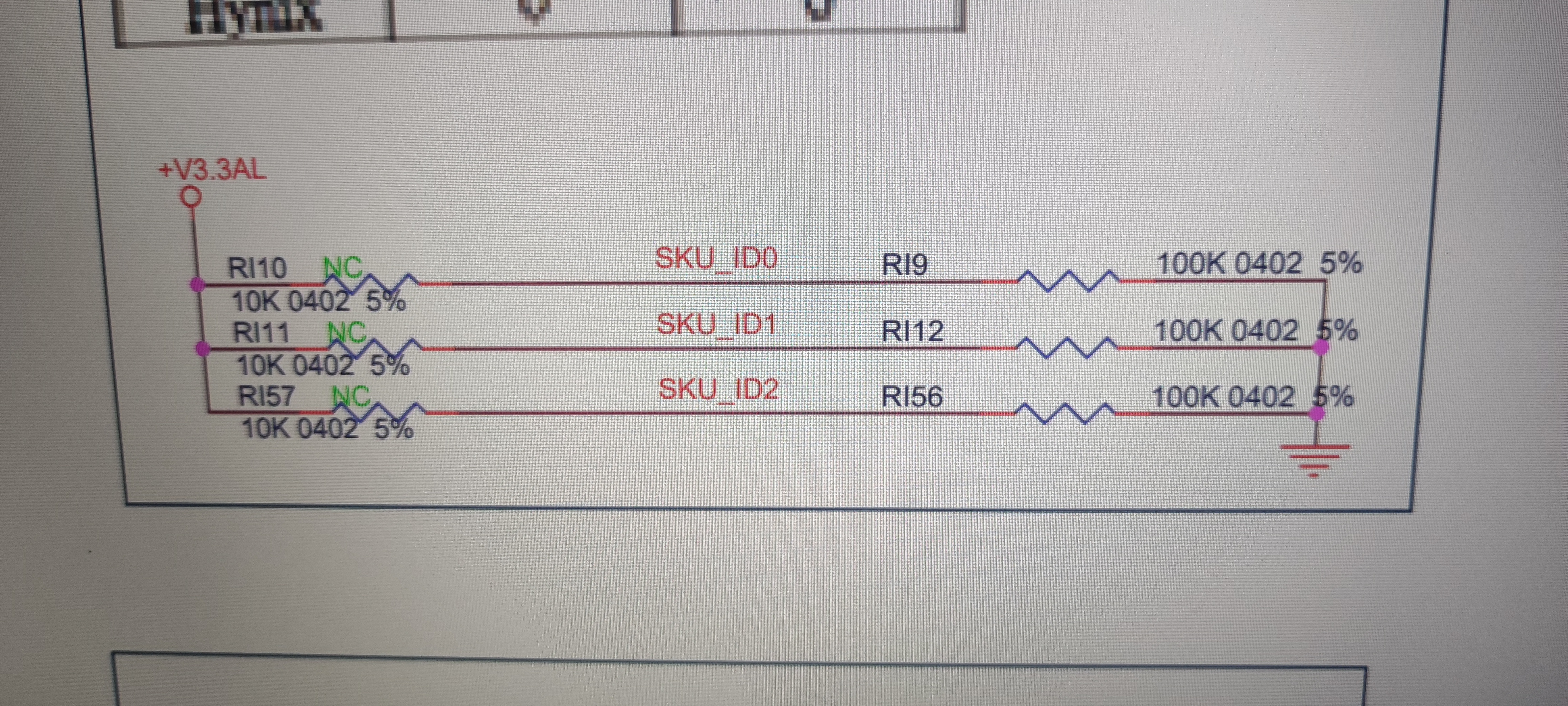

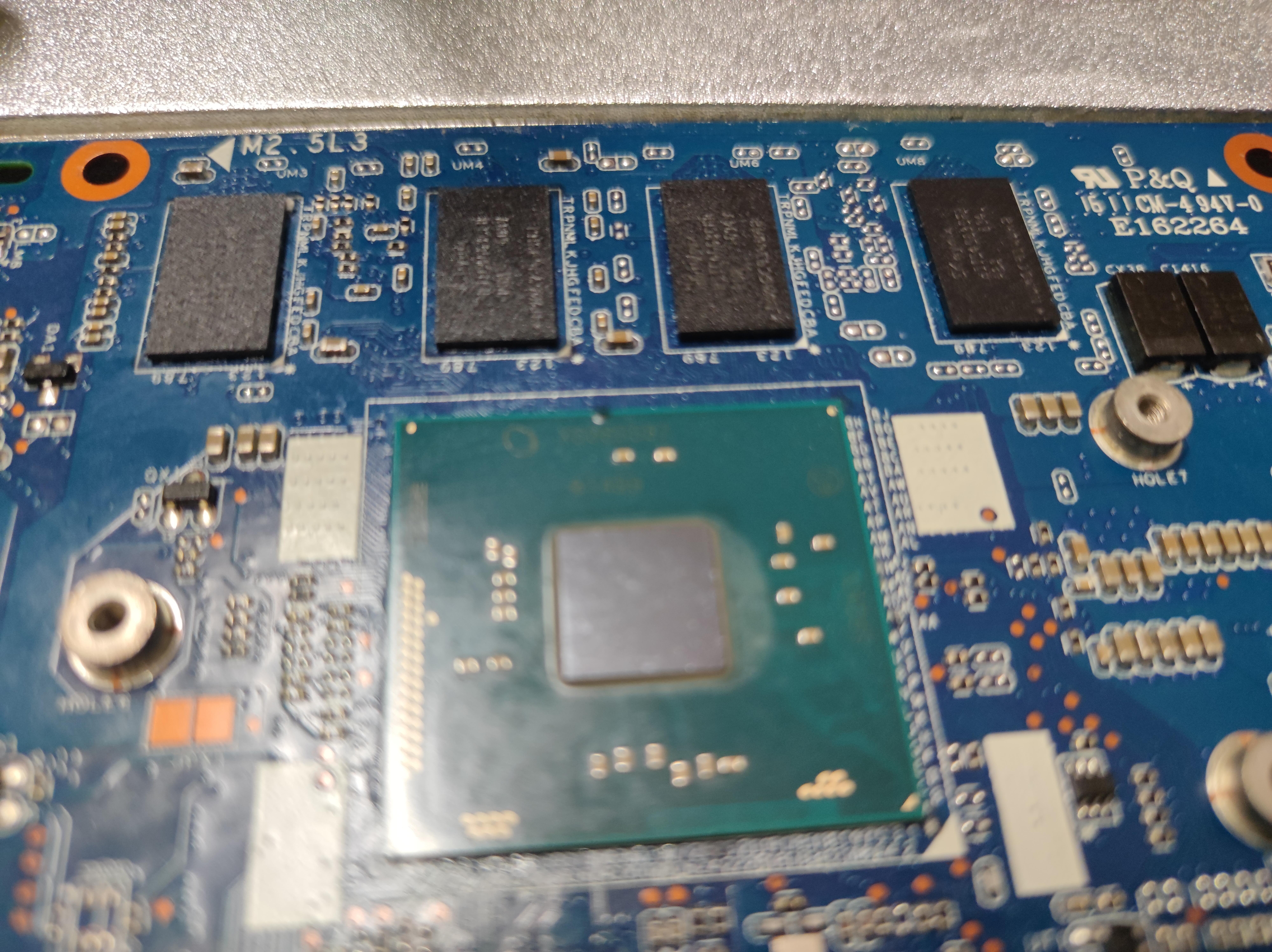

    Good morning, for fun and learning I am trying to expand the RAM in the Lenovo IdeaPad 100s 14ibr laptop motherboard
    1001B_01_01 rev:SOVP2 I have already soldered 4 bones and completed the small parts around them. But the laptop still only sees 2 GB of RAM, I know that I need to remove some resistor, but I don't know where it is located. Here I am asking for help in finding the location on the motherboard. I only found this. I'm a beginner.

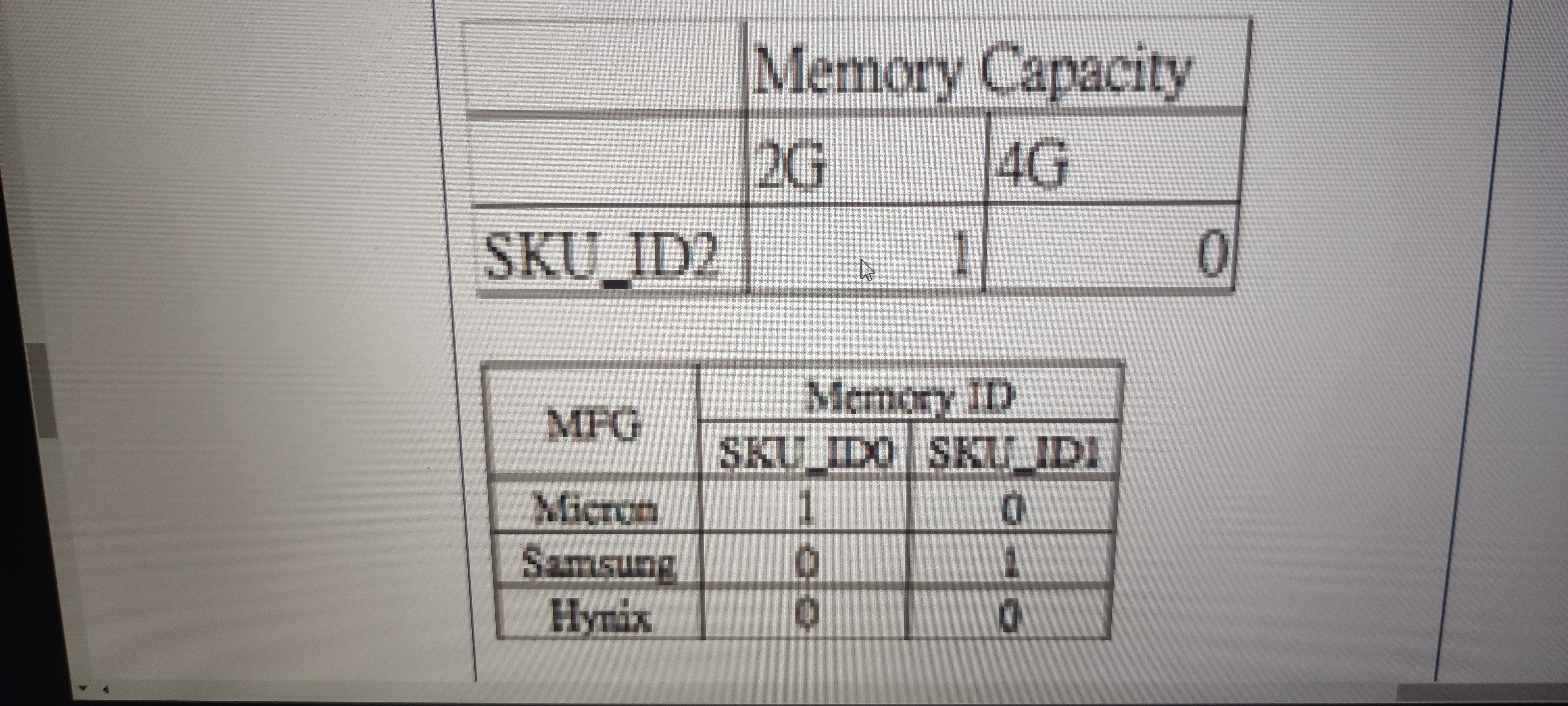

      Only SKU_ID2 resistor needs to be shifted to detect 4gb.

              Ok guys, I think the BIOS has nothing to do with it, this must be related to the jumpers (resistors) which as I see depend on the brand of memory and the quantity, if you soldered the same modules then go to SKU_ID2 and remove the resistor, this would be enough to initialize all the ram
                Please provide the specific location of this resistor on the motherboard. Pointing it out in the photo. I know it needs to be removed.
