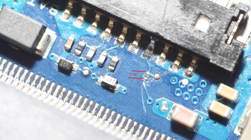

    Hello.
    The laptop does not recognize the battery. A component is missing on the board. Could you please tell me the type and value of the component, or share the schematic?
    Thanks.
    Kind regards.​

    If you can not find anything at all, you can try with a resistor like 1 kOhm.
    Is there any voltage to measure?

      I tried a 1 kOhm resistor right before writing, but it didn't change anything. There is no voltage. Everything was working fine until I accidentally damaged the resistor with a screwdriver while connecting the battery.

        What is the voltage on both pads of this resistor?(resistor unsoldered).
        Resistor is connected to which pin of the dc jack?

          There are 3,3v on the resistor contacts, the charger is connected.

            This resistor seems like for dc jack light indicator and not AD_ID so may not be of concern.
            Laptop turns on with adapter only?/Battery only?/ both adapte+battery?
            The only issue is battery not being recognised?
            Battery was recognised before you repaired it?
            Please clarify

              Laptop turns on with adapter only, not recognize the battery. There is no voltage on the battery contacts (black, red wires). I disconnected the battery for replacement RAM. The level of wear was​ 23% AIDA64. Please tell me what else I can check?

                Hmmm... if there is no boardview or schematics, it's quite difficult to find the correct resistor value.
                a) You can find out, where do the two nets come from, and where do they go to. Then we can consider what is the use of this signal.
                b) You can find out the pin assignments of the battery itself. Probably, there are other laptops which use the same battery. And then can find a schematics and boardview.
                I think it's worth to try from the direction of the battery itself.

                  The 10 kOhm resistor came up.
                  I couldn't find the connection diagram.​
