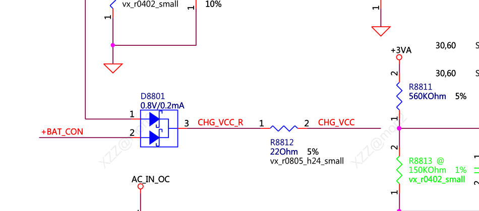

    Remove all power. Meter in DIODE mode. Confirm that the dual diode @ D8801 is not defective.
    Red meter probe on pin #1 (anode); black on pin #3 (cathode) - diode should conduct. Reverse the leads and the diode should block.
    Repeate with pins # 2 & # 3. Same test procedure.

      I checked D8801 and it's perfect. It's conducting one way from #1 and #2 to #3 but not the other way around in diode mode.

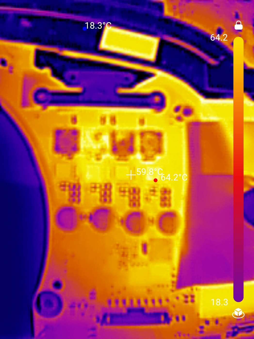

          I'm attaching a thermal camera image of the DRMOS round. I replaced the second one from a donor because I thought that might be faulty but it didn't help. The first coil on the left has no voltage, the rest is strange for some reason.
          If I measure them on the CPU side all three have stable .940V. But if I measure them on the DRMOS side only the 3rd one has stable .940. The second one and the fourth one is fluctuating constantly. The second one is 3.2V, the fourth one is 3.6V. How? All of them should be below 1V, right? What am I missing?

            I removed and replaced the fourth drmos as well. Nothing has changed...
            These laptops will drive me crazy. What else could I check? What else could cause these sudden shutdowns?
