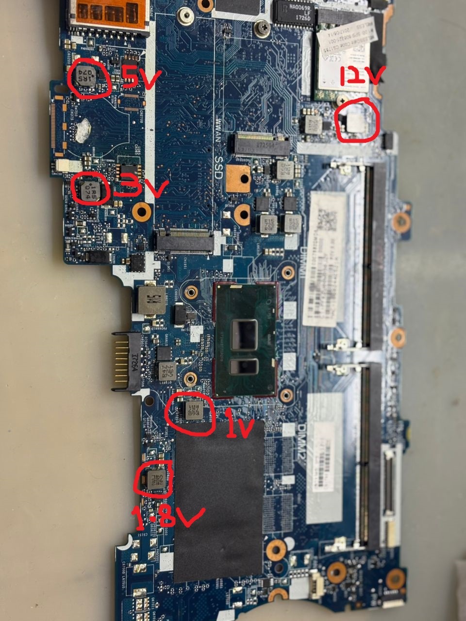

    ampere stuck on 0.03a ....press power button get no response...i already try flash bios main+ec but problem still persist...i have no schematic@boardview for this board...19v/5v/3.3v rail all normal...laptop charging also okay

      yes without battery stuck on 0.03a....with battery read 0.15a...power button okay....without cmos battery also wont turn on

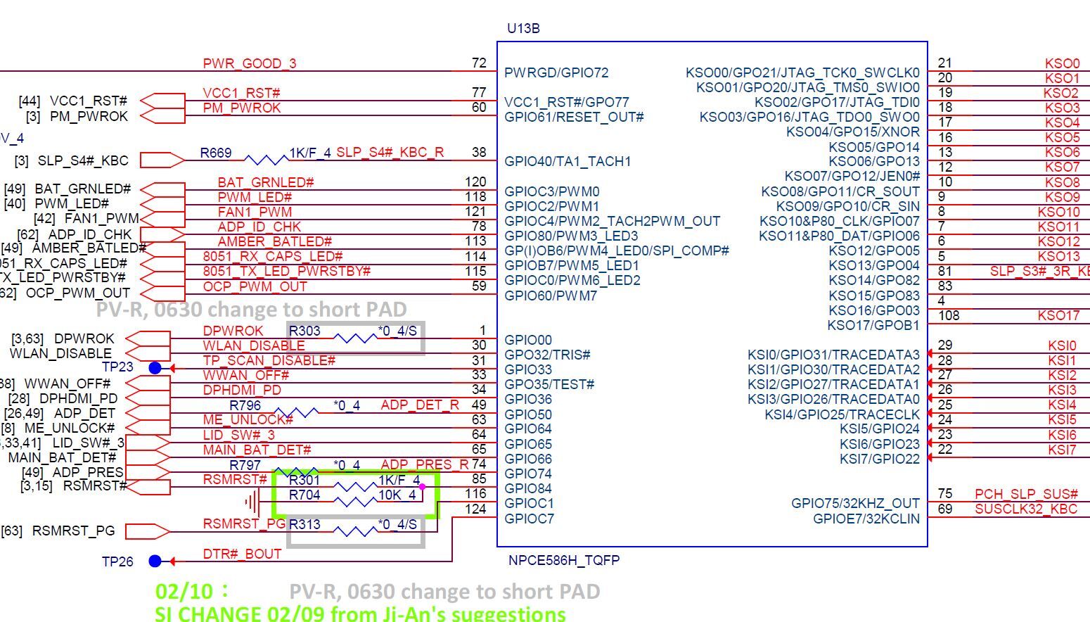

        Since 19V/5V/3.3V is present, look for RSMRST# is present on kbc(may be after power button).
        You can just gran another schematic with same SIO and check its basic requirements.

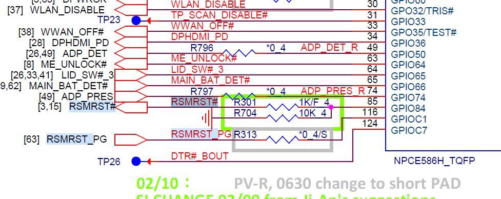

          kbc on this board nuvoton npce586ha0mx ....i found similar kbc on board quanta dax63cmb6c0 rev:c
          RSMRST# pin 85 = 3.3v sir

            Check Crystal for 32.68Hz clock.
